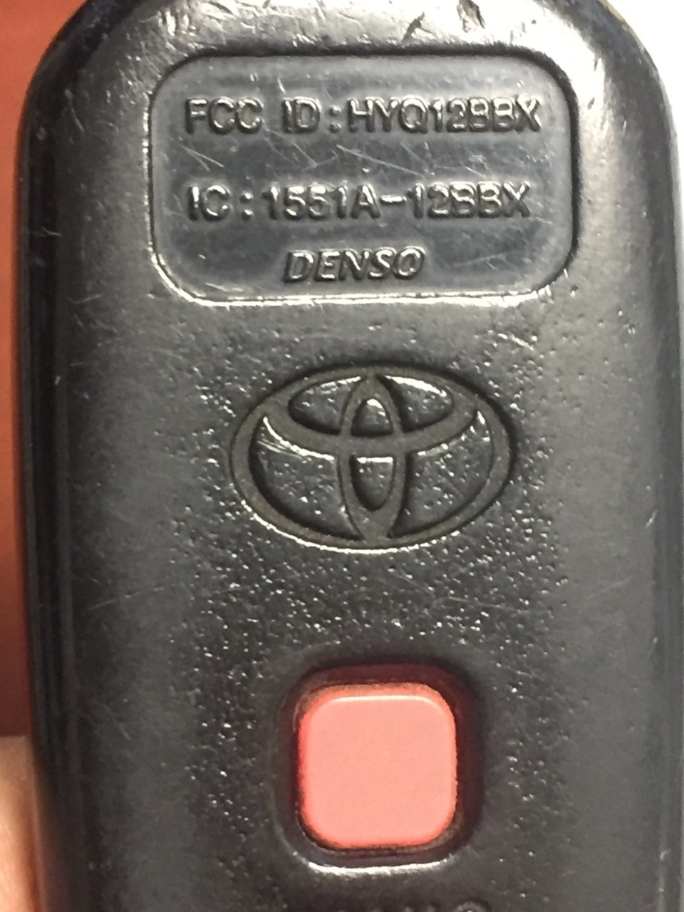

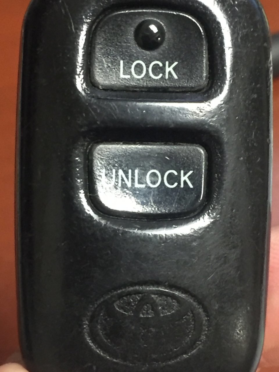

    "Factory alarm"? Are you sure it's a factory alarm and not a dealer-installed item? The latter was common and often caused symptoms like this. The more common one is for trucks from western/southwest US, made by KARR.
    Post a pic of your remote. Just curious.
    All the symptoms sound like what a non-OEM alarm does after 10-15 years. It doesn't sound at all like what an OEM security system does. Especially not on the later model trucks with the RS3200 security system in them.

    I will post pics tomorrow morning of alarm remote..thanks everyone

  12. Apr 1, 2022 at 6:34 AM
    shifty`
    shifty` Bohannon Bohannon Bohannon Bohannon
    Jun 20, 2020
    #48239
    28,858
    ATL
    '06 AC Limited V8/4WD
    Yup, that's factory. Huh. First time for everything, I guess.
    This link will give you the PDF for your security system. I do agree, it sounds as if it would be a security system/alarm that's acting up.
    If it were me, the 1st step I'd take is looking up under the dash on the driver's side to see if someone installed an aftermarket alarm at any point, maybe they did and the brain is still there.
    If there's not another alarm system installed (I still suspect there is), next thing I'd do is pop off the negative battery cable for 30 minutes just to allow things to clear out w/o power. See if it persists.
    If the problem continues after, I'd be going under the dash on the driver's side to find the RS3200 box and popping it out, inspecting it for water damage or otherwise. Note that, if you should have access to another you could swap in, that would be an interesting test but you'd need to program your current fob with it using the instructions.
    If I didn't find anything conclusive at that point, I'd report back here with details on what you found.
