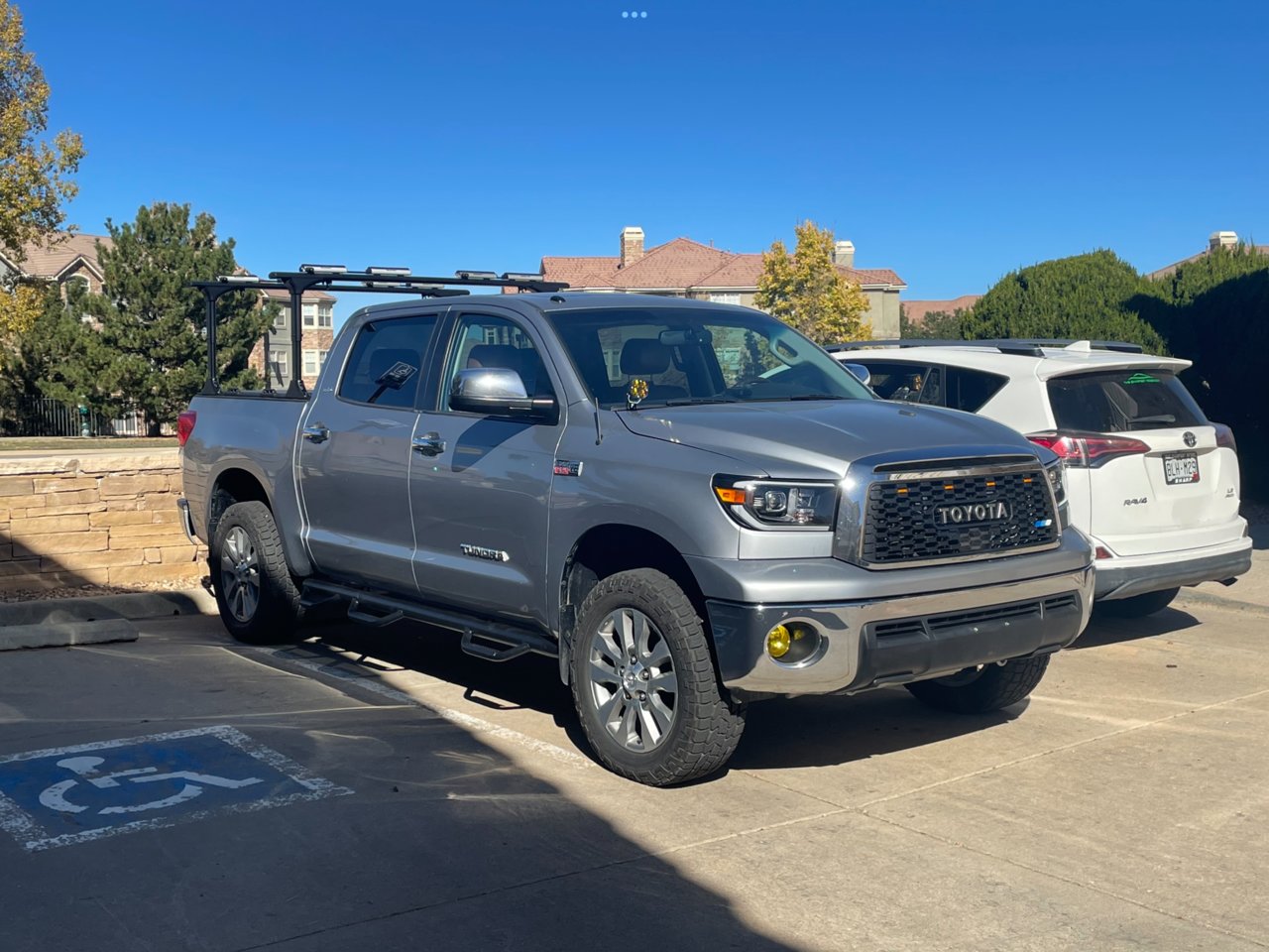

    Hello, Ive got some never ending bed bounce issues that is driving me nuts.
    Ive got a 2010 tundra platinum on 6112/5160’s at 2in lift. Ive added 1 CB shim on each side in the front for 2.5in total front and +2 shackles in the rear (1.25in) to help with bed bounce (based on coachbuilders suggestion). It did not help more than slightly making it feel better.
    Here in Denver, I'm still going down the road like a bobblehead and its literally nauseating and pushing me to sell and buy another vehicle. I’m running LT 33” in tires on stock 20in platinum/limited wheels (pic attached) and I also have TRD swaybars in front and back. Yes, Ive tried everything besides a super $$$ suspension…
    The ride is harsh on these sectioned highways and destroyed roads out here and I honestly don’t enjoy driving the truck because everywhere I go Im oscillating down the road.
    I’m trying to figure out a solution and I want to go up to 3in in the front to level it out if possible but thats secondary to getting a smoother and more enjoyable ride.
    I’m thinking about buying the trd pro fox suspension and doing coachbuilders trd pro kit to get 3in front and keeping the +2 in the rear, etc. i’m open to other suspension options like King, Icon, emu or Fox since they're comparable in price to trd pro shocks and are supposed to be better than trd pro but i dont know what to do. I dont want to sell it but man Im at the end of the rope here.
    Any thoughts on what suspension mods might fix my problem and maintain a 2.5-3in front level?
