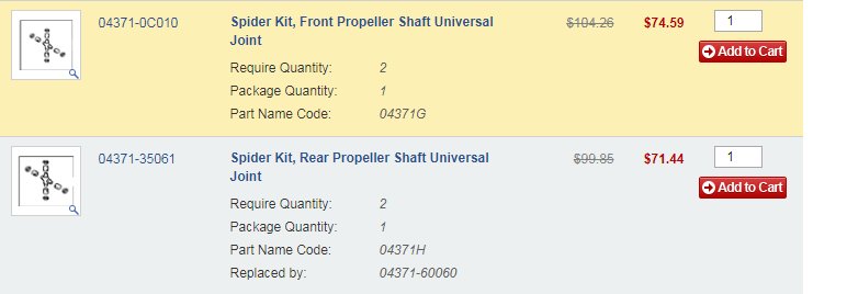

    Finding the right U Joints for these has been a bit tricky. I recently took my truck to a driveline shop and they seemed hesitant to work on the double cardan. I had asked them to replace my U Joints and called me back saying they were fine. In regards to the greasable vs non. Before it was determined mine were ok, they were pushing me to go with non-greasable. They use the Spicer brand. They also claim the "oem" U Joints are actually made by Spicer. Apparently you want greasable if you go offroad which seems backwards to me. Why would I want dirt/debris getting caught in the grease? But this is the advice I have heard and I trust the people on this forum.
    Below are the OEM part #'s for my truck which is a 2002. I you go on this website and enter your VIN it should point you in the right direction.
    https://www.toyotapartsdeal.com/
