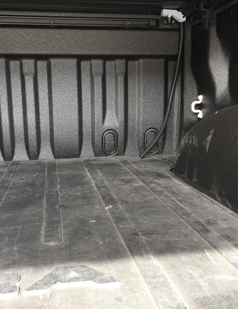

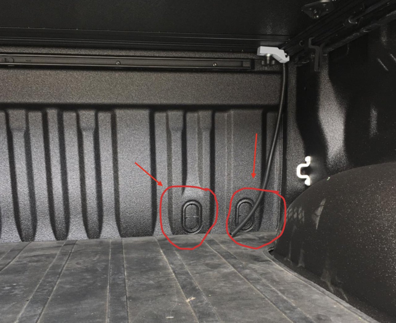

    As you can see in the picture, the little area where you'd run drainage tubes has been line-x'd. What's the best way for me to run drainage tubes in to those little slots?
    Drill holes, cut out the line-x with a razor, something else?

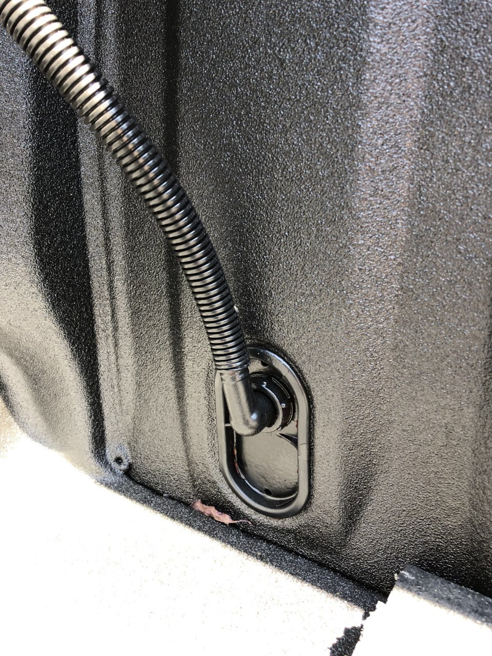

    20200408_175250.jpg On mine, I tried to drill through the oval bed plugs. The liner (applied by Toyota, I assume at port by GST) pulled off of the plastic as soon as the bit took hold. I then just peeled it off the rest of the plastic plug and cleaned up the hole I drilled. Be careful not to go through and hit the back of the cab with the drill bit.

    I just popped the plastic plugs out of the bed, and used a big enough drill bit to fit the drain tube through....the line x did come off the plastic, but being black to begin with it's really not that noticeable.

    There are two locations you can drain from (see edited picture). The problem is those are now covered in line-x. If the truck bed hadn't been sprayed, those are just little plastic pieces that can easily be removed for drainage tubes.
    So my options (as I see them) are to drill a hole and run the tubes through the hole or to use a razor blade and try to cut out the inserts. Anyone have any experience doing this?

    This is where the drainage holes are.

    I updated my post with a pic, I think your last 2 posts were in before my update. Hope the visual helps.

    Use a "step Drill" that way you can get the desired size hole and not hit the cab

    I used a piece of scrap wood and an assistant to hold it in place to protect mine.

    It’s just a rubber coating on a piece of rubber. Not solid whatsoever. Step drill through it.

    This. The linex will peel off. They're just rubber/plastic inserts. Can buy new ones cheap if you need to.

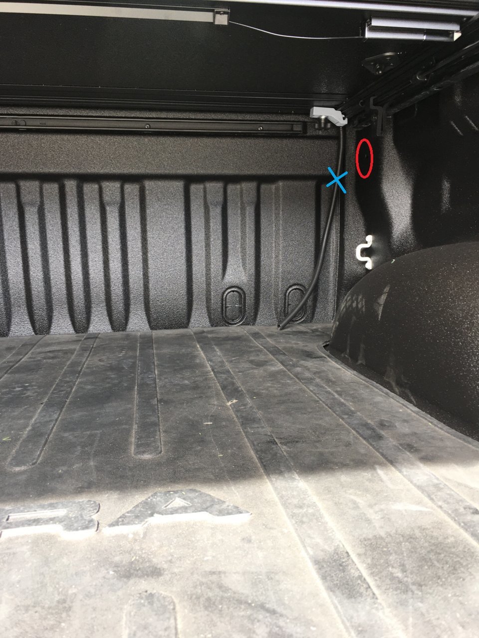

    There is a hole on the bedside just to the right of your picture up high. I used a piece of red tubing that came with a harbor freight transfer pump and put it through there. Saw idea online somewhere and it works so far. I have an mx4 bakflip.

    Why not just run the tube through the already existing hole above your bed cleat, right below the clamp nearest the top of the hose? This is what I did, keeps the hose short and dont have to worry about snagging it on something if you put something in the corner there.

    No pic of my truck because I rode my bike to work, but I circled the hole I'm talking about and the blue x is where you can cut the excess tubing.

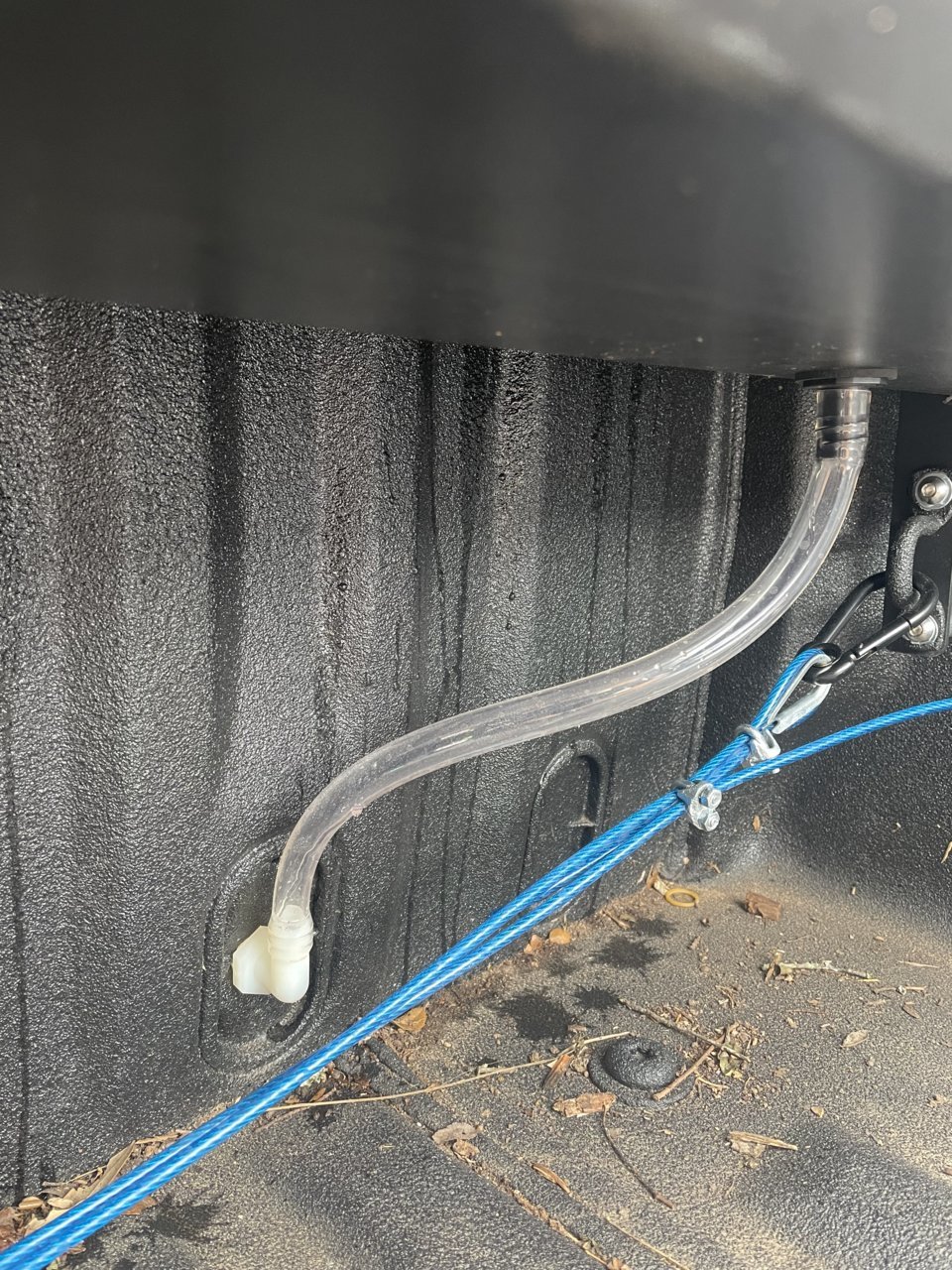

    I bought two new plugs so I would have fresh ones if I pulled the TC off for some reason.
    Drilled holes in the originals. I used risers from sprinkler heads and grey PVC nuts from the electrical department. There is one inside and one outside of the plug. Had to dremel the the hole on the inside one to get it around the bend.
    I spray painted everything with rattle can bed liner spray over primer. Like mentioned above, it fell off the plug when I reinstalled.
    Edit: You can see little bits of the paint left on the plug (I hadn't noticed until now). Also, I would expect you can cut around the edge of the plug and pop it out with a screwdriver... mine came from the port with no bedliner on the plugs.

    I chose the route I did instead of those holes as I would have to drill them out to fit the tube. Also I am not sure how the finish is 'inside' the bed and didn't want to dump water in there all winter long. Someone that has gone that route could probably educate both of us on this.

    I used them without drilling. Just pinch the end of the hose a bit to get the diameter down,and stick it in there, if its the ribbed hose like mine, it should go in no problem. I have 0 issues, water goes right outside. I tested it with a bottle of water. Save yourself the trouble and having a way longer hose that might get pinched if you put stuff down there.
