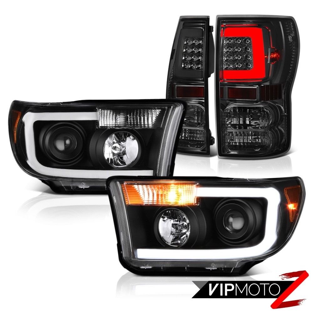

    First off I've read a ton of threads and still not sure of the correct answer. I'm looking for the spyder style headlight with the white drl lights similar to this pic but I want to run my aftermarket HID kits. Does anyone make this in a non-projector style housing?

    They’re all projectors, believe this style headlight all comes from the same factory. Doesn’t matter what brand has their name on them, just find the cheapest ones. They’re h1 projectors so you’d just need a h1 hid kit but be prepared to swap to a better projector someday. The ones that come in these housings are extremely cheap and won’t last with the heat of an hid.

    Well that's not worth the time then. Thanks for the input. I will go another direction.

    You would be way better off installing your or any HID kit in these projectors than in halogen reflector bowls.
