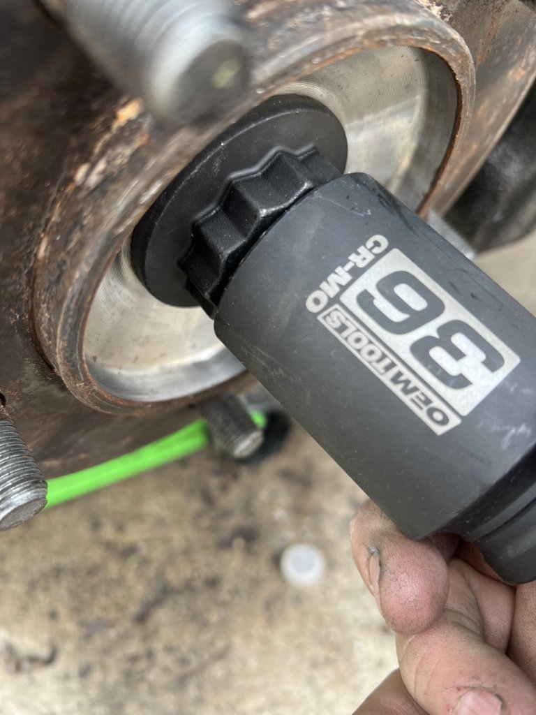

  22. Mar 18, 2025 at 10:13 AM
    FREEK
    FREEK New Member
    Jan 3, 2019
    #23916
    95
    Darren
    Olathe, KS
    2019 Tundra Limited Crewmax 4X4
    I just bought the 36mm 12pt O’Reilly socket…. too small said Goldilocks.
    Seems like a 38mm 12pt would fit. Gotta double check before returning to parts store!
