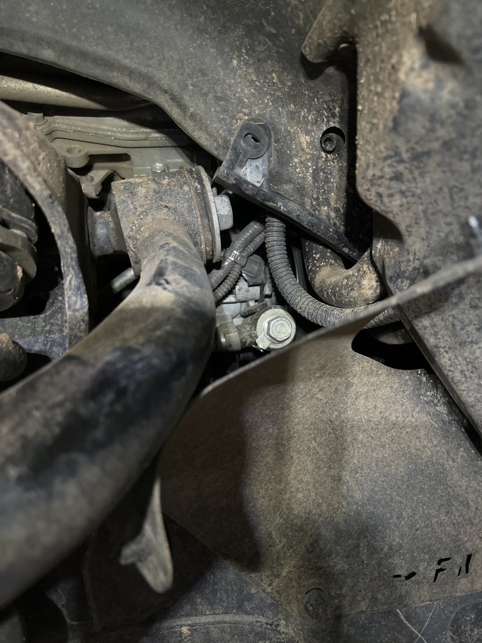

    I am up grading my suspension my self. The driver side was tricky with the UCA bolt the passenger side looks even harder near impossible any video or help would be greatly appreciated

    2 or 2.5 gen? It just looks hard. Not terrible really. Just move the BS out of the way and slide that bolt forward all the way.

    2021 SR5 here is a photo

    The tube and wire harness doesn’t really move

    I also have a 21, no problem switching to SPC UCA's, just moved the hoses or wires out of the way and that's it.

    I tried YouTube and for 2.5 gen is only driver side that I found

    There is a way to unclip it

    Okay cool so how hard do I need to push move those to get the bolt out?

    Iirc, you just open the clips and the BS will move out of the way, not much maybe like 1.5", it's been over a year, but it wasn't bad at all.

    If you are in the front of the truck, the clip is just to the right and a bit toward the front from the bolt head, simply open it up with a pick and it will be able to reclose or snap closed after you are done.

    Once you unclamp them you can move them enough.

    So got it all done passenger side was way harder than driver side lol. But completed! Only prob the driver side ball joint has a hole or rear in the rubber and won’t hold grease. Warranty claim
