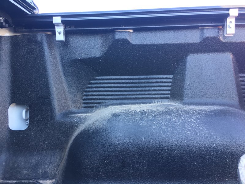

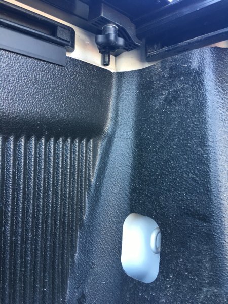

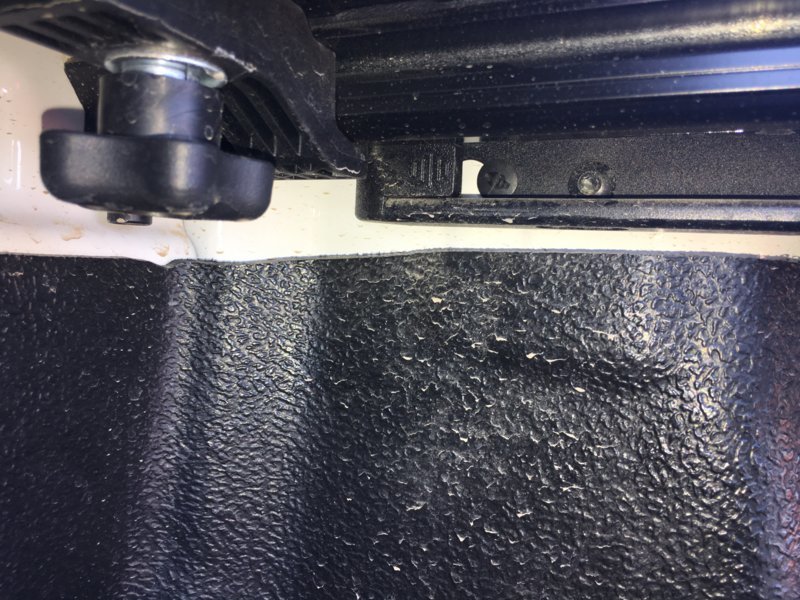

    IMG_0949.jpg IMG_0953.jpg IMG_0956.jpg IMG_0949.jpg IMG_0953.jpg CM. Pics are sucking. However. With the tape up against the metal of cab. 1st hole is at 5 1/4, 2nd 18", 3rd 30 3/4, 4th 43 3/4, 5th 57". On mine, the front holes of side rails are exposed. The drop in liner of yours might be trimmed different. IMG_0949.jpg
    If you're doing the front rail those should be exposed.
    If yours is tucked under the bed rails you may want to pop them up to pull the liner out a little to locate them. I'm not sure how those pop off though.
    Hope this helped some.

    Thanks much guys and especially you Bprose. I will use those measurements and am thinking of using a small holesaw so I have some room for error. Appreciate the pics and your time. That's another thing that makes this forum the bomb ! :thumbsup:
