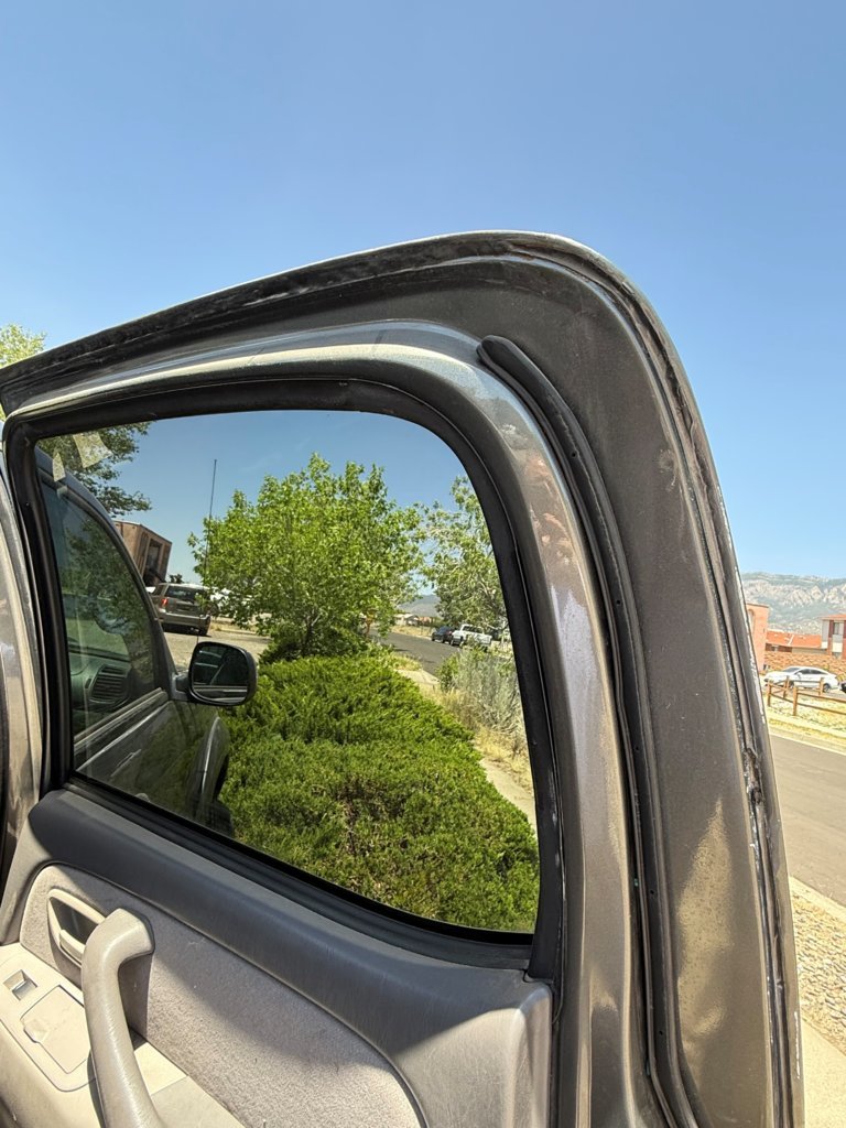

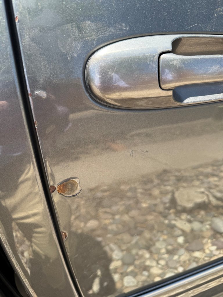

    The door project begins. I am referring to the rear passenger door. Six months after I purchased the truck in 2004, I managed to scrape the door along a length of rebar that was sticking a couple of feet out of the ground. The insurance company / repair shop elected to just replace the door skin and it has never been right ever since. As I recall, Jack McCarthy went through this same ordeal. So, I've decided to replace the whole door. You guys are going to think I'm nuts, but I think I may buy the shell, new from Toyota, and have the body guy paint it and swap the innards. I suspect this is a fair amount most costly than finding one at the junkyard, but I know I can "trust" the innards of my door. I have the part number as 67003-0C100. Can someone double check me?
    I will obviously also need a new door window belt weatherstrip. If anyone has ever done this kind of work, can you please tell me other parts that I should supply the body guy? I suspect some parts do not "migrate" too well from an old door to a new one. Thanks.
    p.s. Could someone also point me to a thread that discusses what folks do with their door window belt weatherstrip? My original lasted 15 years or so. I purchased replacements direct from Toyota and was disappointed to find the coating only lasted 4 years or so before the sun ate it alive. I had considered going with a "wrap," but an in-the-know buddy said it only lasts around 3-4 years in the NM climate. Seems like paint may be the only way to go for something that lasts?

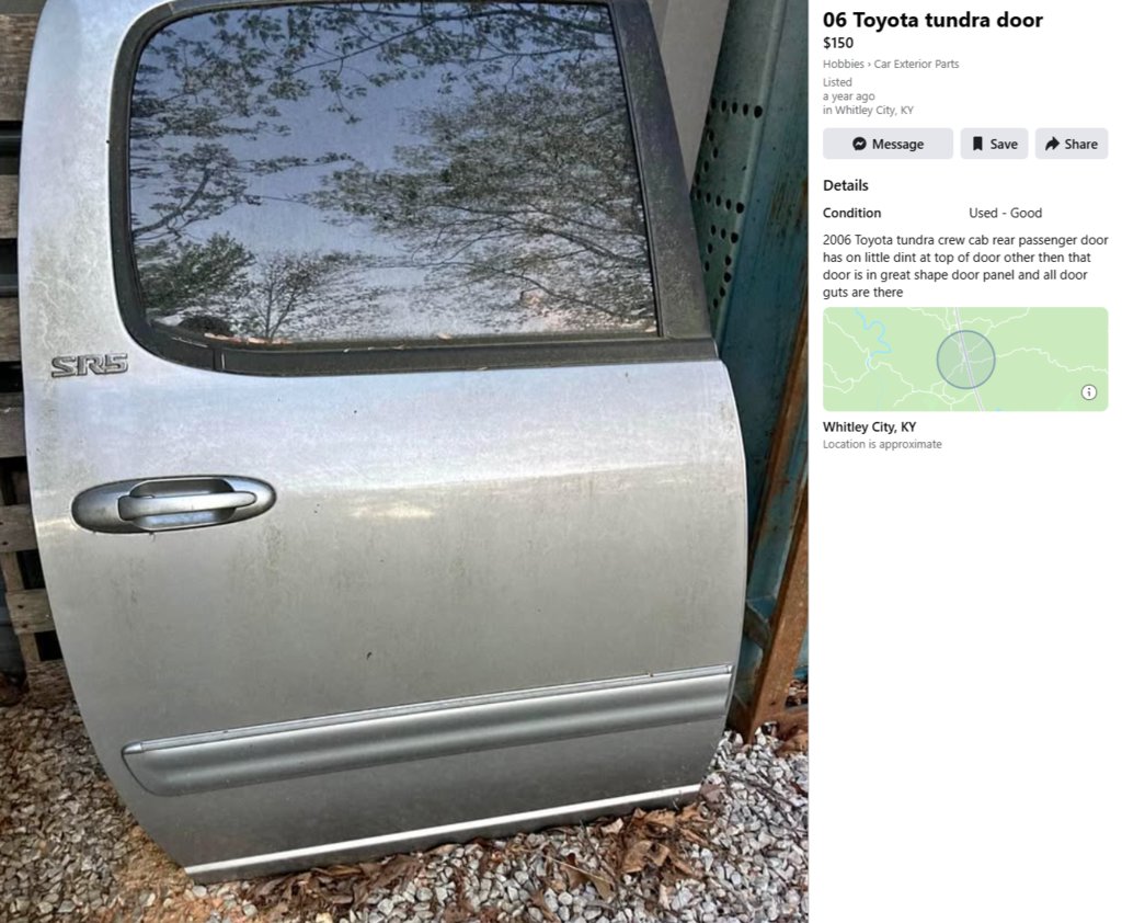

    Too funny, I just saw this door for $150 in KY: Says it was listed a year ago, but who knows... I don't see why you can't just treat the metal (Naval Jelly) to eat away the rust, then prime, and touch that up, though. It's what I'd do. I don't see any major dents or gouges.

    Price is sure tempting. Perhaps I'll have another look. Any thoughts on window belt moulding that the sun doesn't eat up in 3-4 years? Probably doesn't exist. Only way I see around it is paint.

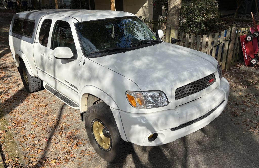

    Reality check, in case you need it: You own a 21 year old truck. They all have damage, the important part is, you're not leaving those spots untreated to rust beyond repair.
    My truck also has damage I've touched up, but you'd need to look really hard to find it. Like this spot on my hood below, above the passenger headlight, where the previous owner's wind deflector took the paint down to bare metal - find any picture of my truck, and see if you can spot it in the pictures, which are taken from 3ft-5ft. It ain't happening, so I'll circle it for you. I did a SHIT job of filling it in, I left a paint bubble, used an old paintmatched tube, didn't prep or sand shit after it dried. Slabbed it on after removing the rust and prepped it for touch-up, dabbled on three coats.

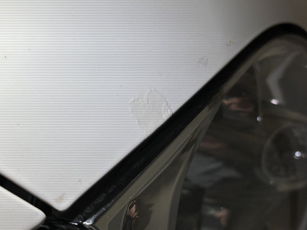

    Beyond this pic, and the head-on, here's another touch-up I did, where my previous owner let the metal rust all to fuck, AND there's a dent in that spot!: https://tnstatic.net/attachments/upload_2020-7-14_23-22-21-jpg.455731/
    Both of those pics are from 3ft away.
    tl;dr - don't throw away your money, or if you really can't handle it, then wait for a $150-200 door in the same year+color to pop up so you can swap it over.
    From 3ft away, note the red circle:

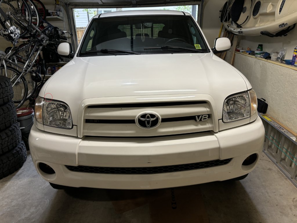

    Out in the real-world, from 5ft away, can you find it?

    My apology. I was unclear. I was referring to stripping the polymer coating off of the belt moulding and painting it.
    I agree with you on the door. It's not just the rusty spots on my existing door, but the fit has never been right since it was repaired. The belt moulding doesn't "seat" properly (sticks up out of the channel) and the door has always looked misaligned. This aspect bothers me a lot more than the paint spots. Shit repair job on the skin imo...I'm probably a little soft about it since I am the original owner. I'll keep at with the junkyards out here for a while. It is the most reasonable option. Unfortunately, despite the plethora of land, the quantity and quality of our yards seems limited compared to larger metro areas and shipping not an option. Plenty of tumbleweeds and snakes, limited choice of aged Tundra doors .
