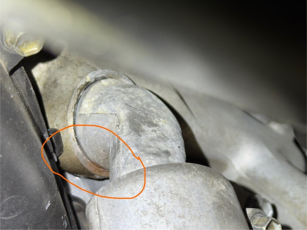

    Speaking about coolant leak, here it is
    To me it looks like the O ring wasn't seated fully
