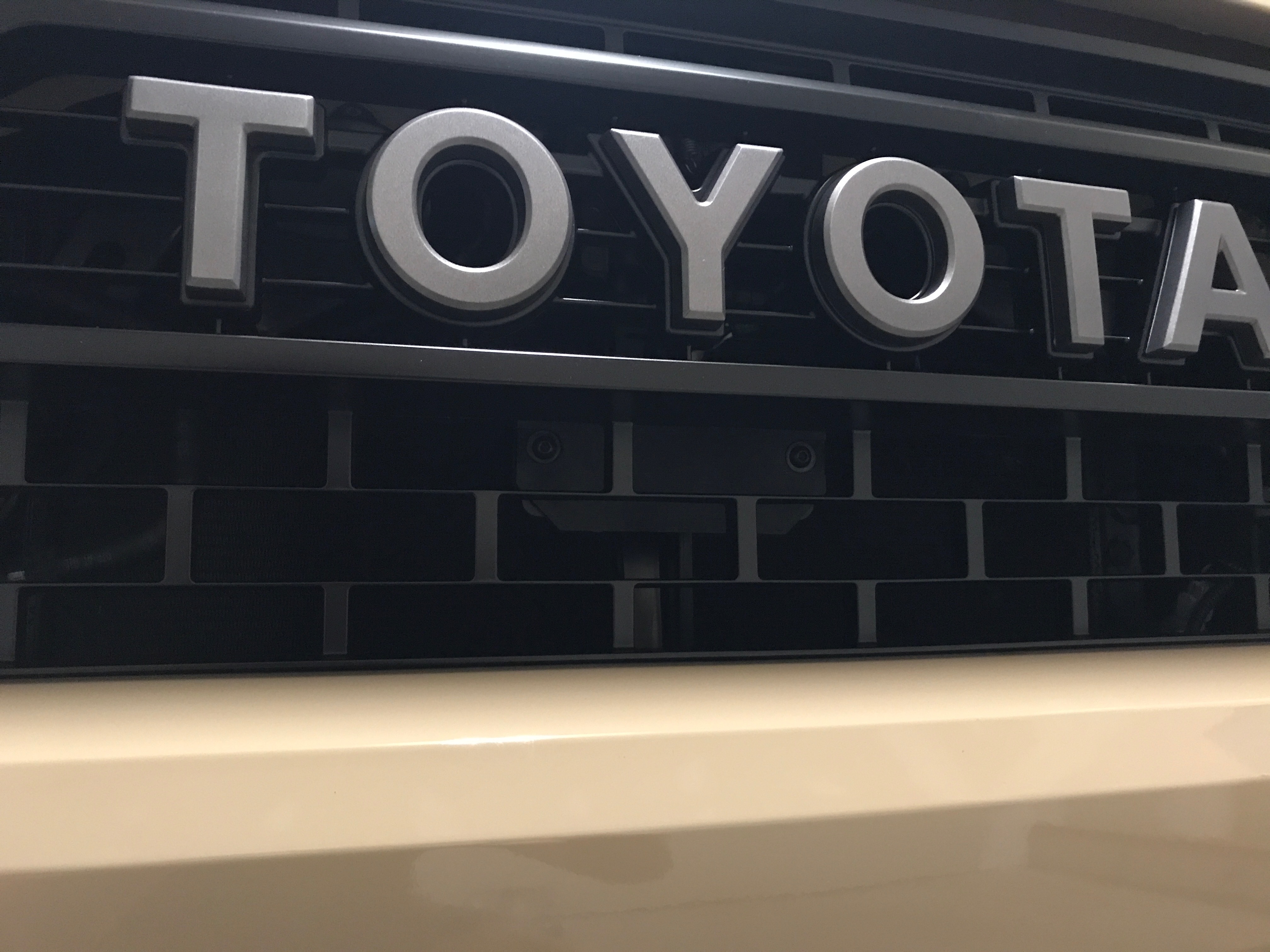

    210A4E73-BFA1-40A2-A7F6-F49E97EC7E68.jpg You can get the 2014-17 pro grill and it doesn’t require a garnish....it does require the sensor relocation bracket.
    I had the ajt relocation bracket and it caused periodic sensor malfunctions. I switched to the Jomax relocation bracket and haven’t had a problem since
