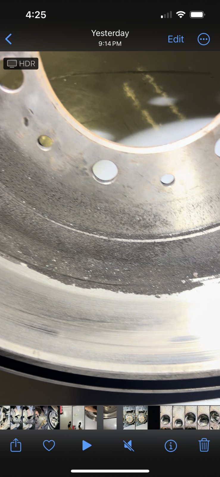

    My ‘03 AC was making alot of droning noise from the front end (no brake shimmy), So I had my front wheel bearings replaced at a local shop. While they were taking apart the hubs I had them replace rotors,pads. Also asked them to rotate tires and replace rear drums and pads
    When it was time to pick up my truck the owner informed me there was a brake shimmy and activation of my ABS system but he believed it to be from the old calipers that weren’t replaced with the other parts. He advised me to replace the calipers and my issues would go away. Sounded simple enough. I replaced my calipers same day and the problems remained. I returned the truck to his shop and asked home to make it right. He said that all the work performed was double checked and all good.
    shop owner claims there’s nothing else he can do for me and that my issue is probably from my tires or worn lower control arm bushings. But I didn’t have and brake issues before I dropped it off… not sure where to go from he with it. If anyone has had similar issues after wheel bearing replacement please let me know

    It's typical for aftermarket rotors and drums to be warped straight out of the box on these trucks. Why? Hell if I know. It's been a constant complaint. But it'll cause pulsing while braking, right out of the box.

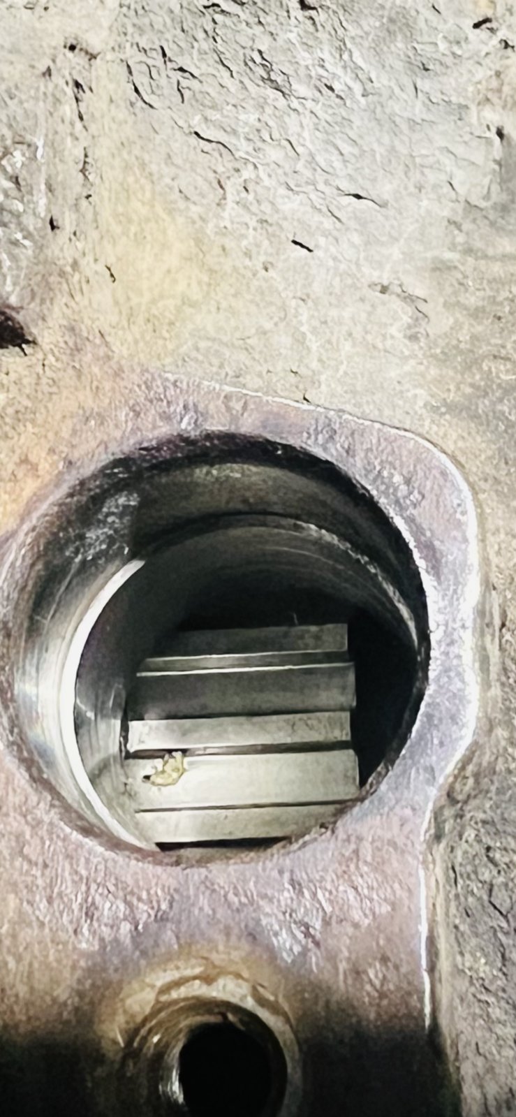

    They replaced wheel bearings. The ABS/wheel speed sensor must be removed to pull the knuckle and press the bearing. I see two possible issues here.
    One.
    Best case. They fucked up and lost and/or didn't reinstall the ABS sensors properly. See this thread. Very easy to check.
    Two.

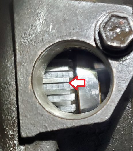

    They don't follow Toyota spec and line up the tone ring right (which happens A LOT it seems) or they don't properly install the ABS/wheel speed sensor square so it's reading the tone ring askew. You'll get false activation of ABS (pulsing) in multiple cases where tone ring and/or ABS sensor isn't aligned as it should be. It'll happen if there's garbage on the sensor also, but if they installed the sensor with shit all over it, that's just bizarre, they should know better. There's a good chance he fucked up royally here and is trying to cop out because he doesn't know what the fuck he's doing. Pull each front ABS sensor, shine a flashlight in the hole, and take a photo. Tone ring should be pretty much centered in the hole IIRC. It should look like it does in this thread, showing a front ABS sensor hole with tone ring nicely square inside (and how clean the sensor should be).
    This is what it looks like in a rear ABS sensor hole, where the bearing was pressed too far, way beyond Toyota spec, so it's too far off-center, too far toward the hub.

    I feel like, in cases where the tone ring wasn't touched, it's probably a matter of over-torquing the ABS sensor, or the o-rings, or not reinstalling the ABS sensor properly (square) in the hole. Or crap buildup / damage to the sensor while it's out during install.
    The function of the ABS system isn't dissimilar from how a bicycle speedo/tach works. Glorified magnetic sensor that counts the metal raised tabs as it spins by. The sensors are expensive as shit, but they rarely fail, and seem to be pretty heavily impacted by random foreign debris (especially metal shavings) making them read off, and not having proper seating so they're not reading the ridges squarely, or I guess the o-rings allowing stuff to get in from what others posted in thread I linked above.

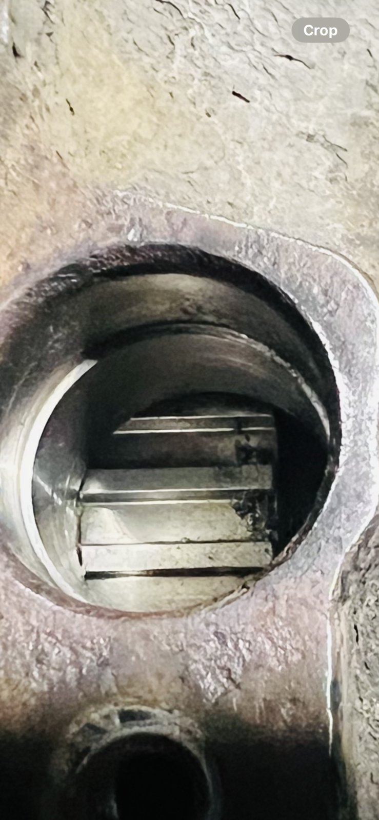

    Crap built up on the tone ring for the win! No more ABS issues after I cleaned all teeth. Now we’ll see if the shop that did the work will make it right.

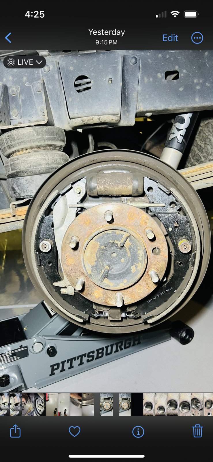

    Also I don’t have a way to spin the drums to see if they are warped. But I removed them to inspect and there was quite a bit of brake dust and some weird wear patterns on the pads. Rear drums have 30 miles since new

    Ding ding ding! Foreign debris for the win. I can't tell if that tone ring is properly square or not, I would expect a little less of a gap, but without looking at my own (which are factory original), I'm not sure. I've expect the ring needs to cover at least 2/3 of the hole rto read, knowing the tip of the ABS sensor is what's reading and it's square in the middle of the hole. I kinda wish we had reference pictures on here for people to use. Might add to the list...
    On the brakes. Brake dust; I'd expect that level knowing you're all new and bedding. The bumps on the shoe reek of jumping to me. And You just said ABS was automagically activating. What happens when ABS activates? BITE BITE BITE BITE BITE. IMO, I'd actually expect to see exactly that.
    I'd hold off and run it for a bit. Set a reminder for yourself for 30 days from now, to come back and update us on whether this solves your issues. If you continue having issues, I'm sure the pads are fine, maybe (A) pull your drums and measure, or take to a store to have them turn or check if they need turning, (B) go with OEM drums (if not currently OEM) and sell cheap or give away your non-OEM (if they are) to help recoup some $$.

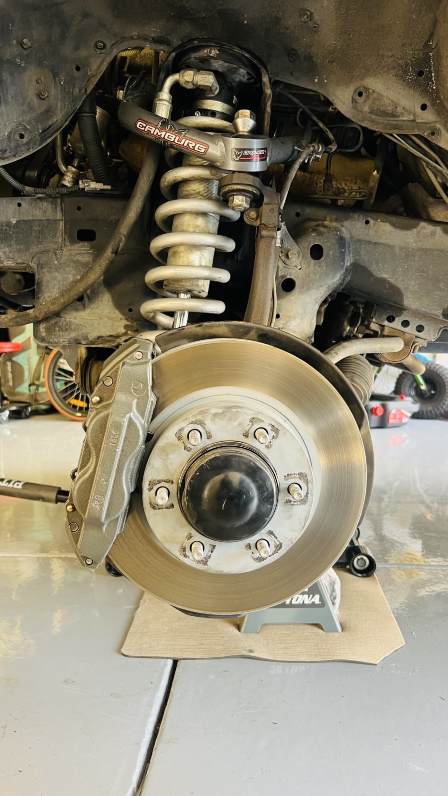

  20. Sep 4, 2024 at 6:19 PM
    PGP03
    PGP03 [OP] New Member
    Feb 20, 2021
    #59376
    34
    2003 Grey Tundra
    So upon further inspection I found LCA bushings completely torn so I replaced LCA all joints steering rack bushings sway arm bushings and outer tie rods. Also found one of the rear wheels bearings completely blown out, couldn’t believe how much play there was! I replaced rear wheel bearings and another fresh set of drums and pads. But unfortunately i still have a brake shimmy… I did the run out on front rotors and hubs everything is very straight. While taking the runout measurement I noticed a slight wobble in the CV axle shafts. At this point I’m running out of money fixing this thing. What are some good options for after market CV axles that will get me down the road until I can save up and by OEM? Thanks
