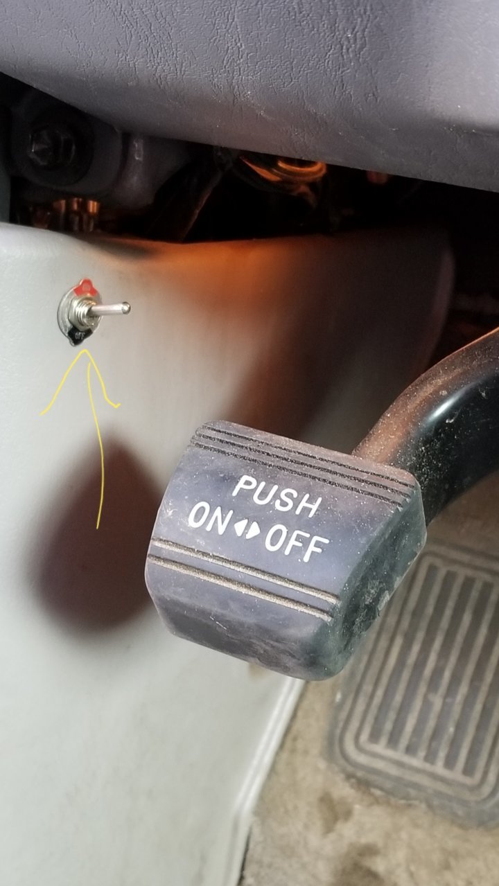

    What is this switch for? It's in the "on" position now

    Do you have an aftermarket remote start installed? I had to 2004 Tacoma that had a switch that look identical for it and it was the kill switch for my remote start.

    Turn it off and see if the truck starts. Maybe part of a alarm system???? Or a service switch for the remote starter if you have one.

    Maybe a hidden kill switch. Try it!

    If answer to both questions above are no, you’ll have to remove that panel it’s attached to and attempt to find what the wires are hooked to given it’s not factory install.
    If it is a kill switch, I personally would find a less conspicuous place.

    In that location, likely aftermarket alarm

    More than likely it's the valet switch for an aftermarket alarm. If you didn't get an alarm fob when you bought the truck, you can take the kick panel off to find the make and model of the alarm and get a new fob connected at a dealer for that brand of alarm.

    +1 on it being an alarm control. Valet switch or the like.

    Seen those installed on vehicles with aftermarket alarm/remote start systems (Viper, Python, Clifford).
    Who knows, you might have a nice alarm system installed. If so just get the remotes and have them programed to the system and save several hundred bucks.

    Is your truck from Canada? Every one I bought at the auction that came out of Canada had those. Never did find out.
