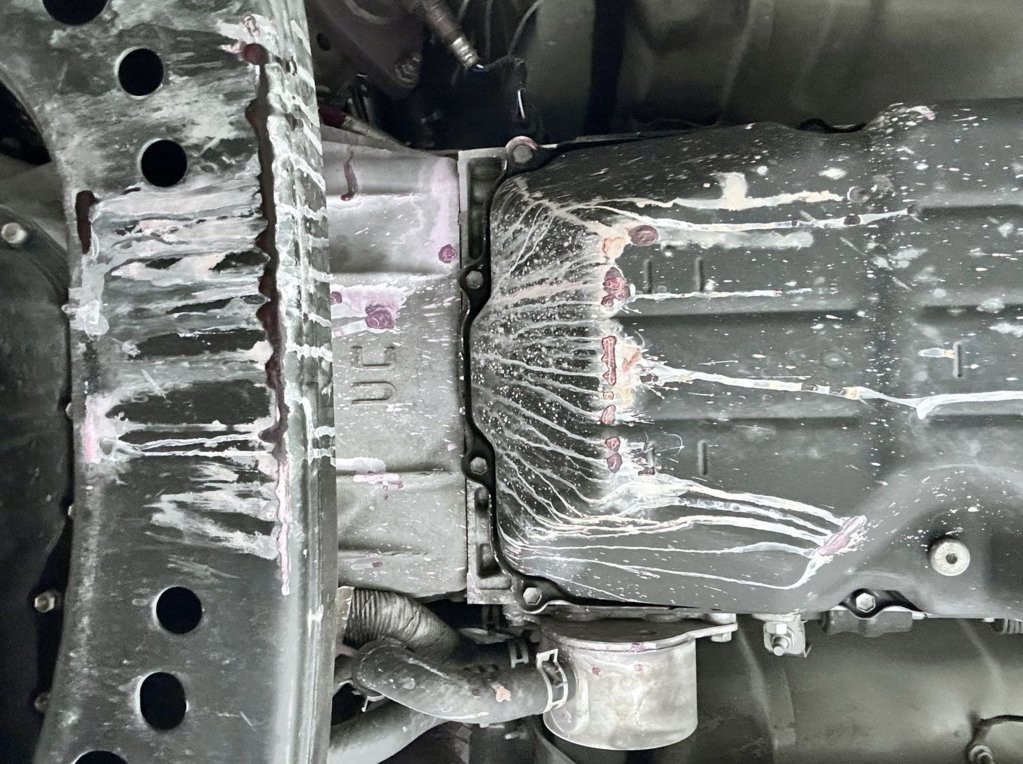

    2016 Tundra 5.7 4x4 Limited 86K miles. No known issues with my engine or trans, runs great as usual.
    Got under my truck today to look around, I was surprised to see a dried (cooked on) pink substance on my transmission??? This pic is taken from under the front of the truck , and its dripping down the drivers side. The black pan you see is my engine oil pan for reference.
    This was not present last year when I was under there installing a CAT protector shield, and wasnt noticed on last oil change. Never noticed any puddles in driveway.
    Nothing is visable when looking down from under the hood,
    By the way its baked on there , It appears it came from the top center of the transmission and flowed down the drivers side.
    Any Ideas on what it can be???????

    That’s coolant. There’s some crossover tubes on the rear of the motor and the heater core back there.

    This is probably the valley cooling plate leaking down the back side from what Ive seen on the forums here. From under the intake but that seems like quite a bit. Maybe check it while running, hot, and coolant system pressured up from underneath the truck and see if dripping somewhere.

    I agree with those above. It's for sure coolant. My guess it's the heat exchanger that sits in the valley under the intake manifold. It seals down with FIPG (RTV) and there are O-rings sealing the tube which connect it. When the exchanger leaks it leaves the considerable pink crusty mess down the back of the engine and it flows down on and around the transmission bellhousing. Not too terrible of a repair to reseal.

    As @Tundra1988 and @Tundra Chief posted it is coming from the valley. You can definitely throw on a new radiator cap but the valley reseal will have to be done.

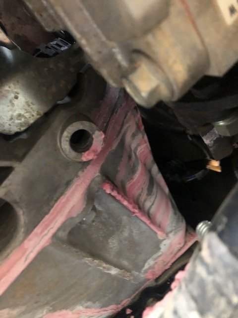

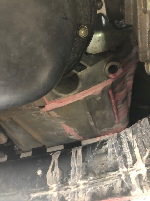

    It is coolant, and it looks like a valley plate leak for sure. It will run you about $1000 at an independent shop.
    This is mine:

    The 2016. It started leaking sometime around 240K or thereabouts. I drove it about 10K before getting it fixed. It looked messy and smelled strongly, but the volume of lost coolant was minor enough I could have let it go forever if not for the smell.
