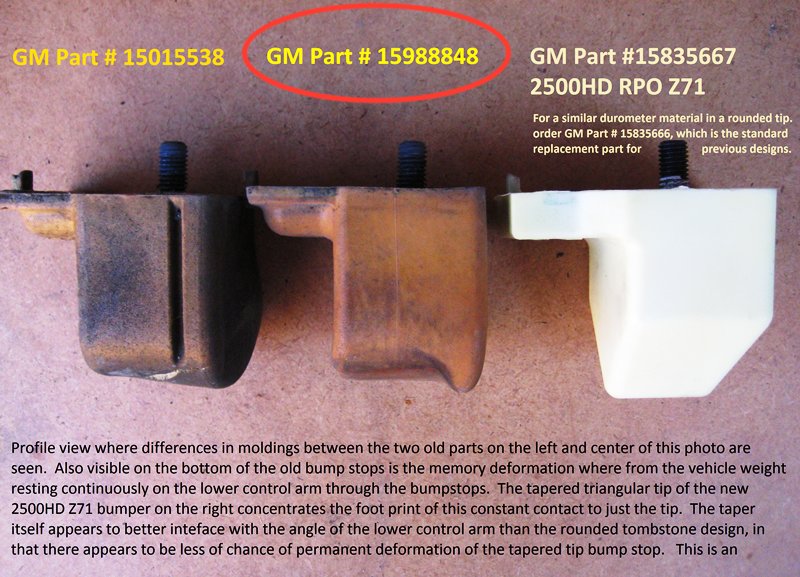

    Anyone know where this part may have come from? It flew out from under my tundra the other day. It has a serial type of number on it...1F0FAE2B-D0B9-4F81-87BD-F4BE7EA9299E.jpg214279EF-983F-40F0-83C7-AFC6CADED4BA.jpg

    Rubber bump stop thimgy on top of the rear leaf springs??

    Rubber bump stop from a rear axle. (On top of the rear leaf springs)
    I’m not convinced that is from your ‘14 Tundra though, is it possible that you ran over it on the road and kicked it up? It looks too old and beaten up.
    On second thought, could be a front axle bump stop. Can’t recall the shape of them.

    GM bump stop. Hopefully not from your truck!

    Thanks guys! It must have fell off someone else’s truck then, I heard it thump under my truck and saw it in my rear view, just assumed it came off mine...
