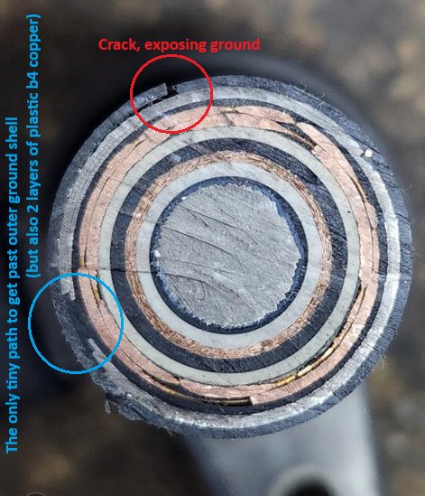

    Not valve seals. Spark plug tube seals. Two very different things. They need to be replaced with the valve cover gaskets, which also often leak.
    And the electrode end of the spark plug sits inside the cylinder, so leaking into the plug tube shouldn't be happening if the plug is (at least) hand tight. Discoloring of the coil pack could be caused by a loose plug, firing combustion back up into the tube seal. Or just from heat, it's pretty clear from the discoloration on the heads of the V8/2UZ we've seen that the back half of the engine sees more heat than the front half.
    Pointy vs. round - Iridium plugs tend to be super fine-pointy at the end, so if original plugs were rounded out, they were either very fucked from a specific ignition condition, or they were just copper units that were cheap, really old, or both. If the old plugs were regular copper plugs, they're supposed to be changed every 30k miles IIRC, Iridium last twice that long. If you'd never changed the plugs, it's quite possible the previous owner hadn't in waaaaay too long also.
    I suspect the spark plugs were the issue, but sure, if original coil packs or aftermarket coil packs were installed, they were probably tired (or inferior if aftermarket).
    I think it's important to understand what's inside OEM coil packs to fathom why cracks in the coil pack casings (if OEM) shouldn't cause misfires. It'd take a very deep crack in a very specific place before you reached anything that could arc. Look at the cross-section of an OEM coil pack below and you'll understand why I say that. Notice there's a solid (grey) ground ring surrounding the live/copper parts of the coil everywhere but a 2mm-3mm section at 8 o'clock (blue circle). Below that outer plastic that's cracked (red circle), you'll notice, it's cracked down to the ground ring, and grounds don't arc to ground. Coil packs are thinnest around that outer shield/ground ring, that's really the only part thin enough to crack, not the thicker part in the blue circle. And if you look carefully inside that blue circle, you'll notice the outer part only is a sleeve, so even if that outer sleeve did crack, that next layer of plastic would need to crack in the exact same spot before you started to get into copper, and the chances of that are almost zero.
    tl;dr - coil pack cracks are a red herring that get overhyped/blamed for too much shit, without valid reason. However, at 250k+ miles, your truck's factory coils and factory injectors are tired. Anyone on here's truck would likely run like new if folks installed new, authentic OEM injectors and coil packs.
