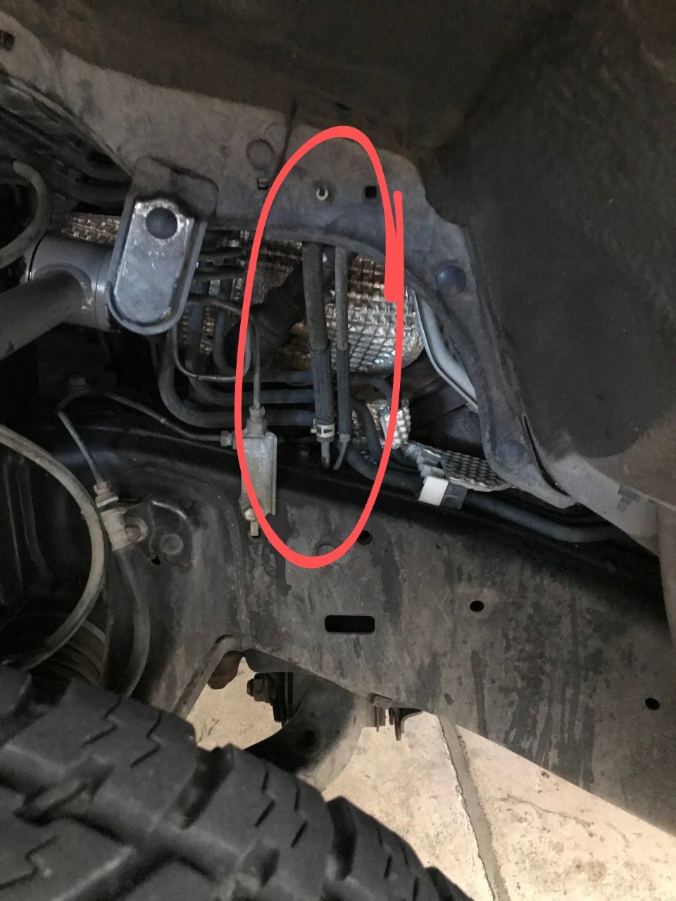

    Hello all. My name is David and I just managed to find a Tundra for sale where I live in Zambia. Great truck that has sat for who knows how lonf. I've got a couple issues to sort out so I apologize if I'm a bit needy. The first one should be an easy one for anyone who doesn't have a demon dog that is overzealous when pursuing rats. I am wondering where the two hoses go that are located at the rear side of the front driver's side wheel well. I have attached a photo I found on here with the pipes still there. All I have is the metal pipes where the rubber hoses are supposed to connect. Thanks in advance!

    Those are the front diff vent hoses.

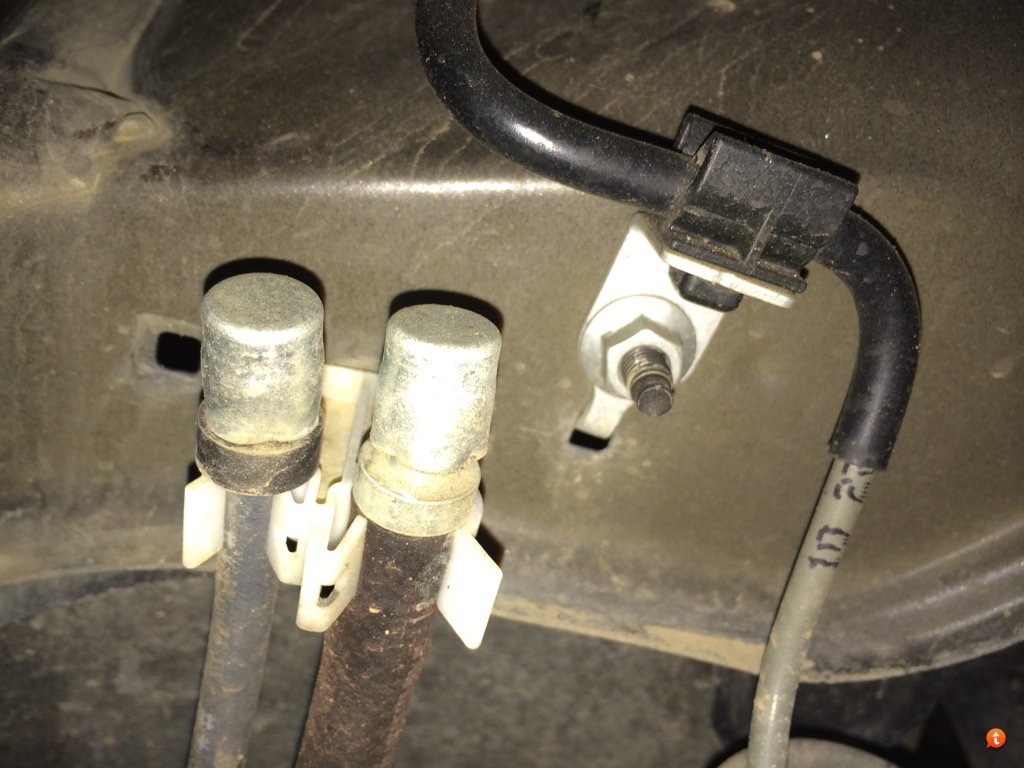

    Thank you for the quick reply! That makes sense. Where do these hoses terminate/ what is on the end? Are they open with a 180 degree bend at the end or is there something in the end of the hose to keep water out? Also where are they clipped on? Just trying to put things back as they were

    The hoses end basically near those holes in the fender well. all you'll need to do is buy some breather caps and match up the hose that's missing. Here's a pretty good pic.

    That's a huge help. Just what I was looking for. Thanks a lot!
