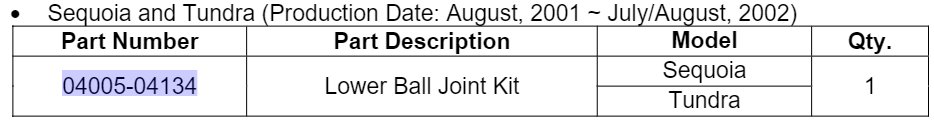

    In my search for such a kit, I found this service campaign
    On page 3 (Heading #6, Parts Ordering), two different recall kits are listed. The one that interests me is the kit designed for Tundra's manufactured from "Agust 2001~ Agust/July 2002". Kit #04005-04134 as seen in the picture below:
    I infer that this kit is for the early model year 2002 Tundras.

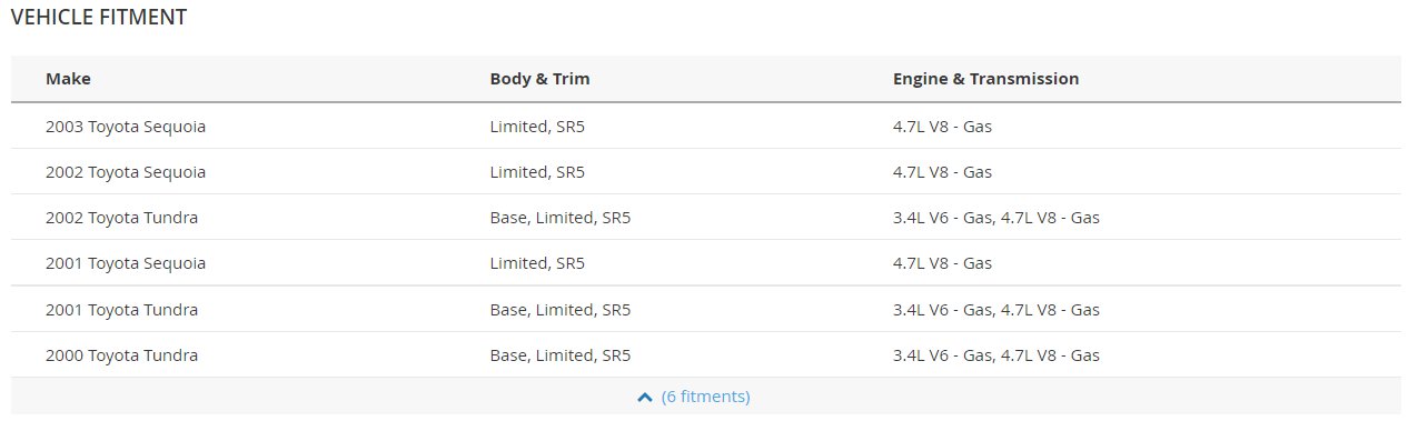

    A quick parts cross-reference shows that all 2000-2002 Tundra's use the same front ball joints, PN 43330-39446, as seen here:
    2000 Toyota Right LBJ
    Fitment for Part #43330-39446:
    Hypothesis: The 2002 Tundra recall kit works flawlessly in all 00-02 Tundras.

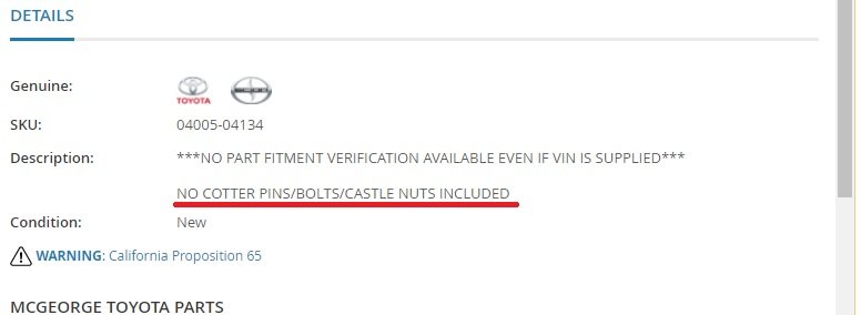

    McGeorge Toyota Offers kit 04005-04134 here
    At $186.46, It's slightly more expensive than just the two ball joints by themselves ($171.60), but I'm assuming that, like the other kits, this one comes with all the hardware (bolts, cotter pins, castle nuts).
    Is this kit a convenient one-stop-shop for 00-02 owners, or am I still better off just rounding up all the hardware by itself and then ordering?
    It doesn't look like a real money saver, but it might save me and others time in recommending, ordering, and locating a quality OEM ball joint kit.

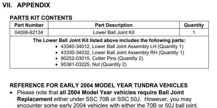

    Fortunately the SSC-70B that followed 50J did come complete for affected veh !
