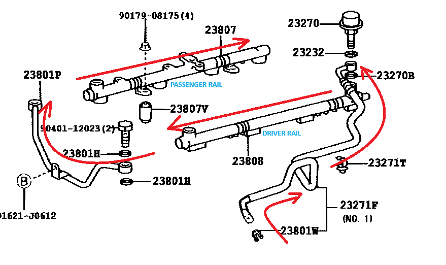

    P0174 is suggesting you're running lean on the passenger side bank 2, i.e. the 4 cylinders on the passenger side bank. That means you're either getting too much air, or too little fuel to the passenger side of your engine.
    On many EFI engines I've dealt with over the years (quite a few), fuel pump connects to the driver's side rail, and the driver's side rail routes to the passenger side from there. I'm quite certain the 2UZ-FE in your truck is the same, as shown below for fuel path, where the passenger rail gets the dregs. It has to have enough power/pressure to push the fuel to the point it gets consistent pressure all the way to the end of the line, and has enough pressure to return undelivered fuel to the tank. thankfully, there are pressure regulators along the line to make sure the pressure never gets too high.
    If that's accurate, let me ask you what you think:
    • If the passenger side fuel rail is at the end of the line,
    • and the ECU is telling you you're running lean on the passenger side of your engine,
    • which means you're likely either getting too much air or too little fuel/fuel pressure to the passenger side of the engine ...
    What do you think the problem is in this case? What do you think would cause a case where either of those two things could be true, either getting too little fuel or too much air into ALL the cylinders on the passenger bank?
    And will you please answer the question about what brand of fuel pump you bought and where you got it? Because the two answers may be one in the same.

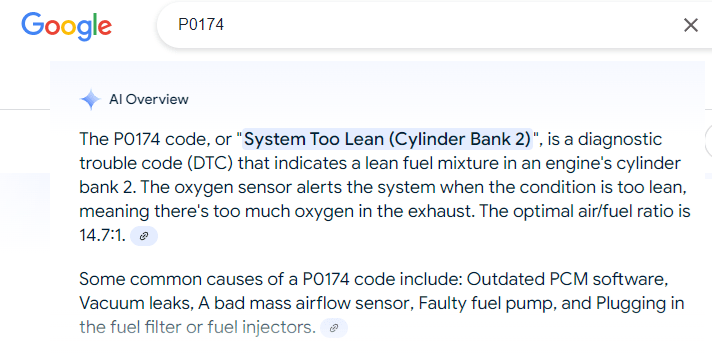

    I was told also by AutoZone their was a misfire in cylinder 6

    Quick Google search kinda debunks that. Now tell me more about the fuel pump, I'm asking for the 3rd time now and really want to help but I need info to help.
