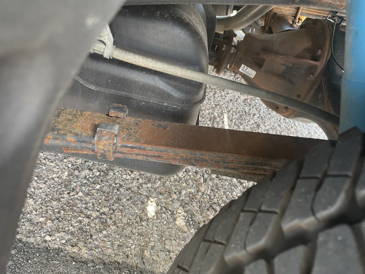

    Ordered a ‘17 trd OR from Vroom. It seemed like a good deal seeing as the truck has only 15k miles and all the features I was looking for. So it showed up and the underside is full of rust. Frame, suspension, drivetrain, even the hardware holding the fender liners was rusted. Needless to say I’m returning the truck and Vroom has offered a full refund and seem to be doing right by me, so far. I’ll know for certain once I get refunded. After this fiasco I have decided to just buy new. So I got a 2021 SR5 crewmax 4x4 on the way.

    Carfax shows where vehicles were registered. Was it in an area that has rust issues?
    Anyway, that's a 4-5 year old vehicle, and it's showing mild surface rust. The control arm is the only thing that looked at all "bad" to me.

    I was told it was coming from Texas but turns out it was from Ohio. We’re not used to seeing much rust out here so to me it looked pretty nasty. I just know If I’d seen the truck in person I wouldn’t have even considered it.

    Its surface rust. Some rust on control arm and leaf. Shouldn't be a huge issue if it was a good deal. If you are not happy then it make sense to return it.

    Un-protected parts rust, that's just the nature of things. To be honest, that looks pretty clean to me. And that slight rust can be fixed in no time at all with a little work then some protectant used to keep it from rusting further. Don't give up on a good truck over something as minor as this.

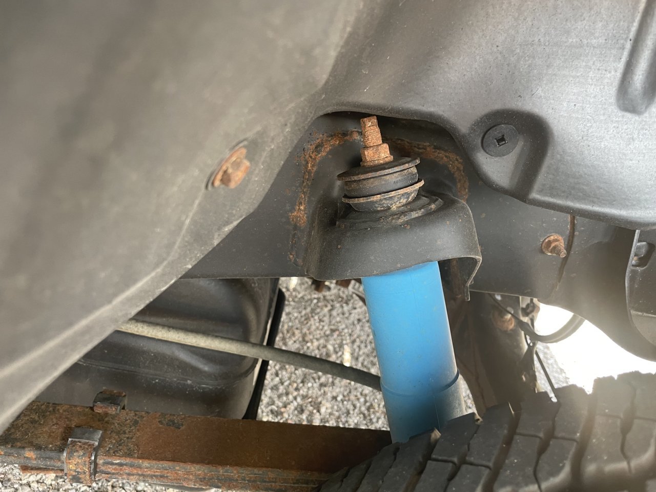

    As a California owner, I'd be terrified :rofl:the leaves are meh, the rust around the rear shock brace welds is what would scare me the most.

    Nothing a wire wheel can’t fix

    Yes, I would immediately clear any of that off and fluid film no matter where I lived - it’s surface and not severe - but no point in waiting for it to return.
    Low miles doesn’t mean well cared for or never driven in salt - just low use.
    Should have been noted by Vroom I think - and really should have been cleaned up - but they are more focused on the flip than reconditioning these days.

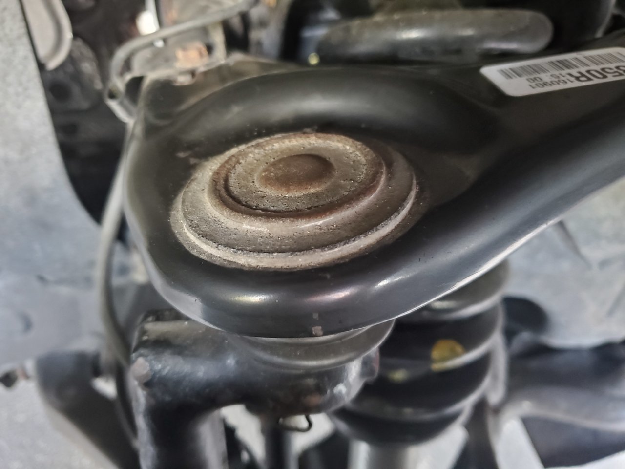

    The control arm and top bolt for the rear shock look pretty bad for a 2017...
    And I live in Northeast Ohio.

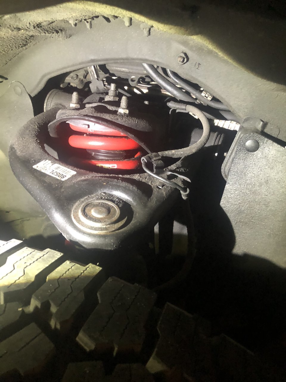

    me 2. heres mine 2017 on long island, goes on beach, salt from winter and i am not even super anal about washing it

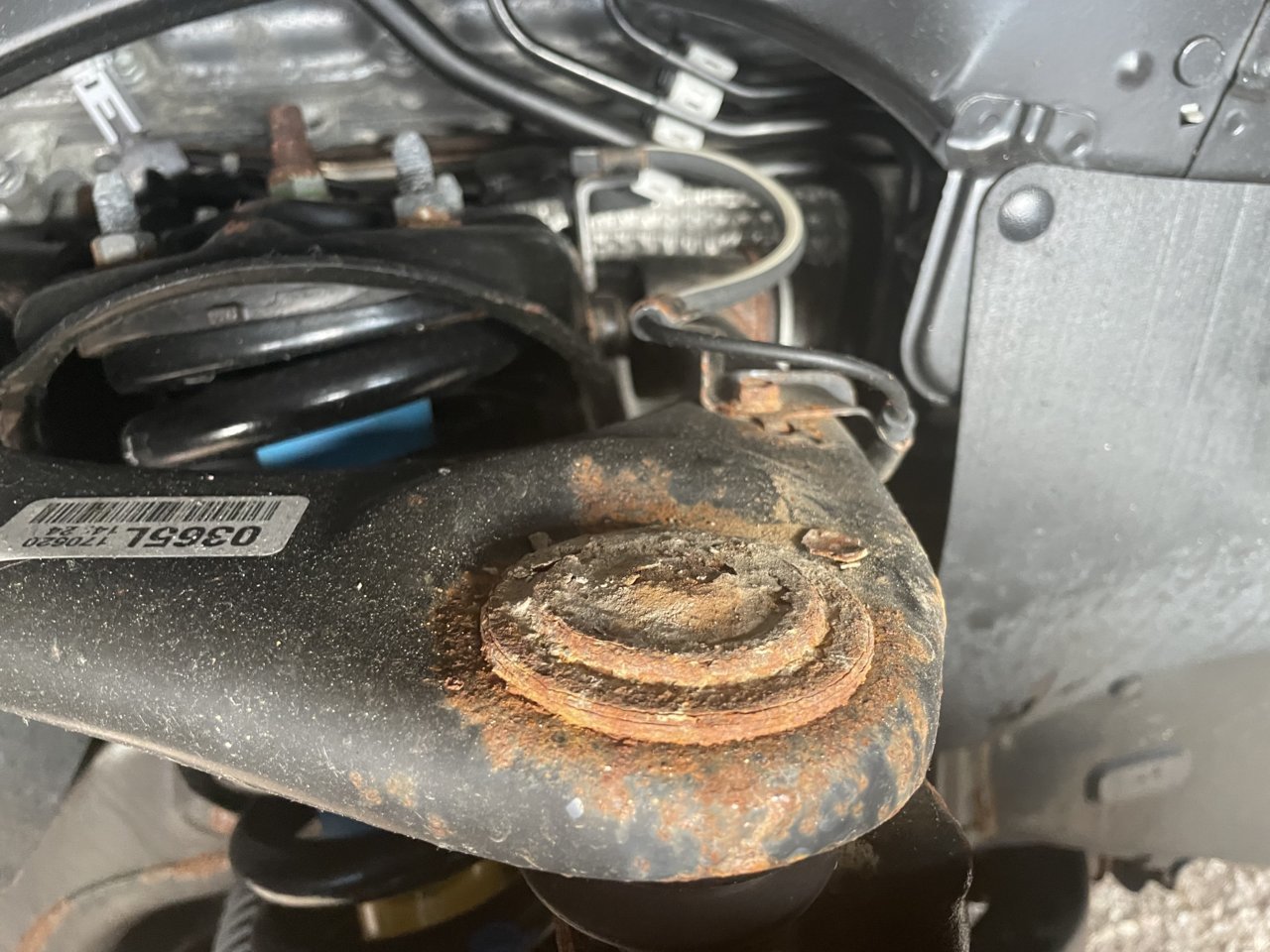

    I had some surface rust on control arms and at the welds on the frame. Just hit it with a light wire brush, then rust converter and fluid filmed it. Looks like brand new down there now.
