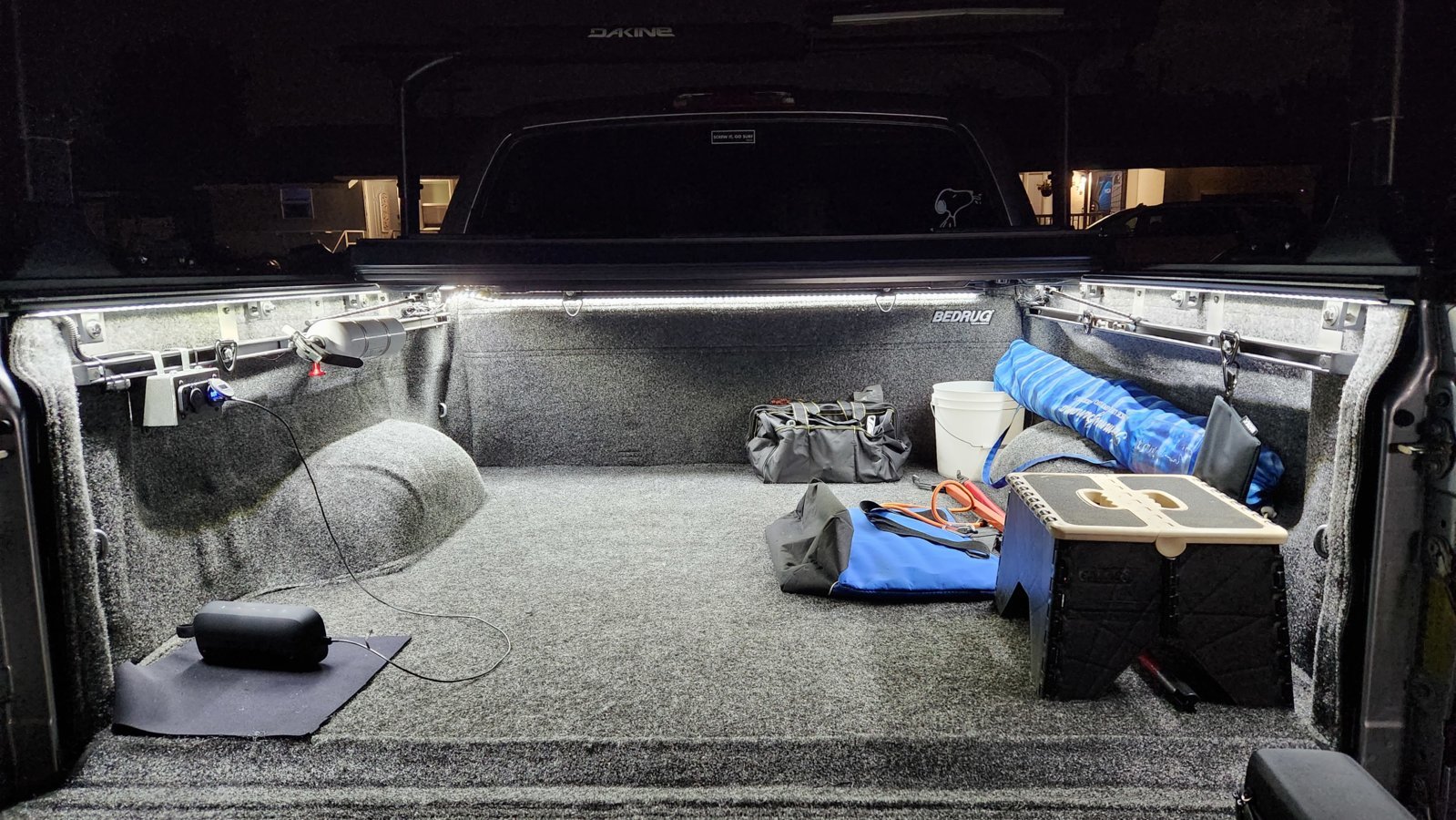

    I have the same ones except mine is the 3-pc kit. (Like $33)
    The 2-pc is probably plenty bright.
    Love being able to hit the switch and see what I'm doing, find what I'm looking for. Mine have been in for at least a year with no issues. Some people in the Amazon reviews said the adhesive was weak... I cleaned the surface REAL good with alcohol and they're still stuck just fine.
    They fit quite well... I have a CM and just had a little extra wire to zip tie in the front corners of the the 5.5' bed, I'm guessing DC would use up that extra and fit perfectly.

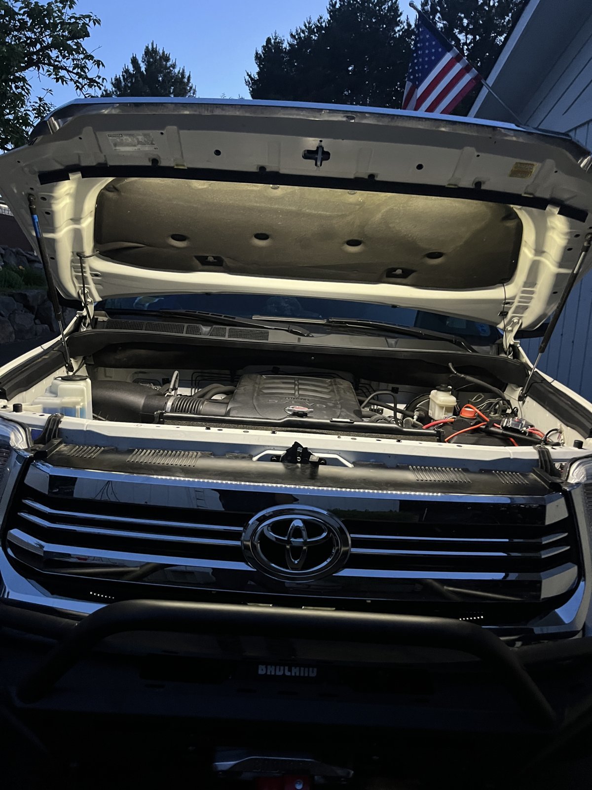

    Order Matt’s truck bed kit AND his under hood kit…they’re inexpensive, and if you’ve gone to the trouble to run the wire from bed to engine bay, you just splice the bed powerline to the hood light and voila!
    The hood light is literally less than 10 minutes if you’re also doing bed light…it’s super useful, especially if you go camping or overnighting somewhere…
    I can walk you thru it if you need help!

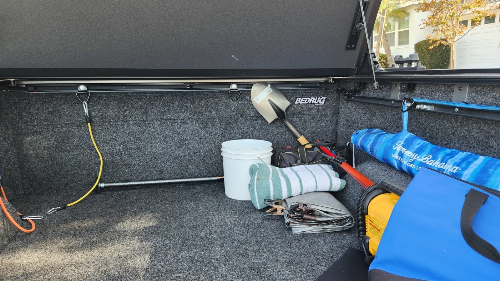

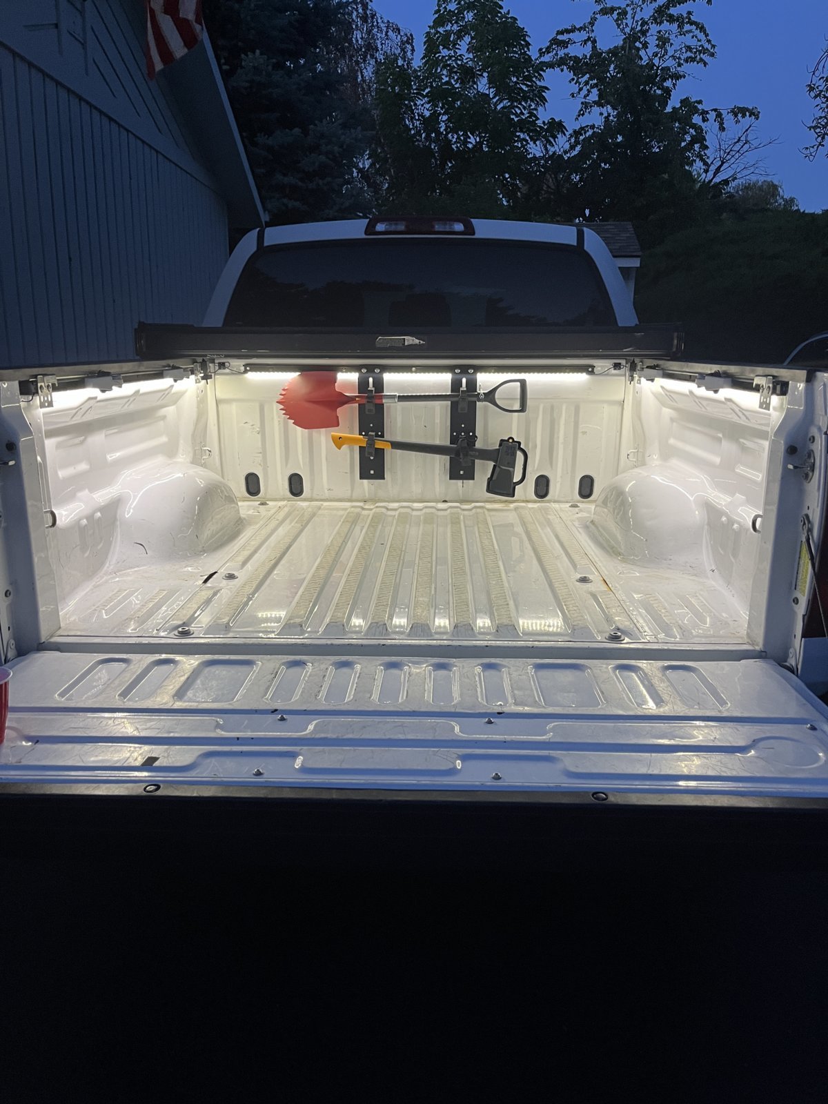

    Got a link to the shovel/axe holder?
    Is it bolted at the bottom too or just in the rail?
