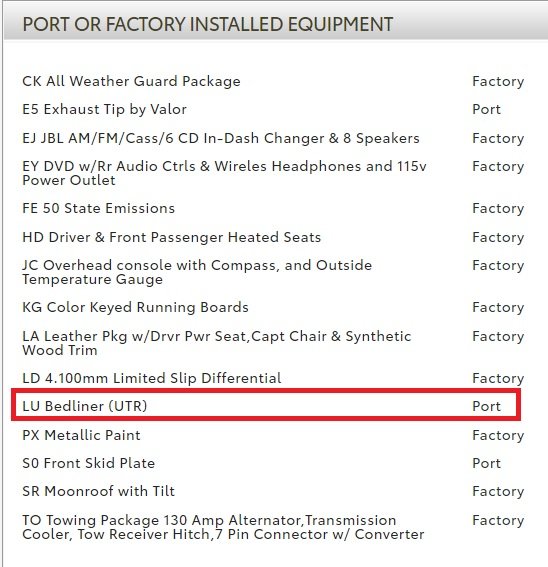

    If you go to the below Toyota web site and input your VIN #, you can see the specs of what came with your truck. This will include an entry similar to the below entry of whether the liner came from factory or was Port installed if interested !
    Vehicle Specification | Toyota Owners
