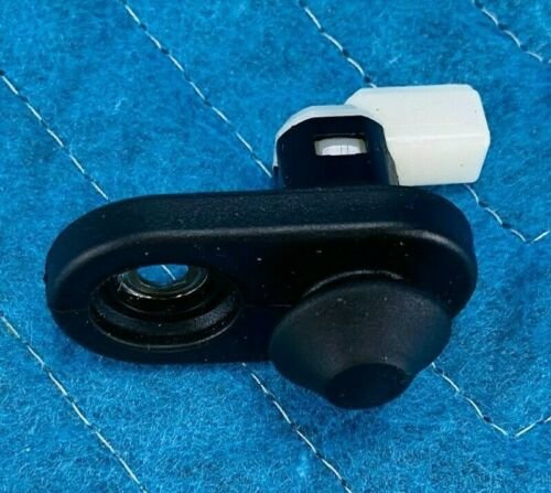

    Have experienced something similar that had to do with the door courtesy lamp switch. Being almost 20 years old the driver door would come with barely a slight gap. I recently ordered all new ones 84231-53010 since I had another one flaky possibly due to body shop. In any case, it's a few minute test you can do to determine if the switch is flaky or even your door weatherstrip has bit the dust.
    Stand outside driver door with it shut, push inward on door with right hand, barely unlatch door with left hand, light should come on. Push door in/out just enough to make door light on Instrument Cluster to go on and off. Does it take much of a gap to make light come on.
    You could also simply door switches with each to check.

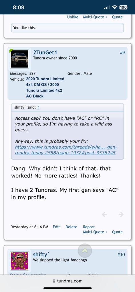

  9. Feb 16, 2025 at 6:16 PM

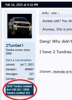

  10. Feb 17, 2025 at 5:32 AM
    shifty`
    shifty` I'm having daydreams about night things
    Jun 20, 2020
    #48239
    28,397
    ATL
    '06 AC Limited V8/4WD
    When someone needs help, I look here. That info is controlled by the "Vehicle One-line Description" over here.
  11. Feb 17, 2025 at 8:12 AM
