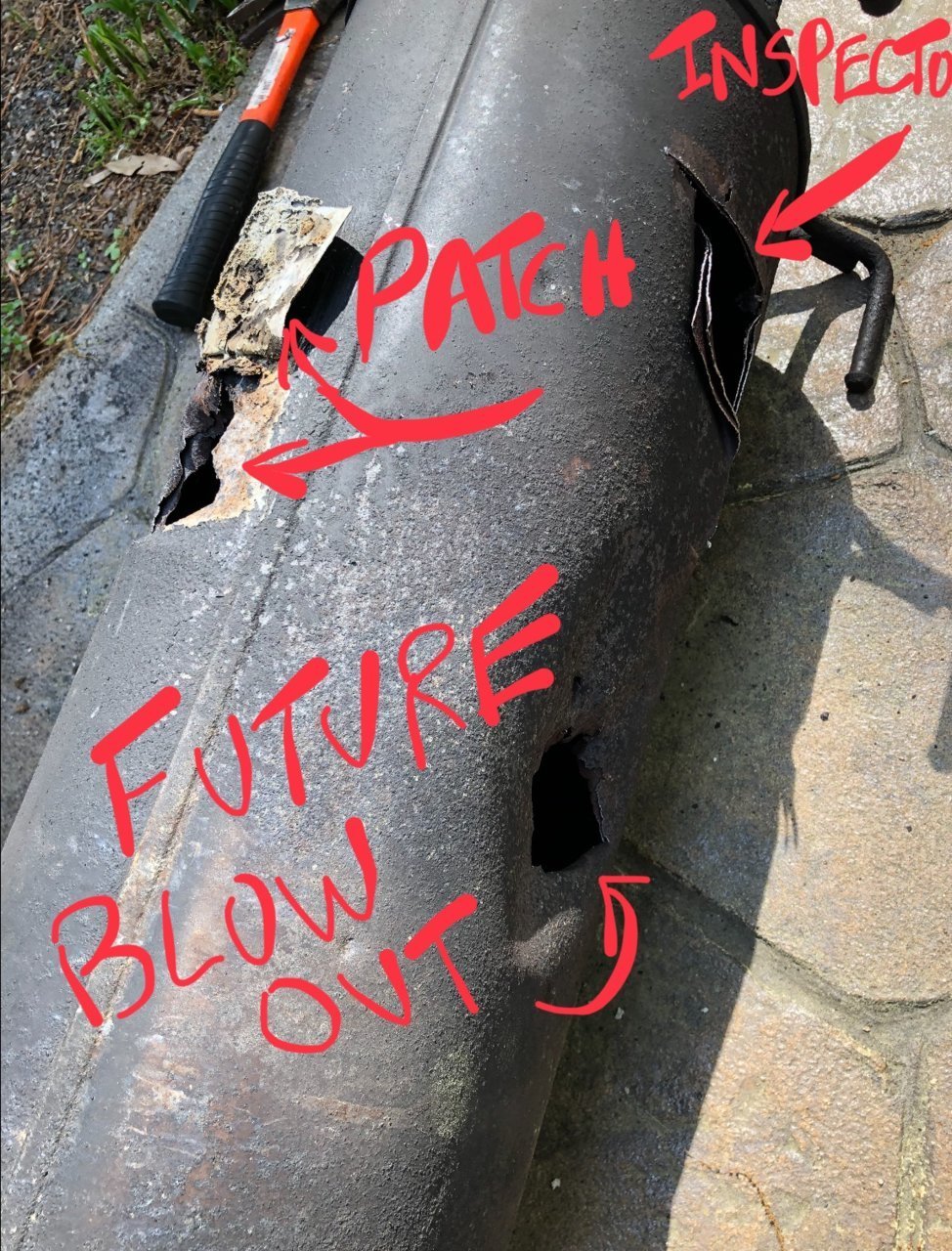

    Put a new gas cap on ($8-16 depending). They wear out over time. Had a EVAP Code and a new cap cleared it.
    Exhaust sound is probably rot.

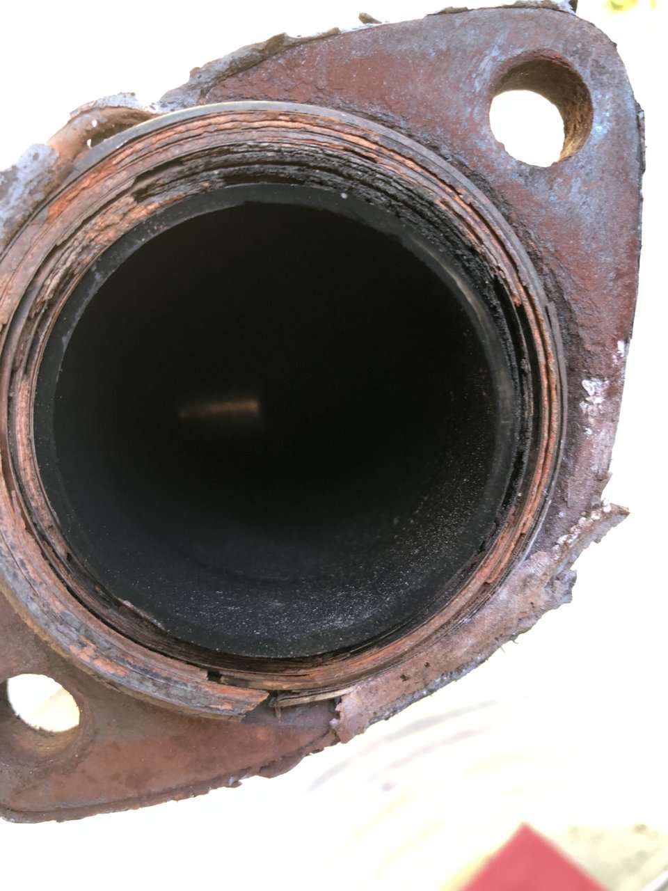

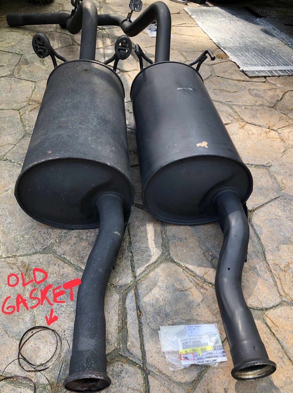

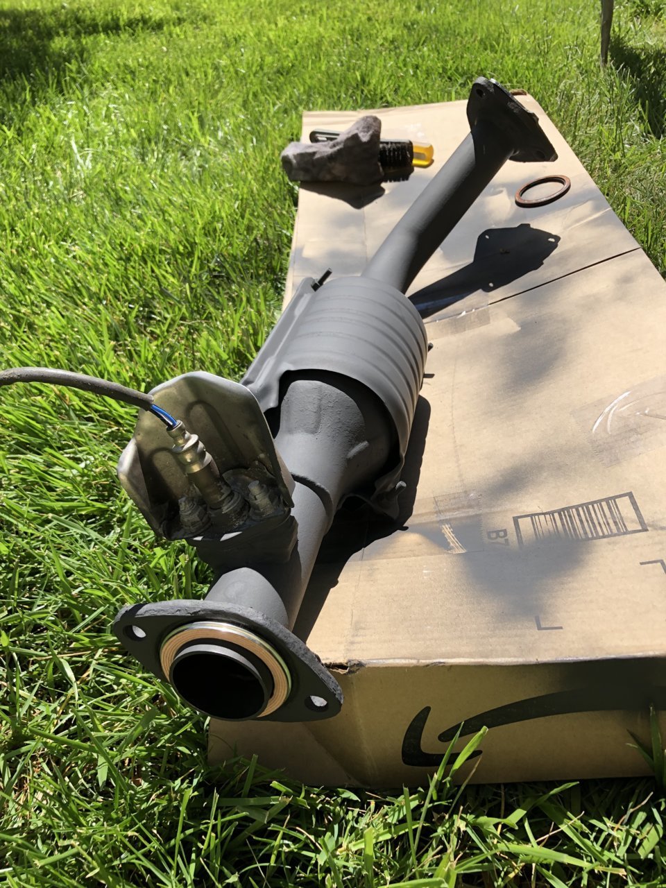

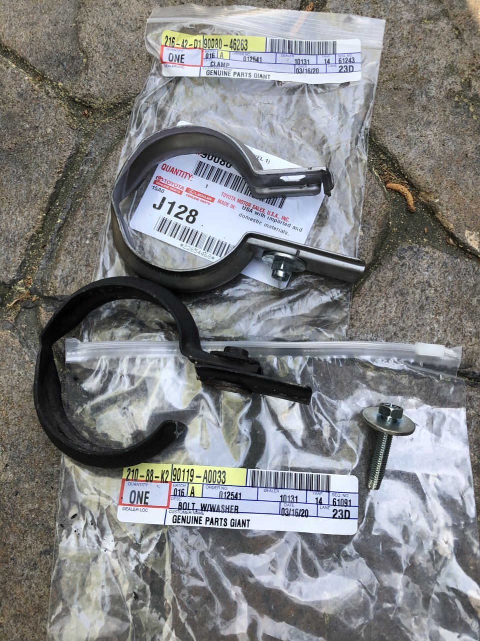

    I BBQ Painted my Old and New Exhaust. Tried patching the old and it lasted a little while. Found a 15 year storage’d brand new OEM last year. Felt some added torque with new gaskets and muffler. I’ve since replaced all the gaskets and have new Shorty Headers. All the old gaskets were gnar gnar and leaky except at the collector in front of the Cats. Resonator still looks and feels solid with but might be a matter of time on that.

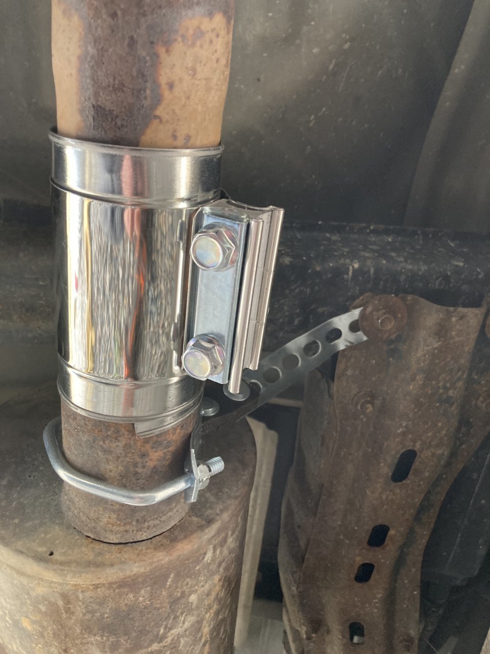

    Damn thieves. I'll bet it sounded awesome. My truck sounded great when I only had to repair this severed pipe before the muffler.
    Awesome gets tiring after awhile.
