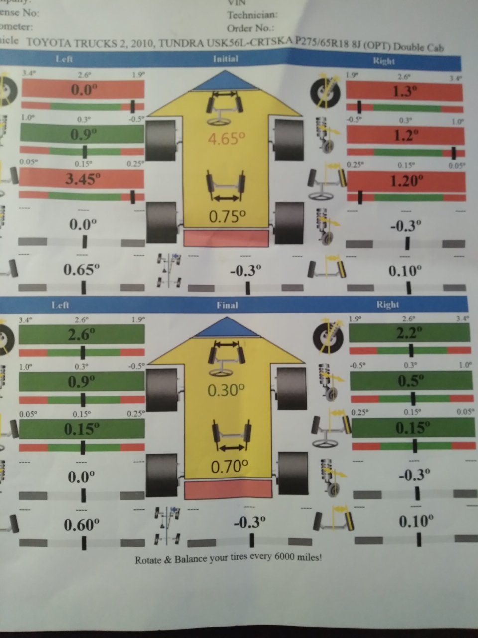

    So here is my print out on my alignment today after putting in my 3/2 lift. Truck feels pretty good rides straight. A little different resistance on turning but over all not too bad, but to be honest I'm not well versed in the area of alignment specs. Does this appear to be a decent result?

    I am no expert either but I say all green is good!
    What kit did you use for the lift?

    You've got more positive caster now (the one with the big tire icon) so the wheels will want to go straight on its own rather than wandering. Toe looks good for your size tire.
