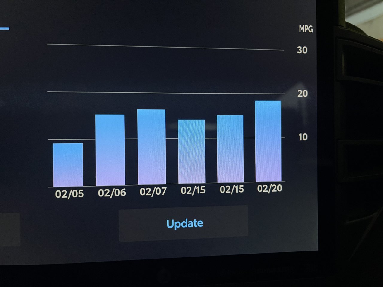

    2. Mileage
    I have put some 34.1 inch oversized heavy tires, 23 pounds heavier at each wheel to be exact. My highway mileage is 19-20 corrected mpg and about 16mpg combined. Here is a mpg history plot from the car, much more informative than a snapshot. Of course, this is the uncorrected mpg, need to add .75 to 1mpg on top.
    Forgot to mention, this is in Eco mode, and I do have a bit of a lead foot. I found I get better mpg with cruise control.

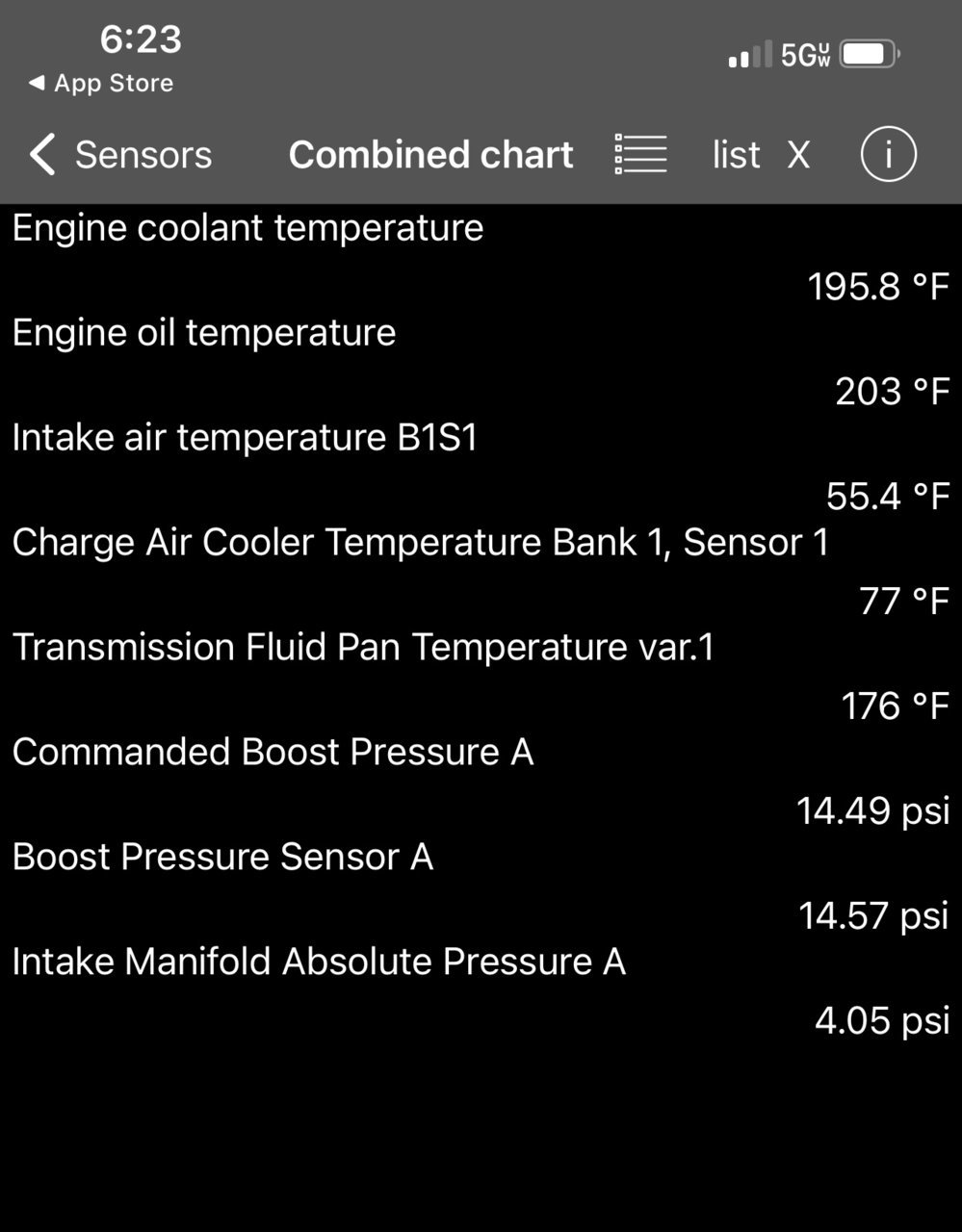

    I wanted to update.
    I bought Veepeak OBD2 wireless scanner from Amazon, $33. Also Car Scanner Pro from the App Store, $7.
    This thing can read everything, including intake temps, pressures, charged air cooler temps. See attached. These are few of the live parameters I chose.

    According to the below video, it appears the 2022 has a separate cooling loop for the air/water intercoolers and turbos. It is controlled by an electric coolant pump that can keep the coolant circulating “if needed” after the motor is turned off. That bodes well for reliability and not cooking the turbo bearings and seals with a hot shutdown if true. A built-in turbo timer of sorts.
    EDIT: Roughly 8:45 in the video is the turbo/intercooler cooling loop overview.

    Yes it does! It is a completely separate air to water intercooler systems I think. That and tricks in oiling is the reason this turbo engine runs so cool when under load.
    A lot of Toyota owners may see it a given, but when you try to extract as much horsepower as possible and push the limits, heat becomes a major factor. It is simple: less heat translates to more reliability! I am very pleased and surprised how they can keep this beast of an engine so cool with those turbos.
    I have mentioned before, my new 22’ naturally aspirated BRZ heats up like hell on the race track. My turbo base Cayenne heats up to above 235F when pushed hard as well.
    I tried pushing this engine, with 100% sustained load on a steep grade and high RPMs. Highest temps I saw was 222F. I think this bodes well in long term reliability. Again, this engine is the same that we find in the new Toyota icon—the land cruiser. Toyota would not have jeopardized their name by coming out with a half-baked powertrain in a vehicle that exemplifies what reliability should be.

    Yes, completely separate. Has its own water pump as well as its own radiators. Fluid flows through the intercoolers, then to the turbos, then to the rads. To your point about "tricks in oiling" I read somewhere (haven't been able to confirm if true) they use oil sprayers to spray the underside of the pistons which helps keep temps down, a trick they learned during their most recent stint in Formula1.
