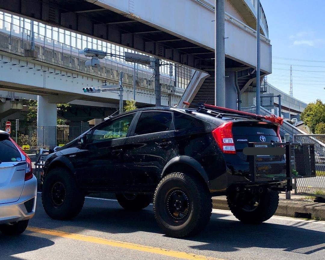

    Dec 22, 2023
    #108909

    It'd just be easier to convert the Prius to OR setup :bikewhoops:
