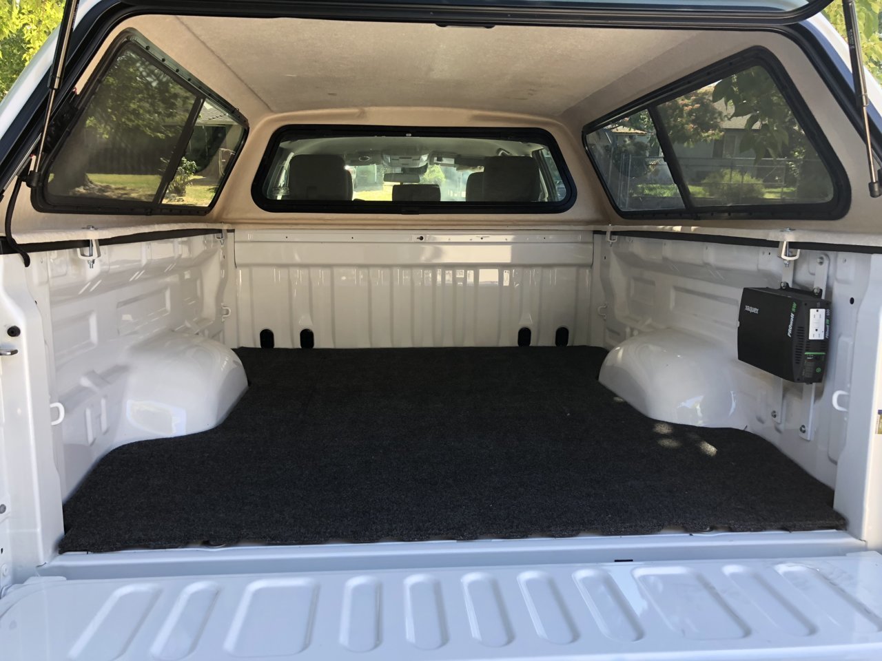

    2 - Camper Shell
    3 - Bed Rug on floor and tailgate
    4 - 12volt to 120v inverter inside of camper

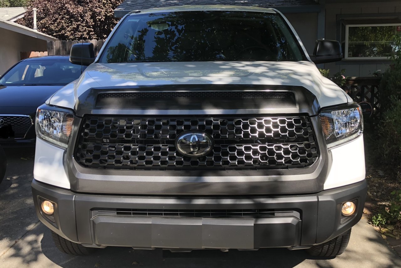

    5 - Fog Lights - after market - Fit perfect and plugs existed
    Bought from https://www.carid.com/2018-toyota-t...s-965506994.html?parentsubmodel[]=SUBMODEL|SR

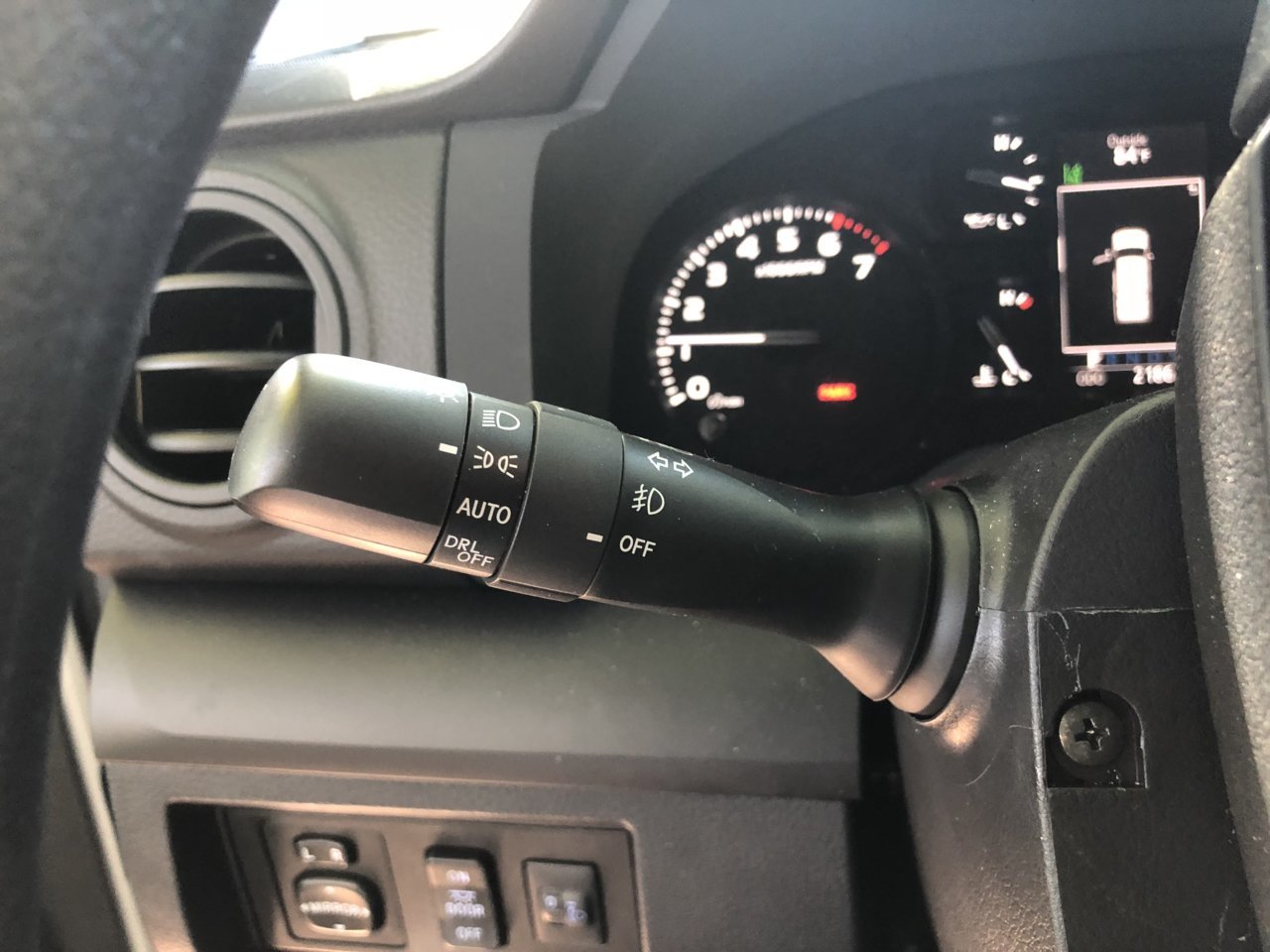

    6 - Fog Light switch & Relay - from Toyota
    84140-07113 Headlamp Switch W/ O MIRROR SIGNALS, W/ FOG LAMP
    A friend installed the switch as I don't have all the stuff to pull the steering wheel.

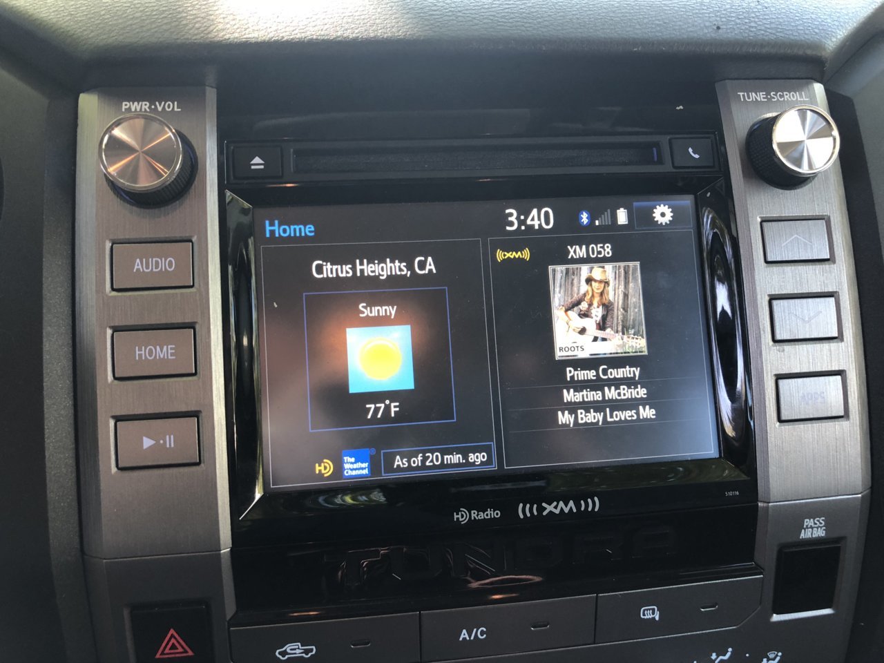

    7 - Entune Plus radio (replaced my Entune Basic), this I bought a 2016 one with the SiriusXM module. I used my old SiriusXM antenna I had from my old radio (magnetic) and a Antenna that would receive the HD Weather/HD Traffic

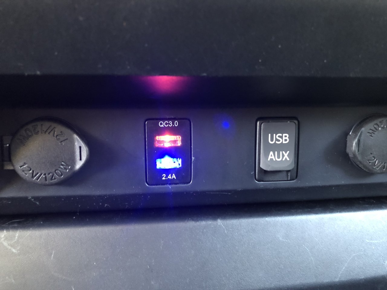

    8 - Always on, USB plugs from Amazon - https://www.amazon.com/gp/product/B07FD2Z6GF?ie=UTF8
    The plug fit perfectly into the panel, no cutting. I ran the hot all the way to the battery, ground I connected of course to a ground on the body.

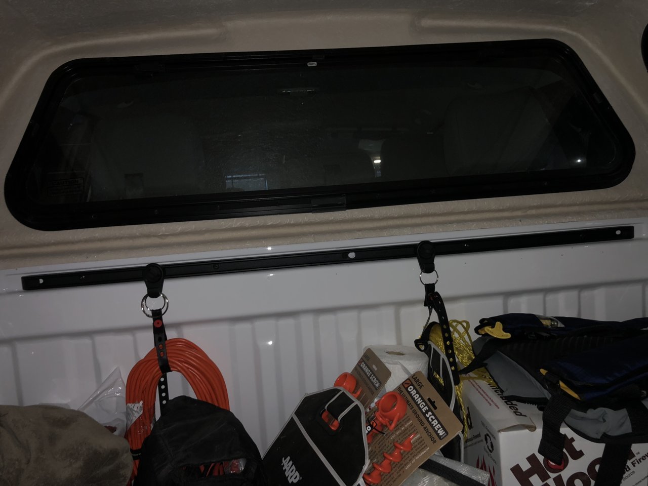

    9 - Front Rail for hanging things

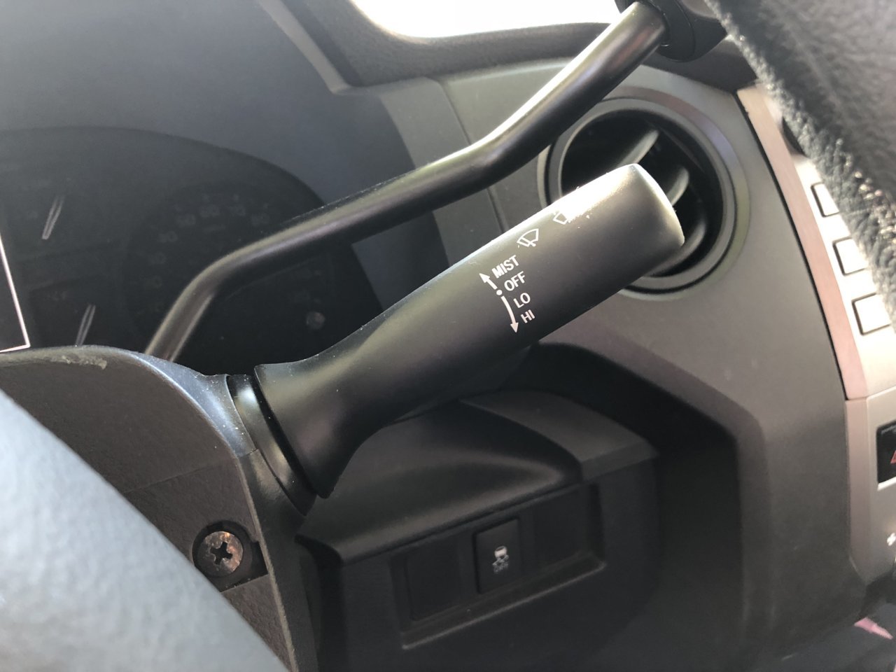

    10 - 9/17/18 just added the Intermittent Wiper Switch switch is the one for Wiper Switch with Intermittent (my current setup is Low and high only)
    From Toyota: 84652-02710 Wiper Switch W/ INTERMITTENT
    Here is the old one
    Here is the new one
    The above was fairly easy, just had to turn the steering wheel around to get to the clips

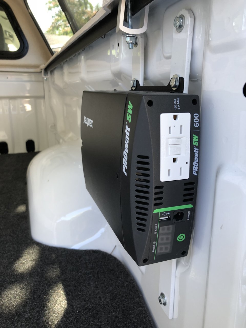

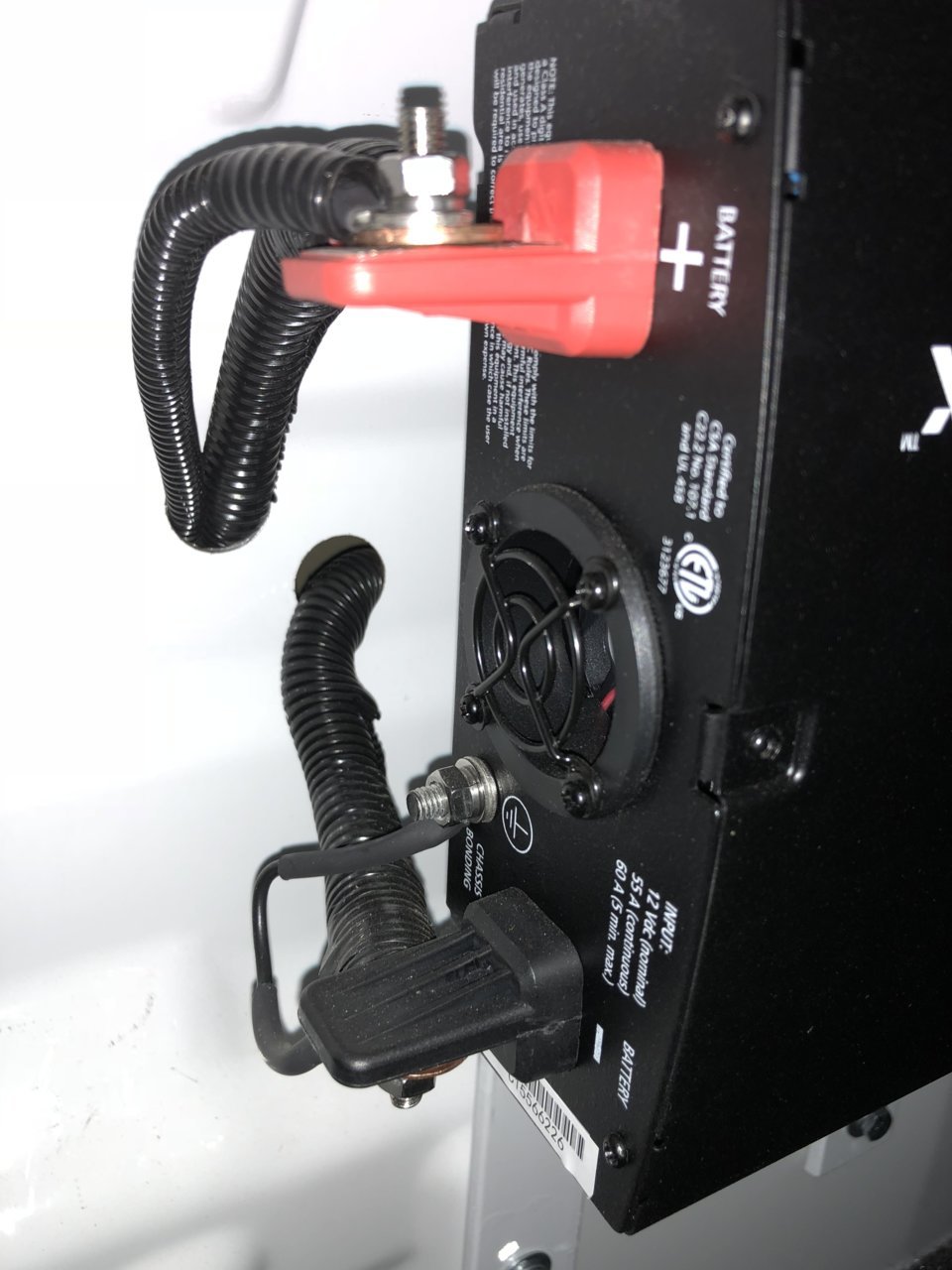

    I like the power inverter in the back, maybe you can shed some light on how you did, maybe others on here would like to know as well :)
    Midnite72, phabej and Trebor57[OP] like this.
  12. Sep 17, 2018 at 9:16 AM
    Trebor57
    Trebor57 [OP] New Member
    Jul 22, 2018
    #17295
    84
    Rob
    Sacramento, CA USA
    2018 Toyota Tundra SR Double Cab - 2-wheel drive

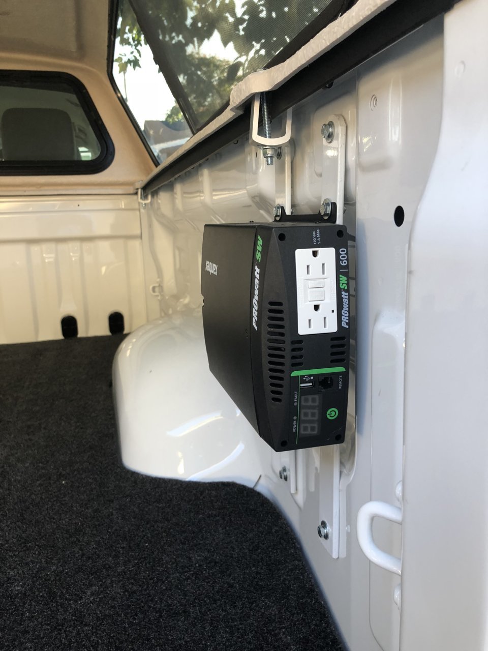

    I actually had it done for me. I do know the cable goes from the battery to a circuit breaker in the engine compartment, then they ran the cable I believe under the truck which it came in the back panel where they mounted it on the side. If you want a picture of it looking directly at it, instead of from the end, I can get it.
    I should look where the cable makes in into the panel too :)
    For me, having the inverter there helps when my wife and I go tent camping, blow up the air mattress, if we need additional lights, use any tools if needed, or whatever, including charging a phone too.
  13. Sep 17, 2018 at 9:20 AM
    50,752
    Pics would be greatly appreciated! When ya have time

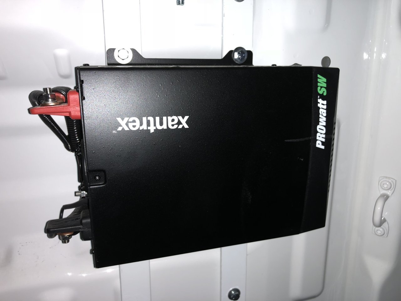

    I went out during break time and took a couple of pictures
    Unit mounted in bed
    Breaker in engine compartment
    Back of Inverter where wires come in

    9/17/18 - just replaced the Windshield Wiper switch that came with the truck with just high/low speeds to one that does intermittent switch. I posted pictures of before and after in the first post #10 on my list.
    It was an easy thing to do, just 2 screws on the plastic piece on the steering wheel, press in 2 clips to remove electrical plugs and on press in clip that help the old one in, the reverse the process. It all works great and only cost me the switch!!!

    I saw that post and said, that is easy! So, I did it and it worked. Going to try my morning soda in it tomorrow on my way to work. :)

    I love it, that is why I had to post it too.I am glad you liked it too. I am always looking for something more to add....of course without spending a bunch. I used 16 gauge wire to the battery and the ground went to a screw by the drivers door

    Yea I’ve been trying to find a suitable charger for weeks. They’re all ugly and bulky or small and weak, This is a much better idea, + the “always on”, I love these forums lol

    You can always put a switch on it above the panel to turn it off when you don't want it on too. I have thought of that as well, but always on is great for sure. These forums are great for sure!
