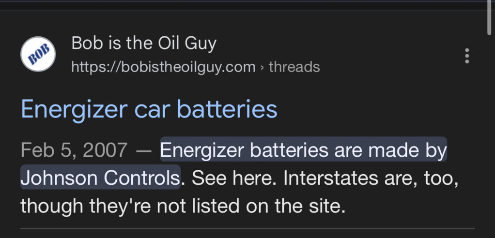

    Occasionally a battery does not slowly slip into oblivion shedding its CCAs along the way. It will simply drop a cell or two internally and be dead as a door nail. Vibration and heat are the main culprits. I’ve had two Autozone batteries bite the dust in this fashion, my Interstates and my Energizers from Walmart have yet to show this type of failure.
    edit: makes sense
