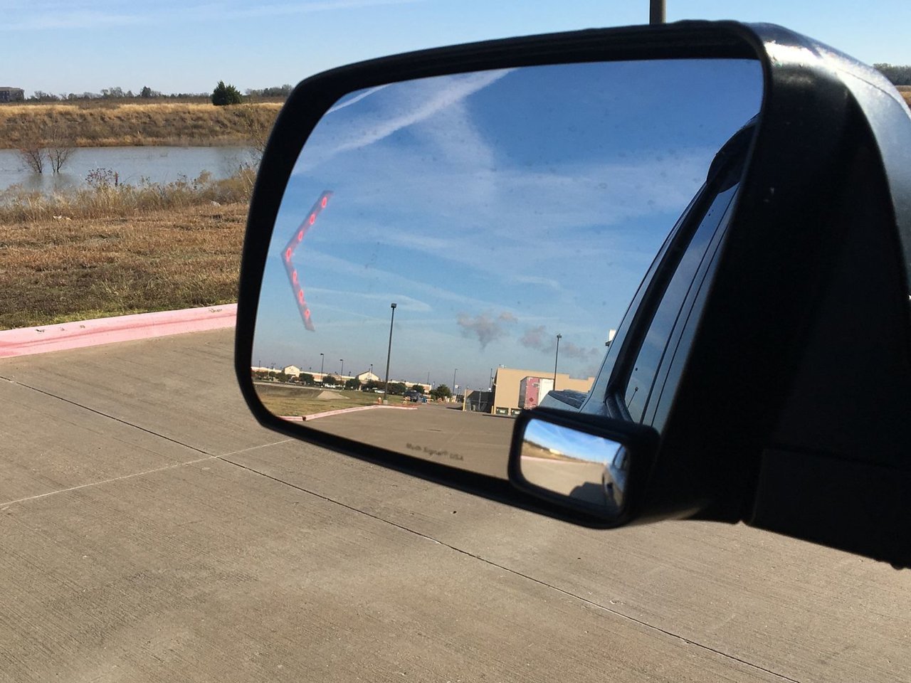

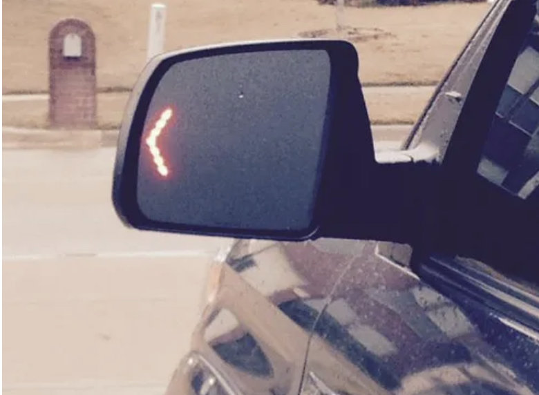

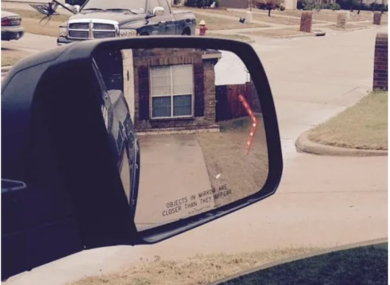

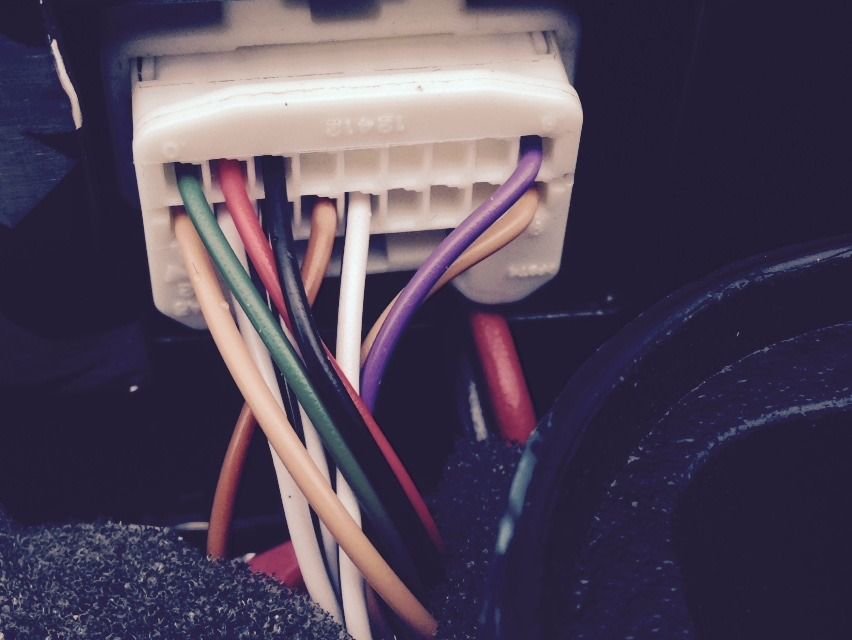

    Seeing you used my pics in the OP, I'll say I have the Muth mirrors in my 2014 SR5.
    I couldn't find a turn signal feed in the mirror plug in my 2014 back in 2015 when I installed mine.
    I had to tap in in the front kickplate wiring like the instructions told me to.
    I also didn't have the wiring diagram back then..
    Maybe you will find it...
    Just follow the Muth instructions and it is easy to swap them.
    D7816C05-2B0B-4CA8-BDD2-C8AD2BF259F5_zps_906f7563de852f1293413e3f1aff9bfa2c393e5d.jpg 26D8CB0C-A48A-4FE4-98CE-70212C595FB6_zps_cac9edcd55d6e618149d2d364f41aedcba226cb2.jpg

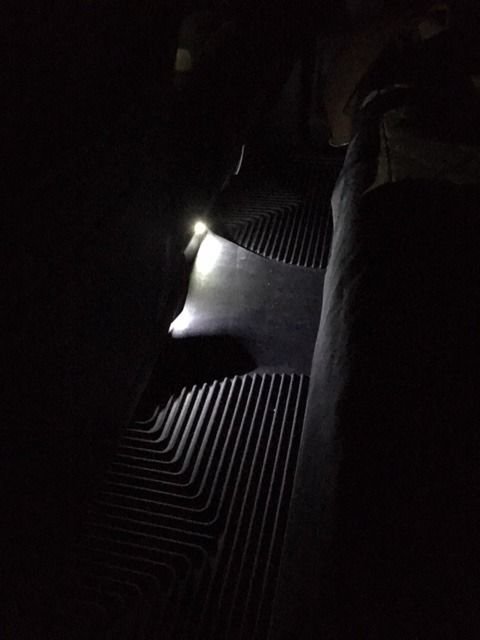

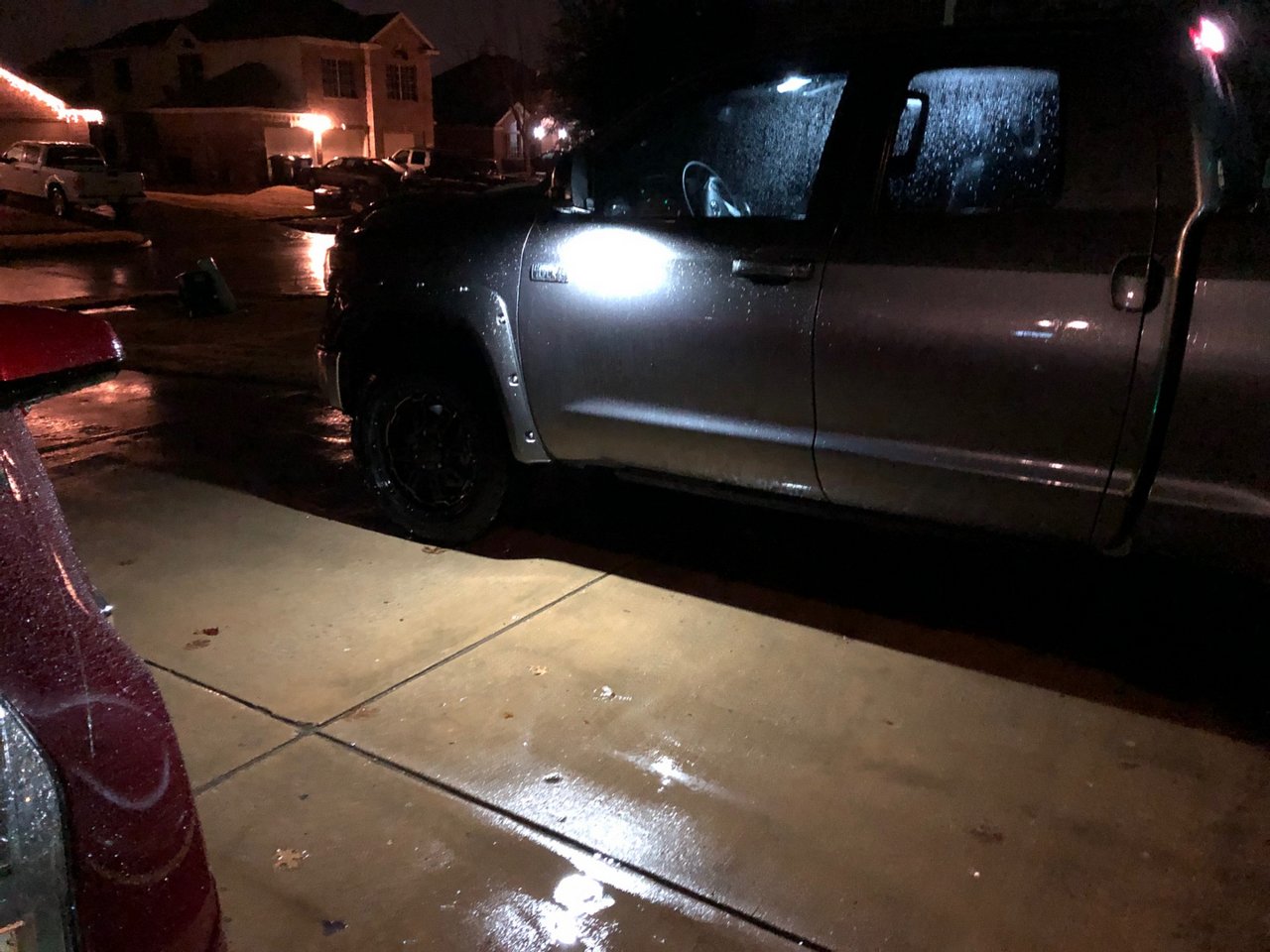

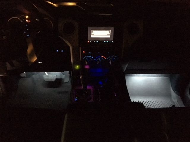

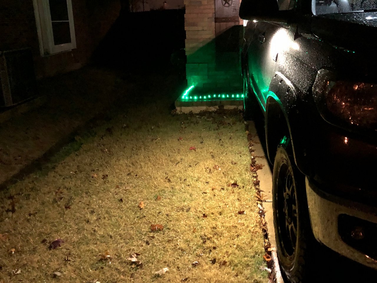

    I made my own puddle lights (using VELD puddle lights) and tied them into the little footwell light in the driver's floorboard.
    Also tapped in LED footwell lights front and rear.
    jq1k2l34_zps6rwjs4ah_5f0850f62e7f731e49737522dfa0b880cc6b2300.jpg 3gnu04bz_zpsgecrr1ak_2df32e71398228ccec612352af0fe3e8ae6d3a33.jpg fottwell%203_zpsfd7vjt6j_c245748195e416beecf2df6a403efe00e225ddb0.jpg fottwell%204_zpslbuhodom_516763fae38bb39fb3c3c053ca8b2fe1cad3aec2.jpg

    Awesome. Yo I like them lights on the floorboard! When I travel it would be nice to have a floor board lights for the kids in the back.

    Keep in mind with them tapped into the little floorboard light, they only come on when you unlock or open the doors.
    If you need them switched on for any reason while driving, I'd find a tap in to the interior roof light..
