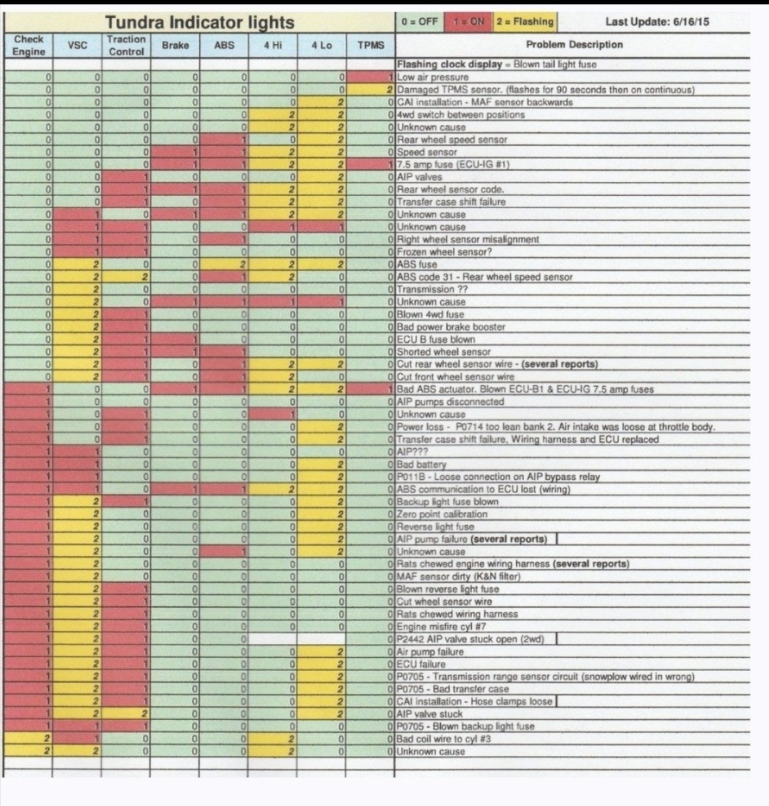

    VSC light flashing, Check engine light on, Trac control light on, code P011B. I have been researching the issue and I’m not seeing any people that have it, so any help would be greatly appreciated. I’ve just finished changing the timing belt, the intake manifold gaskets, replaced my harmonic balancer, and done some small general maintenance things. 2008 Tundra, 4.7L V8, base.

    I would double check your ect wiring and MAF wiring. No shorts or cuts in wiring? All air out of coolant no air pockets? IAT is in the MAF fyi.
    The chart is just some known issues but could be other areas.
