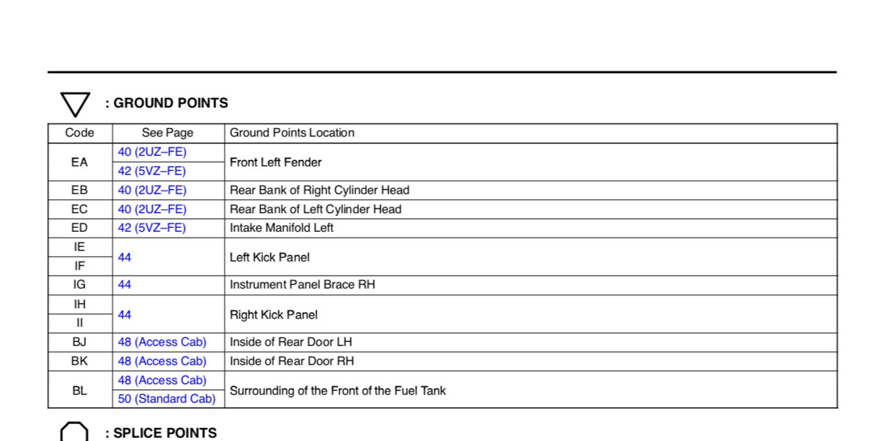

    I suspect more than one ground burned up. I would check the grounds in the cabin. There is one on each side under the plastic kick panel. White and black wires. Most of the dash gauges ground on the left side under the kick panel. May be a good place to start looking.
    Perhaps this will help.

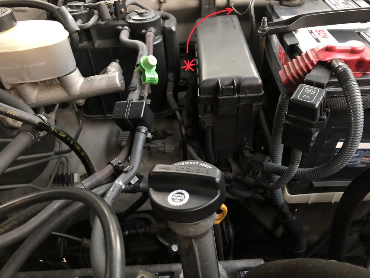

    Not to hijack but since I bought my truck, this ground cable has been disconnected. No issues running what so ever. What is it needed for or what does it ground?

    Seems to be the ground for the battery. Double check and make sure yours is missing and if so reconnect. Transient current flow can be a silent killer of all things effecting bearings, transmission, etc.

    It's not that it is necessarily needed but there are a few reasons veh, planes, etc have numerous chassis grounds. All the different gnds(5 under my 2004 engine bay) helps keep the power clean, and reduce noise. All of our computers/sensors love it as clean as possible. By allowing for multiple grounds closest to each crucial "noise maker" if you will, you're able to ensure cleaner power. AC or DC in our case, want's to take the shortest possible path thereby not having to fight for a clean gnd.

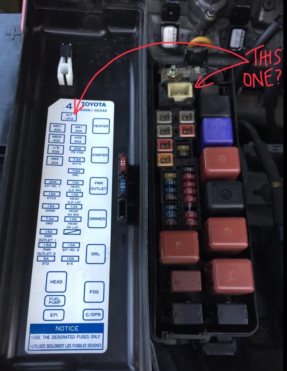

    Ended up being the 120amp fuse All good now

    Thanks for following up. I wonder why it blew? Maybe that battery shift situation you had?

    Would have swore it would be the 20 AMP....just kiddin with ya :hattip:

    That was it..when I took it out was very brittle ..also the 7.5 amp was blown ..but I fixed that one earlier..now everything is working .. alternator charging .. radio works AC works ..windows work .. instrument panel working all except the speedometer...that ended up being the vss. Also I took the time to put bigger ground wires going to the fire wall to the engine..and the one one fender to the battery... and replaced the red top battery with a stock replacement.. decide to do a little extra TLC ..new nkg iridium plugs..new denso coil. fuel filter...I think when that red top battery shifted and ripped the ground battery on the fender then made the ground going to the engine block to the firewall burn up . Because multiple fuses to go including that big 120 amp .
