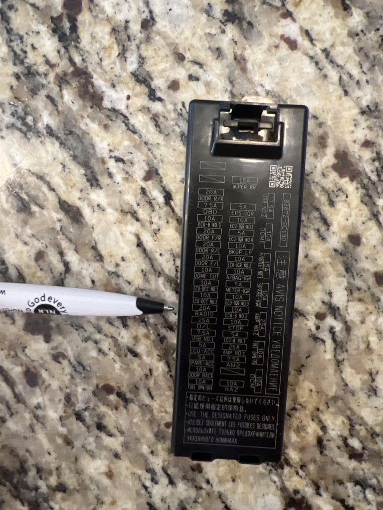

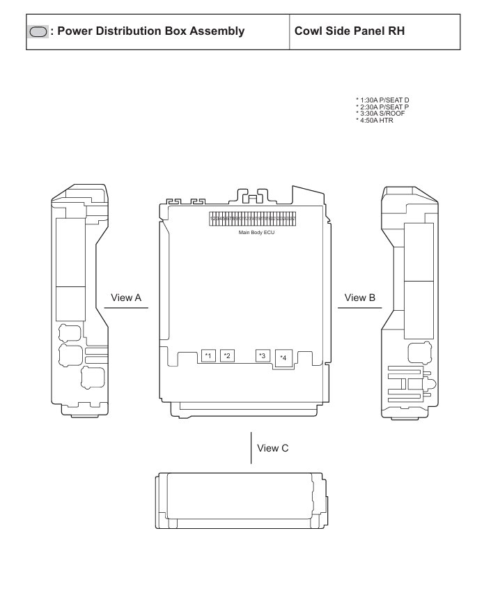

    After scratching my head for a day, simply because I couldn’t find the information online or in any one of the 5 manuals/pamplets that I received with my 23 Tundra Capstone (which I’ve run into a lot of confusing stuff bc I guess they weren’t that popular) I finally went out and located the 3-4 fuse boxes and pulled the panel off the 3 main ones to bring in the house.
    I seen someone mentioned having to be good at yoga to access the one under the dash. A good angle on an iPad sat in the floorboard will work just enough to at least discover the fuse box. (Passenger side on the 3rd gen.) If you have small enough fingers, the bottom plate under the glovebox can be popped off pretty easily.

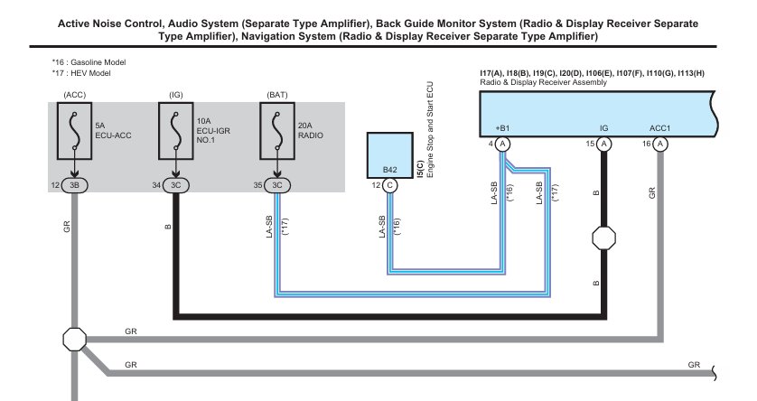

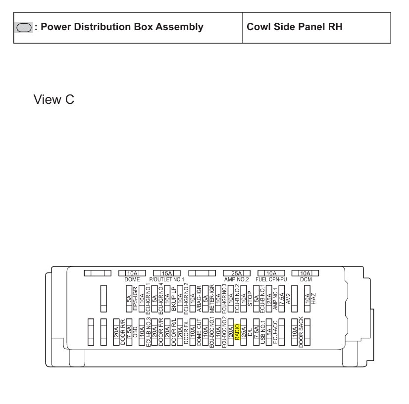

    My Multimedia screen was unresponsive to touch, radio wouldn’t come on, no media selection area on the dash, yet Cameras would show up on the screen.
    So if you get to looking for that Multimedia Screen Fuse, here she is!

    Question is...what caused the fuse to blow?
    1lowlife likes this.
  5. Feb 8, 2025 at 7:04 PM
    1lowlife
    May 4, 2016
    #3296
    10,655
    DADA
    THE GREAT STATE OF TEXAS
    2014 MGM DC SR5
    ^this.
    Did replacing the RADIO fuse fix the problem?
    Interesting that the camera worked when the HU didn't.:cool:
