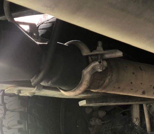

    Hey all,
    My exhaust clamp is loose and allows my tailpipe to rotate and droop heavily. Very corroded and rusted so replacement is only option.
    Will a saddle clamp work as a replacement?
    Does the exhaust clamp have a gasket? If so, can high temp RTV be used or is this just un necessary?
    Thanks in advance.

    That OEM clamp costs around $50 or more shipped.
    Exhaust Clamp (Rear) - Toyota (90461-15017)
    90461-15017 - Exhaust Clamp (Rear) - 2007-2020 Toyota | Sparks Parts
    You can find it cheaper on eBay, but the shipping brings it back up to $50.
    Here is one on Amazon for $40, but you better hurry, they only have 1 left..
    Amazon.com: TOYOTA 90461-15017 Exhaust Clamp : Automotive
    Something like this MIGHT work..
    Seems to be a flange clamp, not sure if you'd need a 2.5" or 3"...
    Amazon.com: EVIL ENERGY V Band Clamp for Flange Kit Stainless Steel (2.5 Inch) : Automotive
    This is the gasket needed...
    Fortunately, it is only around $5..
    Amazon.com: FEL-PRO 60461 Exhaust Pipe Gasket : Automotive
    I'd guess a saddle clamp wouldn't really work because the OEM clamp holds the 2 flanged pieces together...
