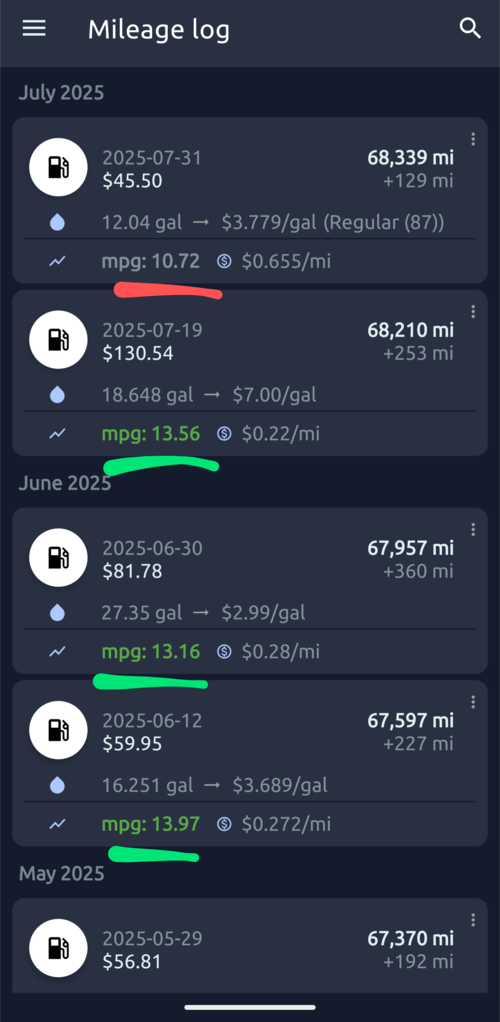

    Currently I'm seeing less MPG on the heads up display and also last fill up down by 2 mpgs manually calculated as well.
    Fluids serviced with drain and fill are transmission, front and rear diff and transfer case. Ravenol 75w-85 for rear and front diff and Ravenol 75w for transfer case. Toyota WS transmission fluid.
    Is this normal? Since I bought the truck I've been averaging at least 13 MPG. Last fill up was under 11 and I only drive half tank before filling it up.

    Odd. Anyways I'll just monitor it. Hopefully it gets back to the 13 average that I get driving City only.
    Maybe I was idling too much while doing all the service along with the coolant change. I don't know.

    Update. Last fill up is back to 13.59. all is good

    Typically with coolant change you idle alot to purge air. With these engines, even a slight increase in idling destroys mileage.

    That night be it. I was worried there for a bit, that I did something wrong.
