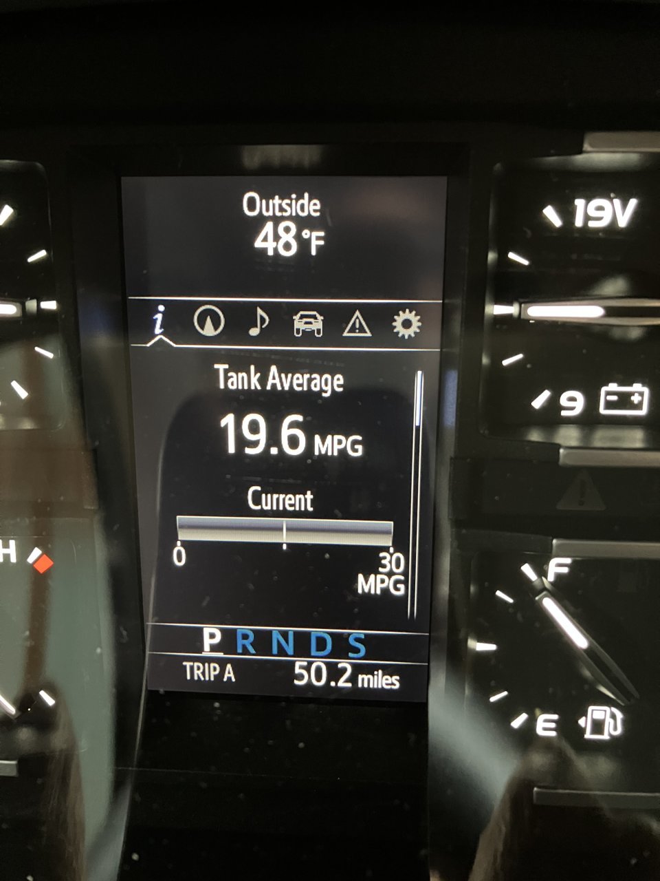

    Just filled truck up for the first time and drove it 50 miles. Looking forward to calculating mpg manually to see how accurate the truck computer is. The drive included a lot hills and some stop and go traffic.

    You hand calculated MPG will be 0.3-0.7 MPG lower than the computer reports after driving at least half a tank's worth.
