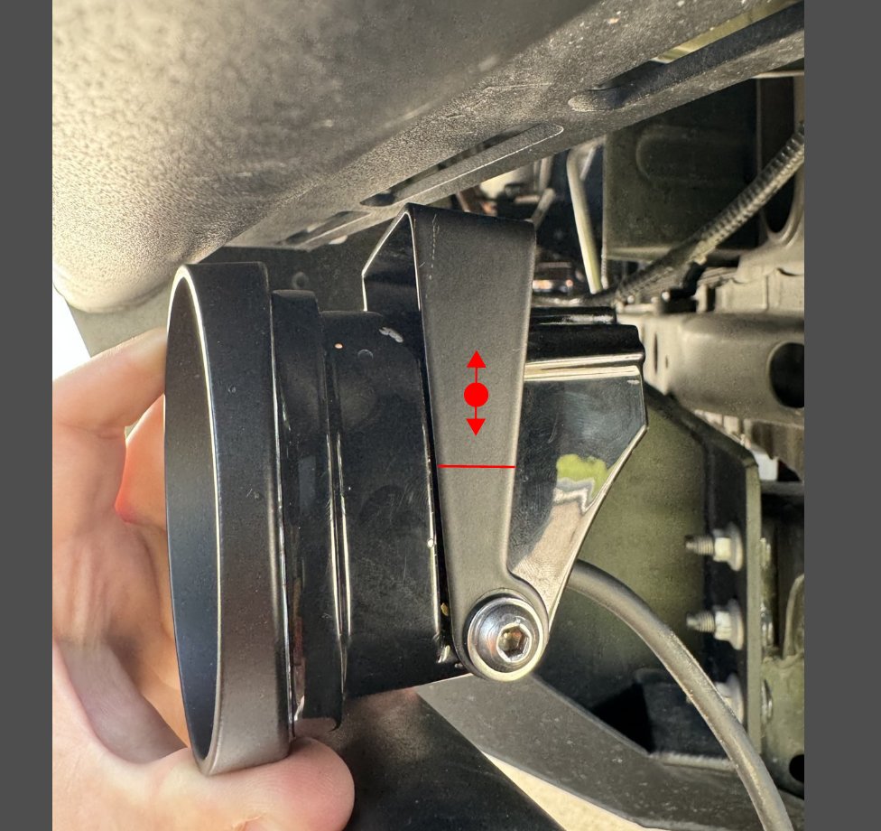

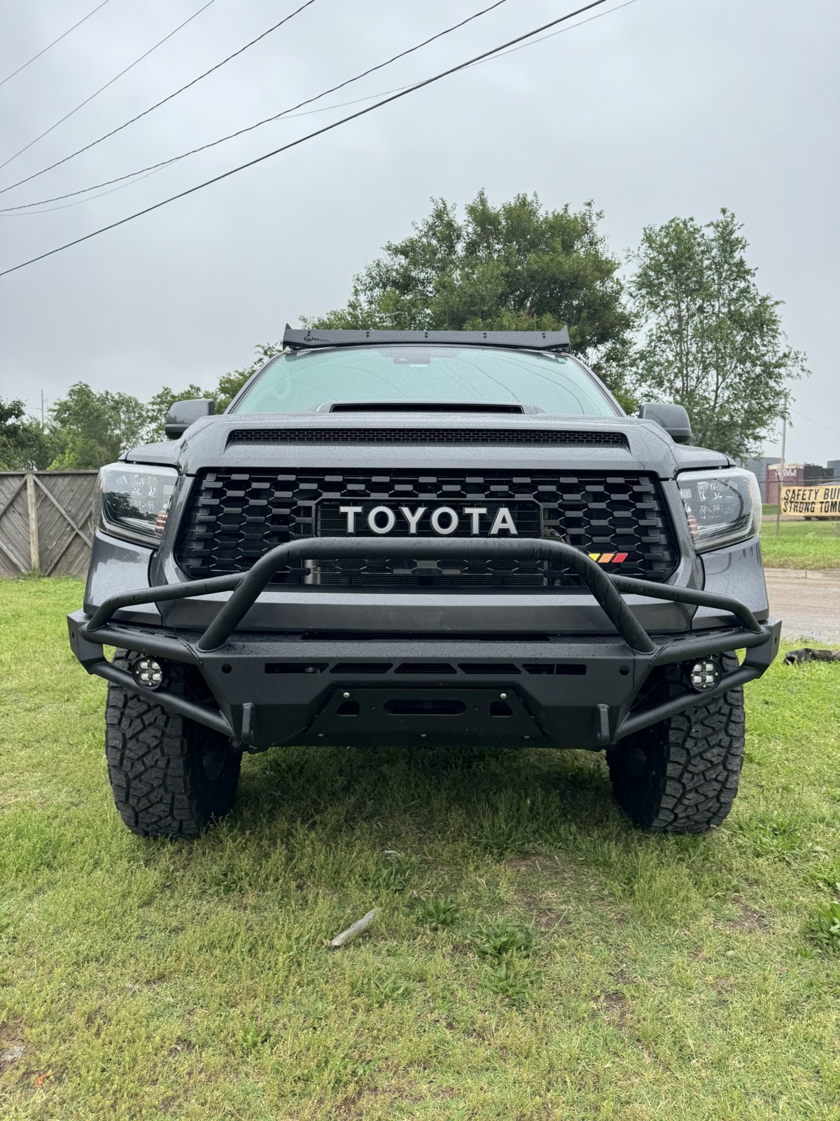

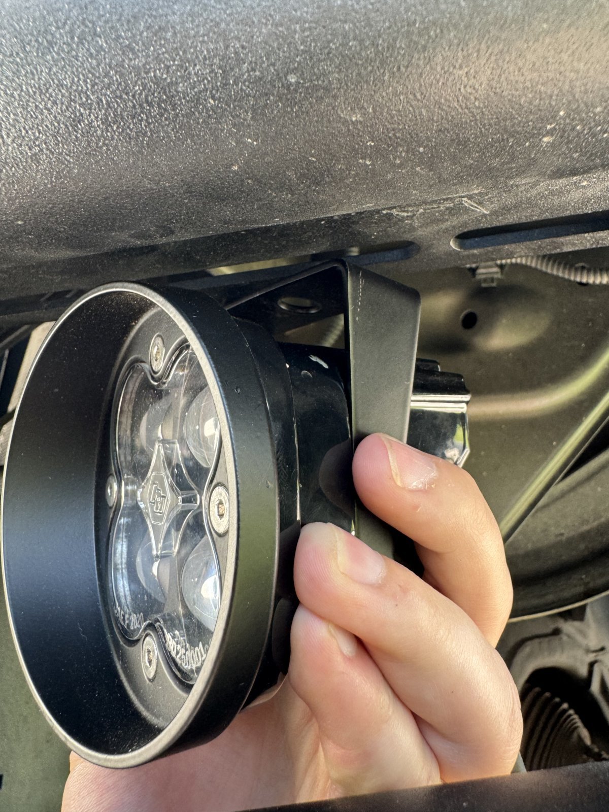

    I am trying to mount my Baja Designs Squadron-R fog lights to my CBI Baja Hybrid Bumper for my Tundra. Full transparency: this is the first time I am mounting lights to an aftermarket bumper and I have 0 experience with any of this.
    The brackets BD provide are too short and these XL 4x4TruckLED brackets I found are also too short (or too long if you flip them).
    I've been searching online for solutions, but I'm so novice that I don't think I'm searching for the right things.
    Suggestions, tutorials, resources, etc. would be great help!

    What if you flip the light so the bracket doesn’t go all the way across the light body? Hopefully that makes sense. The light can be oriented in the other direction you can flip the lens also if the logo not being up right bothers you etc.

    I thought that flipping the bracket would work, but didn't know the lens could flip too or I would have suggested it.

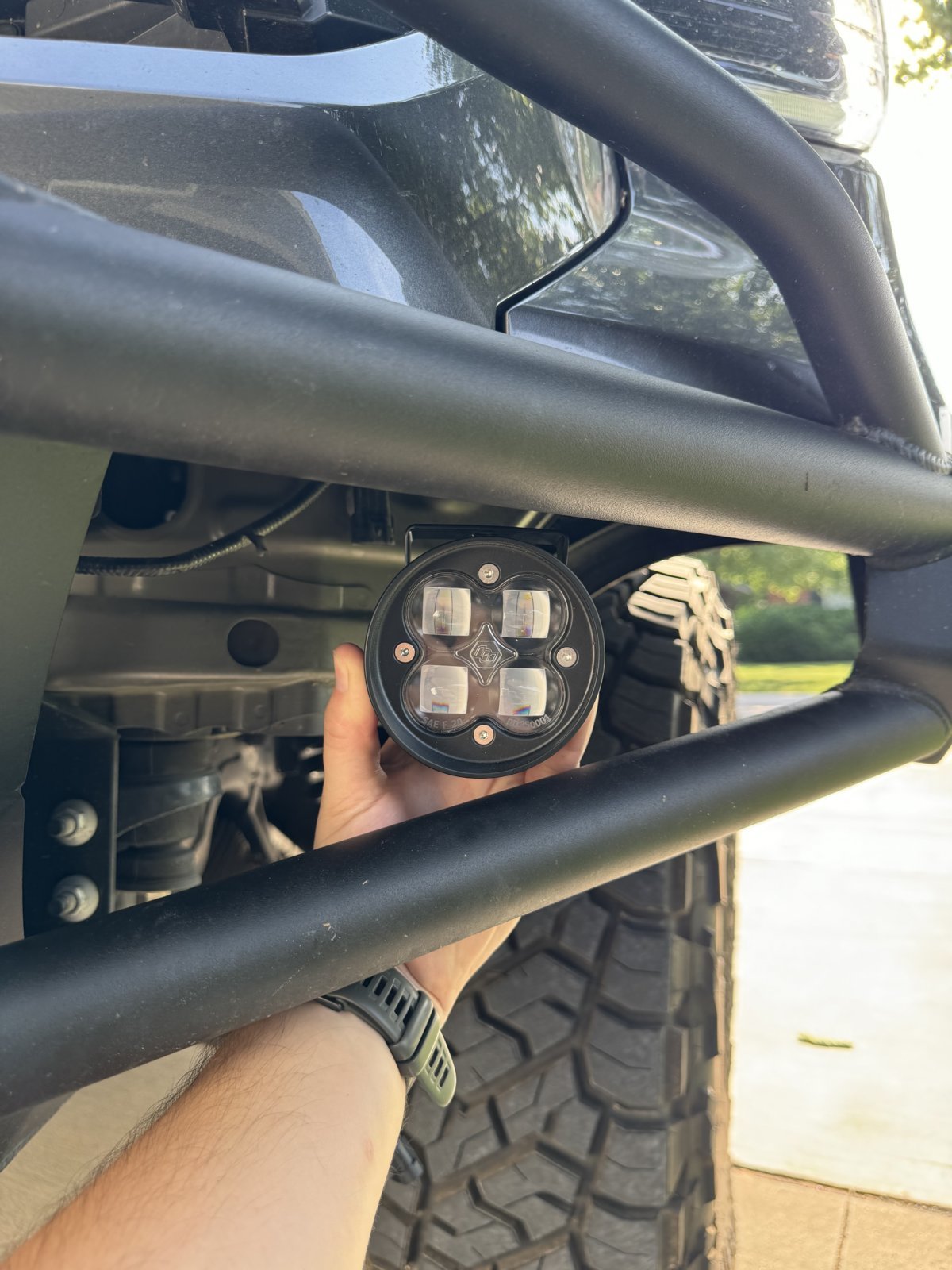

    Could just get a longer through-bolt, and then pick up a steel or aluminum spacer to close the gap :notsure:

    Just eyeballing it I think there would still need to be a bracket in between these two. The little silver ones would be in the same position demonstrated with the long one, and if you flip the long one then the light will be too low and hit the lower bar. I think, anyway.

    Looking at the pics hard to tell. But spacers might be need to clear that front tube

    Exactly the issue with the long one; once flipped, it's too long and hits the lower bar.

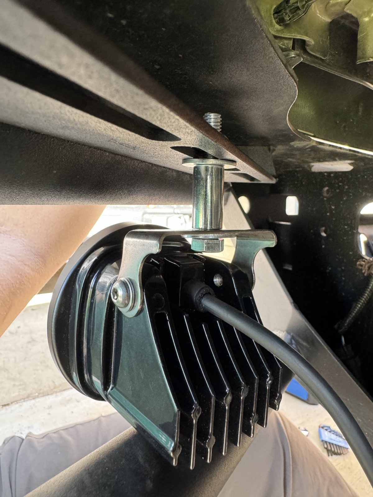

    Clearing the front tube is the issue! I'll go for spaces
    I'll try spacers and see how it fits! I was worried spacers might not be strong/stable enough, but it seems like that shouldn't be a concern?

    No concern there

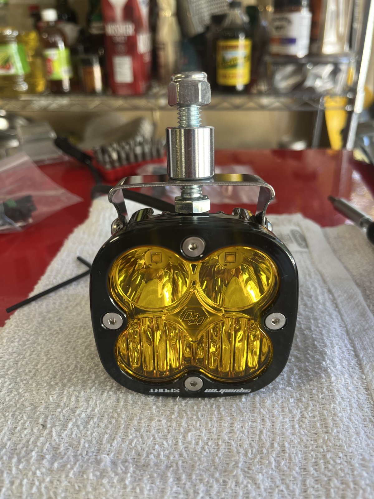

  19. May 22, 2024 at 4:12 PM
    jmladdy
    jmladdy [OP] New Member
    Sep 19, 2023
    #104176
    78
    Oklahoma
    2020 Tundra TRD Pro

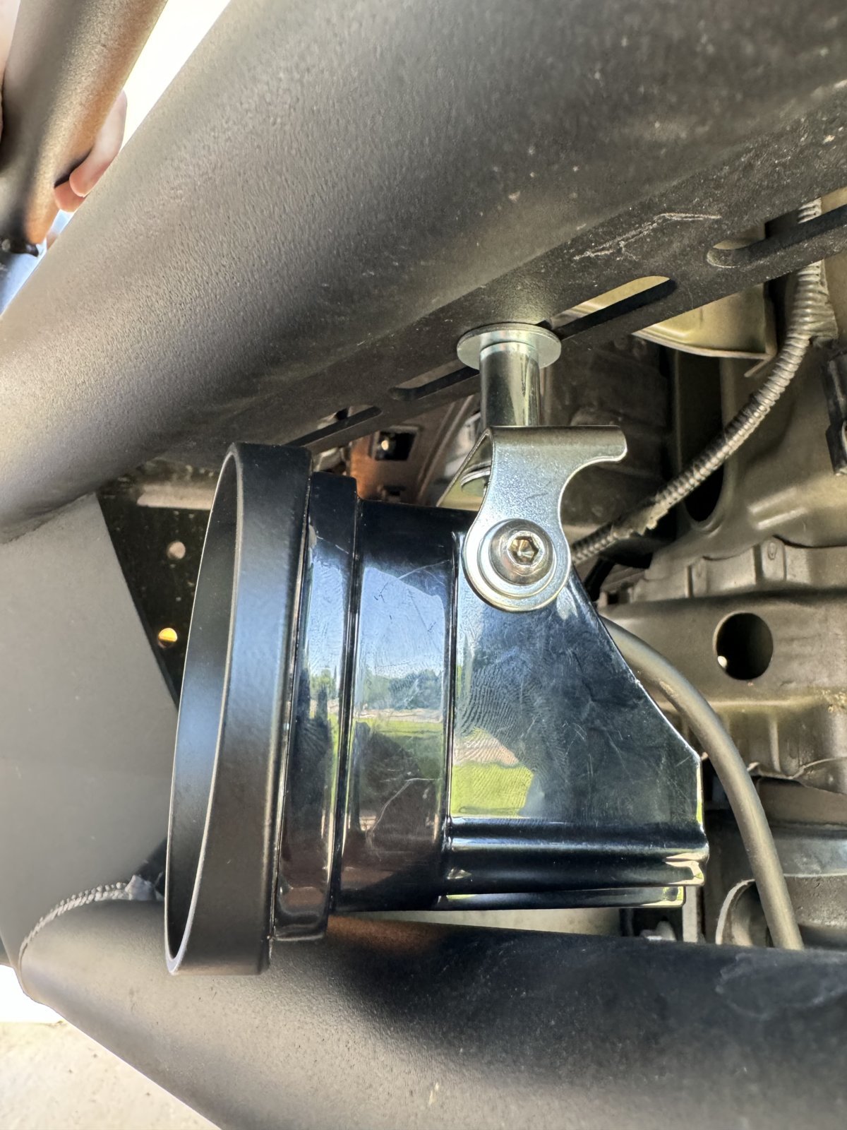

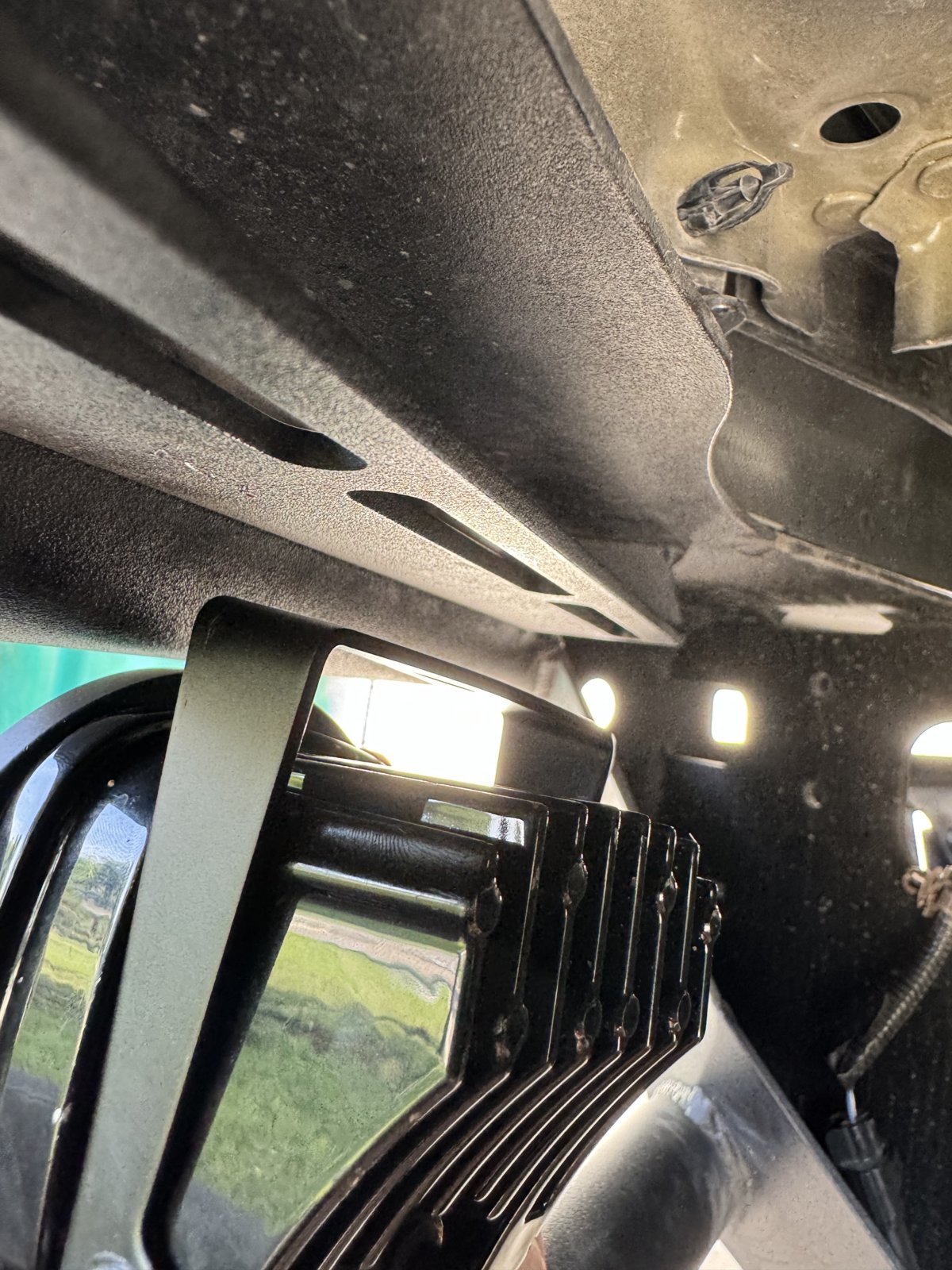

    Found the sweet spot. Is this the right idea? Secure enough?

    I agree the brackets are a little to short, but I still mounted my BD like that and I find it works good at night. I do like that spacer though. I might try that when I take my bumper off to re-powder coat or line-x (haven’t decided yet) this summer.

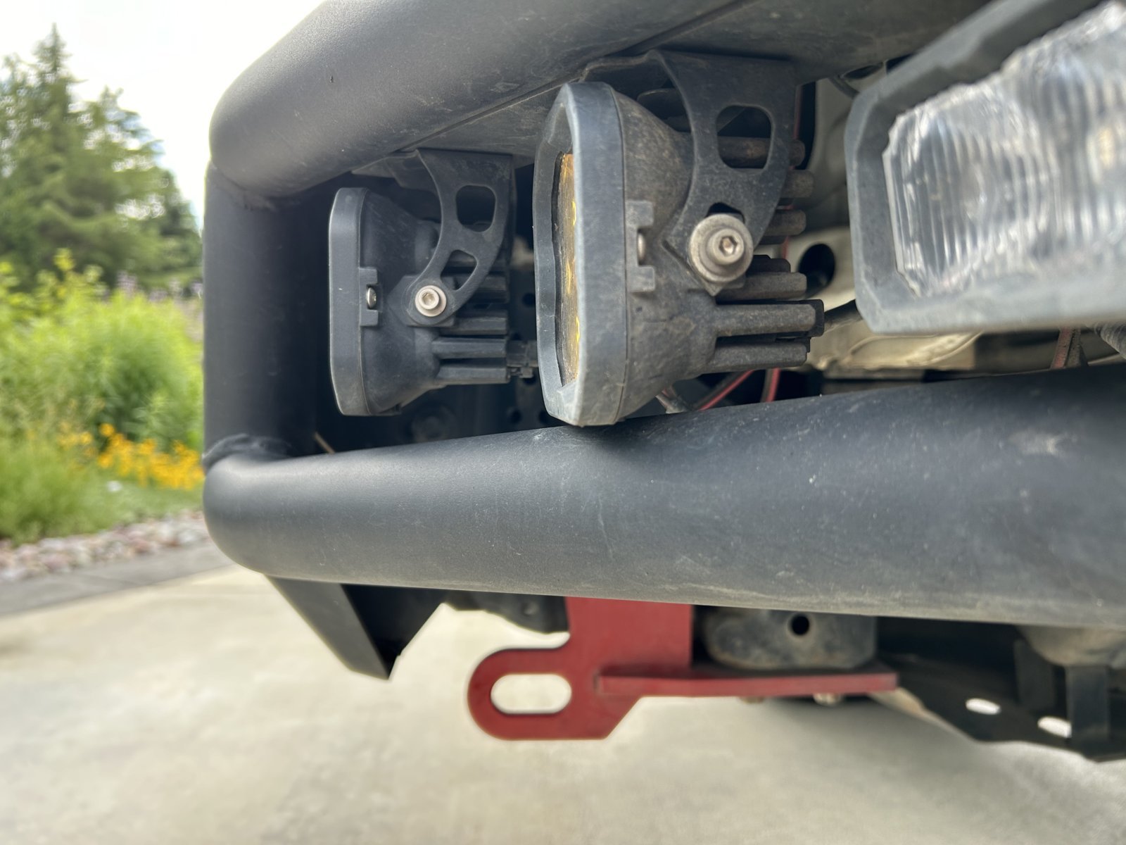

    Since you have the longer brackets, personally I would bolt those up to the bumper flip the light, and determine where you would need the screw hole to be for your ideal light placement, then drill a new hole in the long brackets. The spacer method that you have also should work just fine. Like Rey said you gotta tweak till you like the result. I can also grab a picture of my truck since I did something very similar to make a fog light fit.

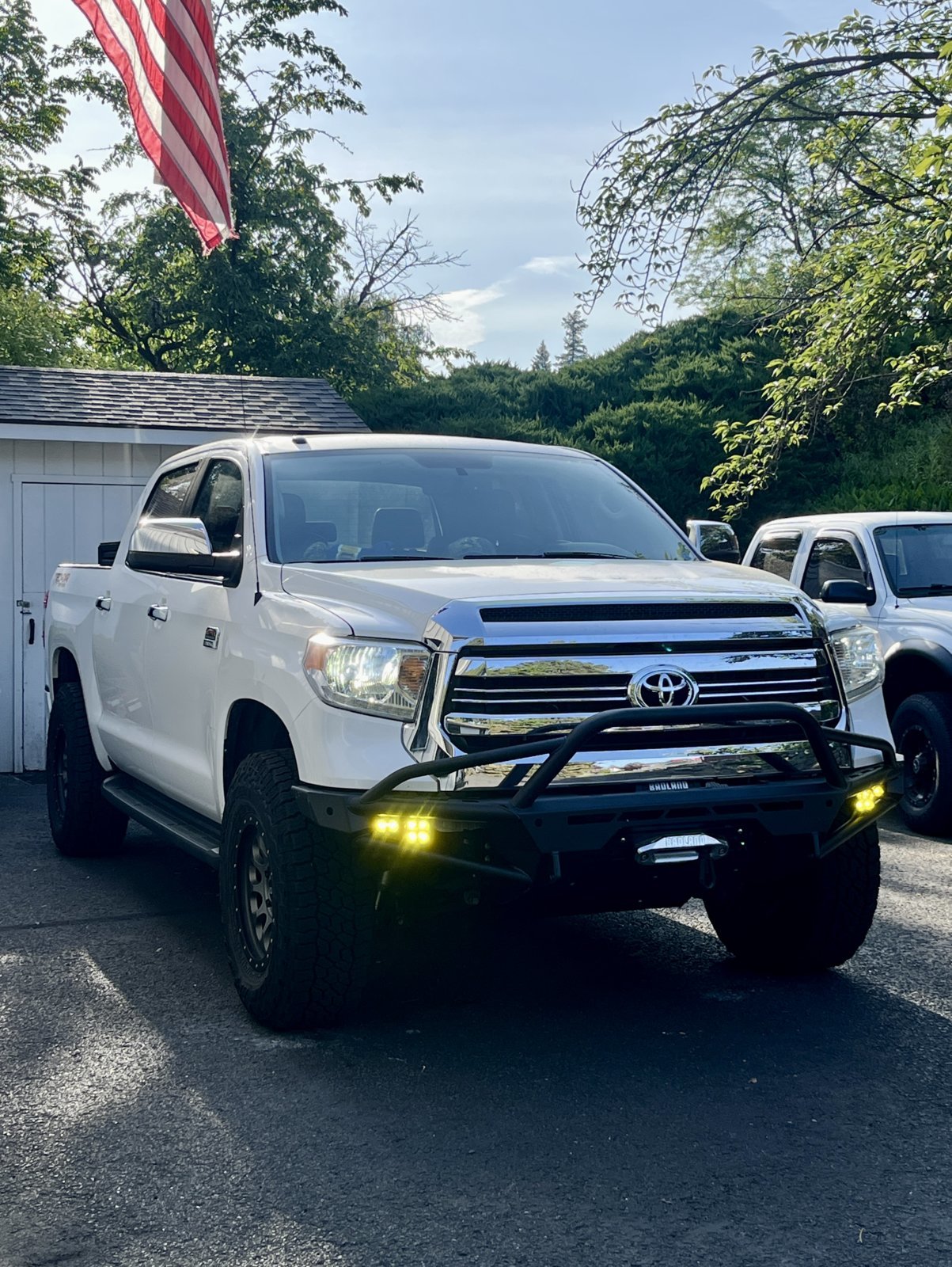

  22. May 22, 2024 at 5:37 PM
    APalmTree
    APalmTree Sometimes helpful
    Feb 23, 2020
    #43054
    825
    Brandon
    SW Washington
    2012 TRD Offroad White Crewmax 5.7L
    A few... Definitely more than 2
    Here is the modification I made. I was hitting the bottom tube with the SAE fog light which was not allowing me to angle it far enough down. So I cut the bracket and moved the bolt up. It is damn near impossible to tell from the front unless you are sitting exactly level with the front bumper.

    Exactly what I ended up doing, but with washers between bolt/bracket and spacer/bumper. What size bolt is that?

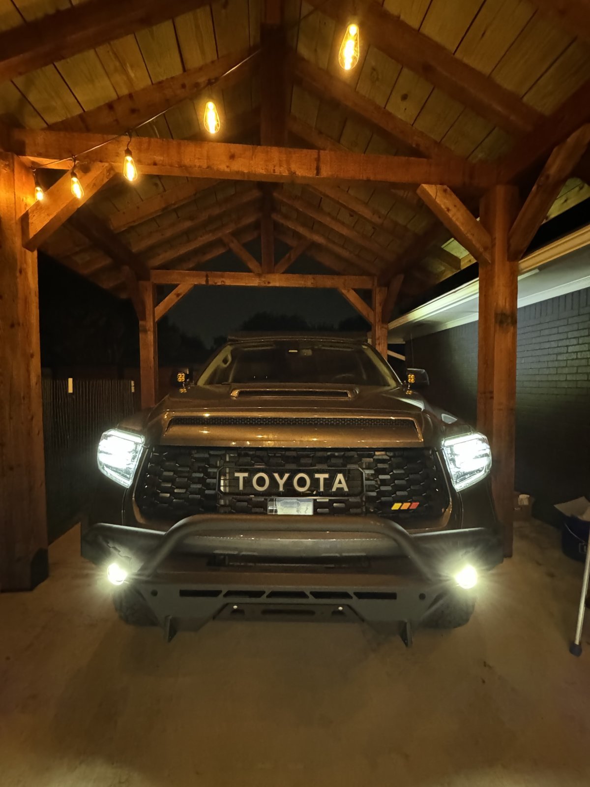

    Great success! (Borat voice)

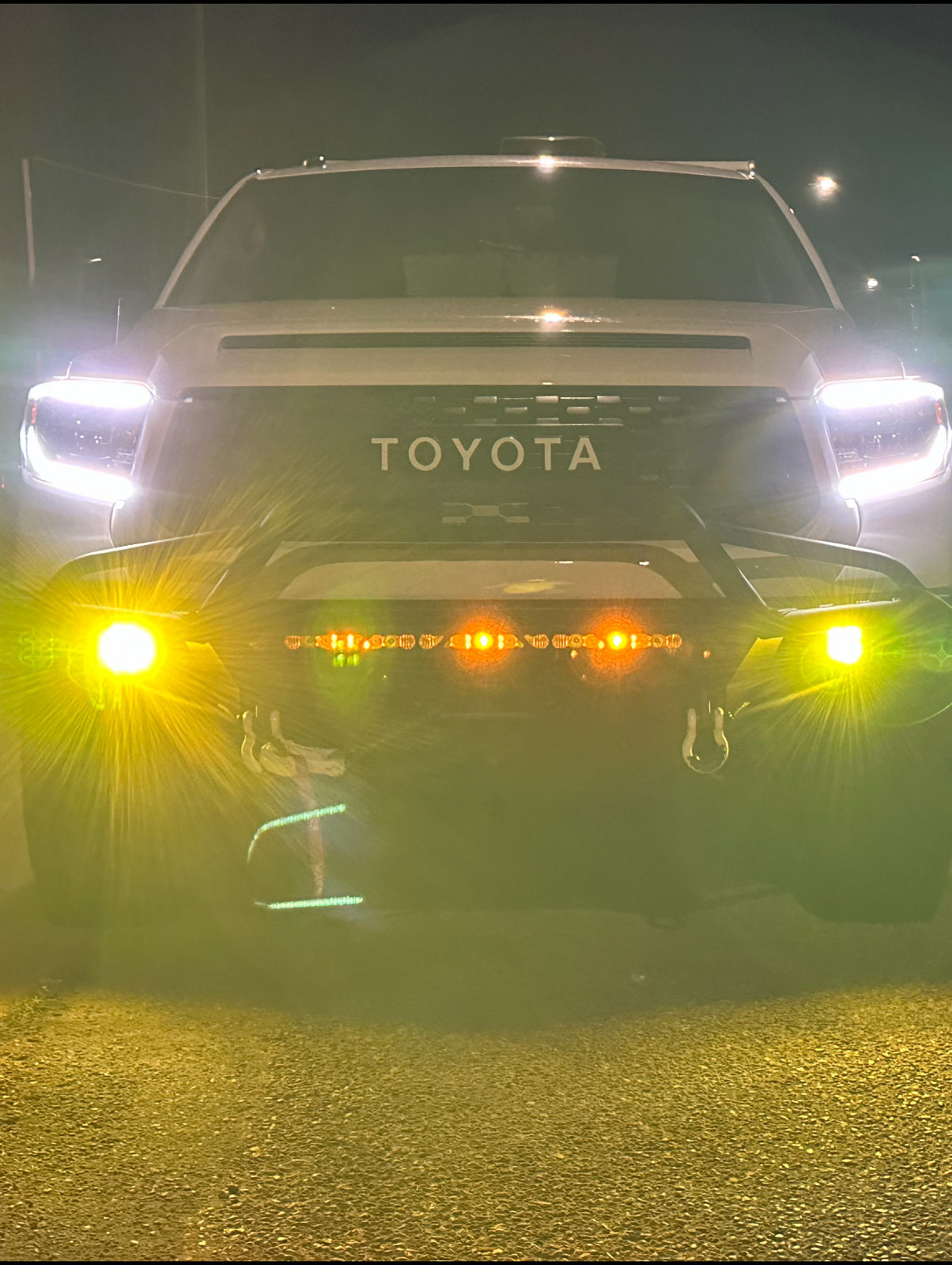

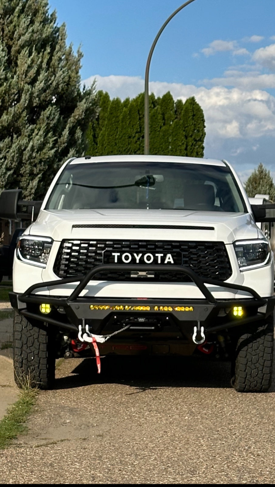

    IMG_2203.jpg Good start but you’ve got a lot of room for more lights!
