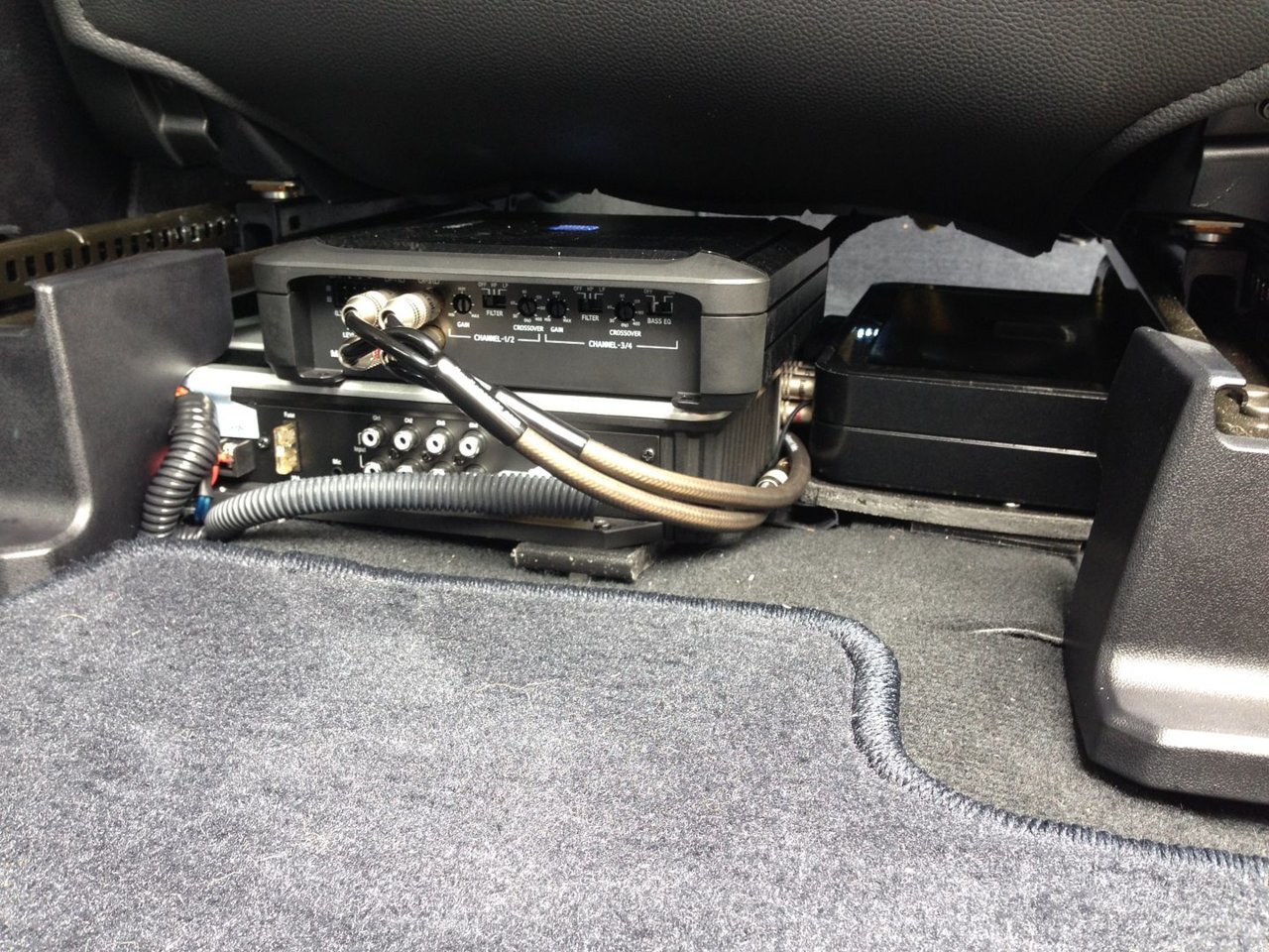

    I have 1 JL Hd900/5 under each front seat (2 total) and a helix dsp pro mk2 under the drivers seat. Its quite a lot of wiring crossing over the console. If you are only running 1 sub then there would be room behind the rear seats, but i'm running dual 10's and there is no room for amps/dsp.
    I ended up using a piece of mdf with feet to keep it level and a place for the under seat vent's air to go. Others have used a piece of thick plastic/acrylic

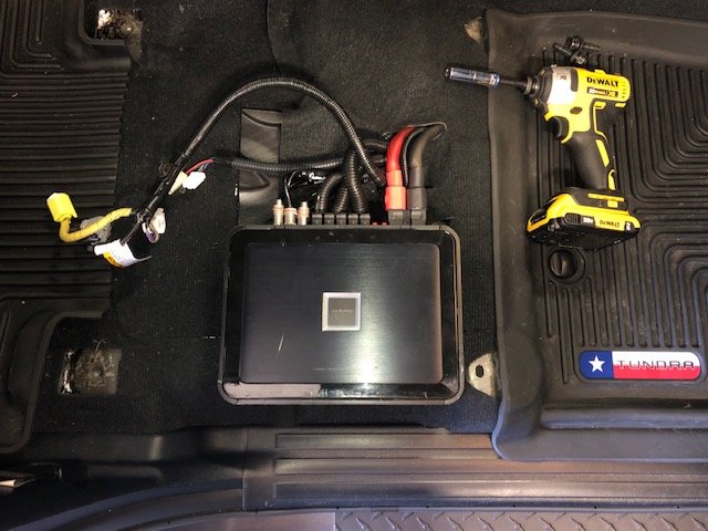

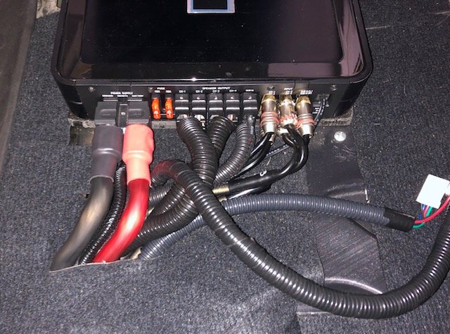

    I put my 5 channel Alpine PDX V9 under the passenger seat.
    Made my own mount out of a cutting board..
    What I have under the seat now..
    r7df2zr7_zpscoegh5fw_e14e4e071c704d230b554daebfcc38c675bc6089.jpggvap7jp5_zps2iu2ff0k_d96cfe3ea84a9c27a2f9bef8710842f8f3a4af4f.jpg

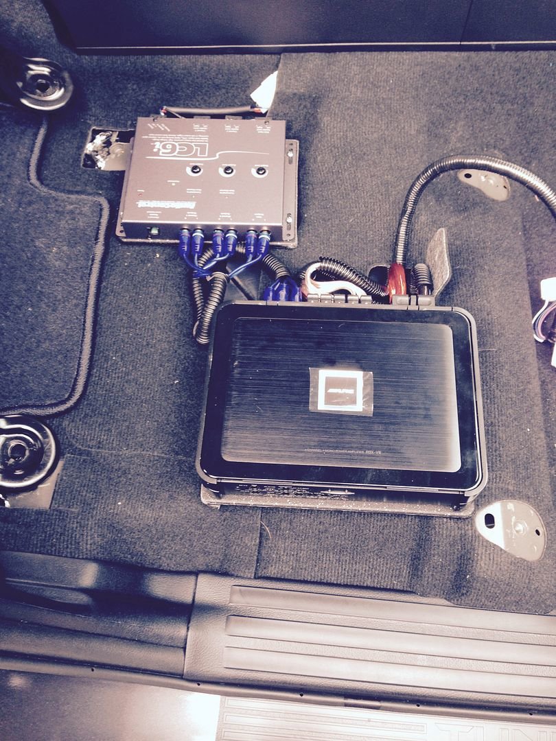

    First had it with an AC LC6i LOC, but it didn't sound good.
    BE6B57D8-87BC-43E9-AF1D-86C29B946A8E_zps_c84b0af3a64f1da9aae96f83c54f345cd243be63.jpg

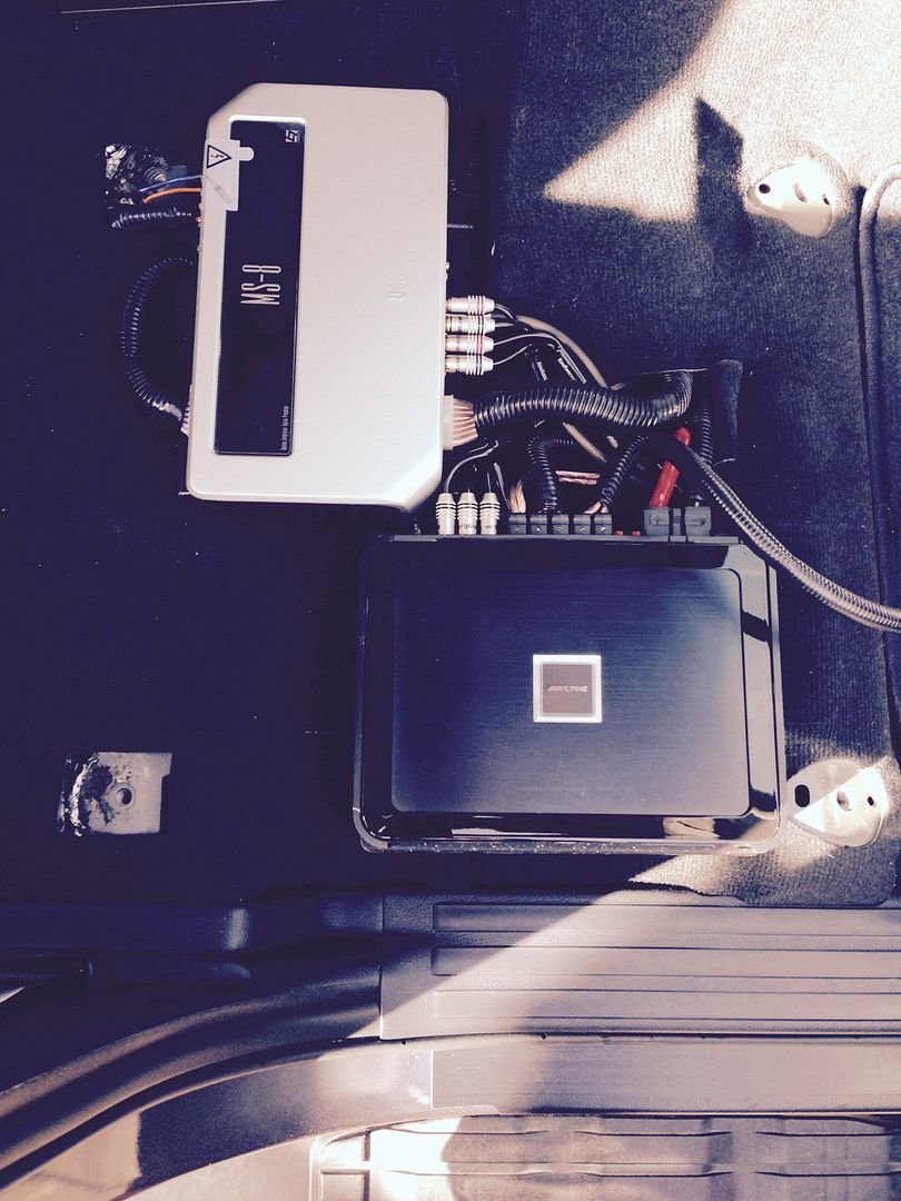

    I had it with my JBL MS-8 but could never a decent calibration so I ditched the stock Entune HU for a Kenwood HU.
    Had the front door focals bi-amped with the 5 channel and another amp for the rear doors and bridged center dash speaker.

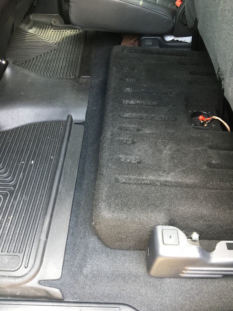

    Running a twin 10" Stealthbox under the seat of my DC.
    Very happy with it since I fixed the wiring issue I had..
