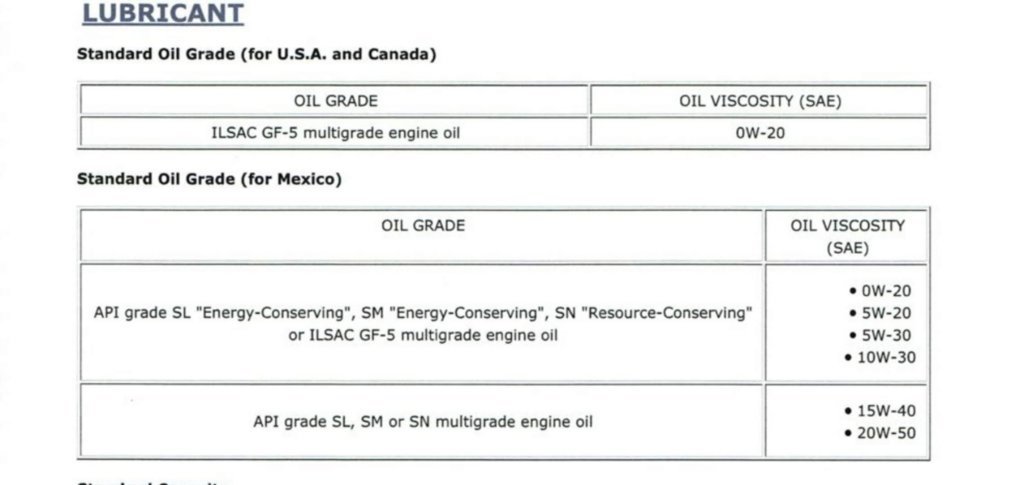

    It echoes what most on here and myself believe, which is the choice to spec 0w20 in the 3UR is related to CAFE regs, not longevity.
    This is from the factory service manual for our trucks with the 3UR, just like the US spec 200 series 'cruisers. And no the engines are not different for Mexico.
    While the reduction in valvetrain noise is a nice benefit of heavier oil, its important to note two things.
    1) There is no evidence to suggest that the increased noise from using 0w20 is meaningful in terms of engine life or engine wear.
    2) There are at least two 3UR powered Tundras that have gone over 900K miles on 0w20.

    Fortunately for us, the Toyota engineers have told us (via the FSM) that running up to 20W50 is fine in these engines.

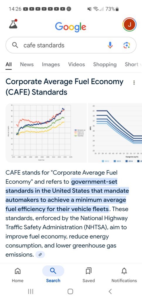

    Buddy, calm down. No one said I think the Government runs Toyota. What the government does do is sets standards that auto manufacturers need to comply with. I also didn't say 0w20 wasn't safe to use either. What I am pointing out is the the same exact vehicle in Mexico according to Toyota can run a bunch of different viscosity oils, not just 0w20. Would you care to explain why if it's not due the the CAFE standards? 0w20 will produce better MPG because it has a lower viscosity, 0w20 will also cause wear faster than a high viscosity oil. The 3UR can run 20w50 according to Toyota, as long as the environment calls for it. Instead of yelling on a forum just do some research. Here is some screen shots to get you started, one is Toyotas TIS systems oil recommendations for oil and the other is what CAFE standards are. The CAFE standards get stricter as time goes on, that's why Toyota no longer has a V8 in the US and also has more hybrids. Don't you think Toyota would love to sell the new series 70 Land cruiser here in the states? But it only has a V8 or a diesel.

    Sir I think you have no idea how the CAFE standards work. One vehicle does not meet or not meet the standards. It is the manufacturers entire fleet, so Toyota could have a V8 Tundra in its fleet since it has the Prius and other small hybrid models to offset it. The entire fleet needs to meet a certain MPG total. So if Toyota can shave .5mpg off by running 0w20 it's worth it but it's definitely not the best oil for protection, just the best oil to get the best mpg, do you think 0w16 oil exists to help protect engines? The majority of people have no need for the cold starting flow of 0w20 unless maybe you are in Alaska. Project farm did a test recently that shows 5w30 will provide better protection over 0w20. I could care less what people put in their truck, I just try to put the facts out there for people to see, 0w20 is not the only oil that Toyota specs for the 5.7, it's just the only oil spec for the USA and Canada. Everywhere else in the world the Land Cruiser with the same engine can run all those different viscosities that the Mexican Tundra can.
