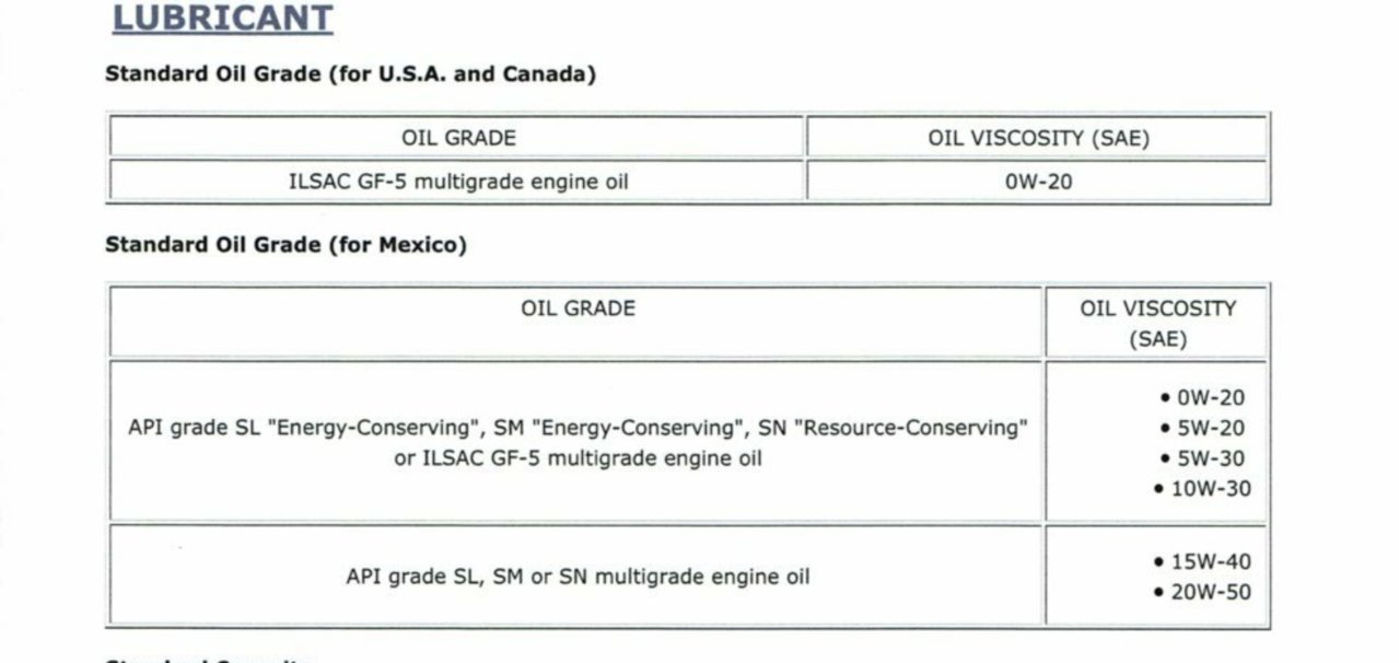

    Incase anyone is wondering these are all the approved oils per Toyota. Notice Mexico has many more choices although its the same exact engine. Proving that 0w20 is only due to the EPAs CAFE standards.
