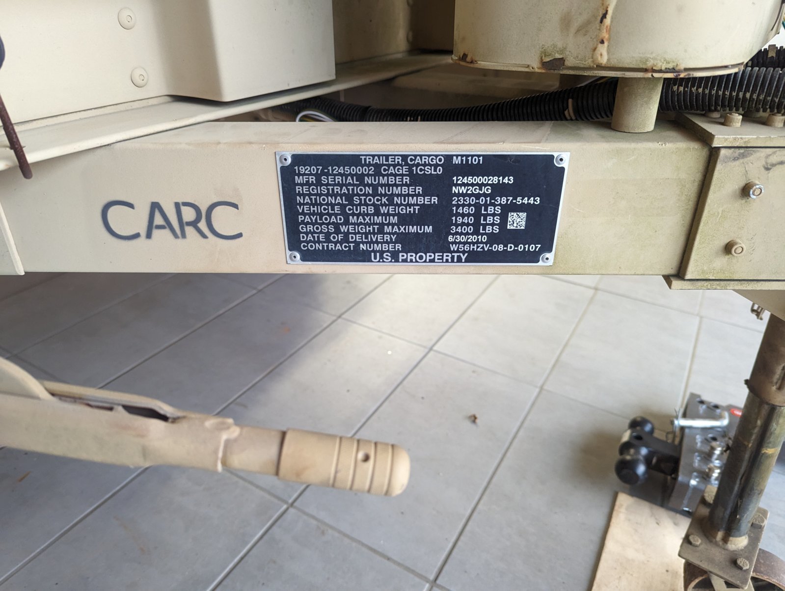

    Trailer Purchase Info
    For anyone interested in going down this road, here's the process it took to get the trailer.
    These are up for auction on GovPlanet.com all the time. Bidding is as simple as signing up for an account and placing a max bid like EBay. When I was looking bidding started at $500 for one with a bed, and $125 for an empty trailer chassis. I opted for the bed version. Watching the auctions for a couple weeks, I saw winning bids of anywhere from $650-$2400 depending on how many trailers were at the auction location and what condition they appeared to be in. On a whim, I shot a bid on one in North Carolina for $800 and ended up getting winning it. Based on the pictures, it appeared to be in good condition and I noticed 10-22 written on the hub grease covers. I assumed this was the last time the trailer had PMs. Total cost for the trailer ended up being ~$1300 after factoring in sales tax, buyer's premium and doc fees.
    GovPlanet offers a few different documentation options including an SF97 and a full title. From what I gather, the SF97 is a fairly simple bill of sale and some states will accept that as proof of ownership and grant you a title. Illinois is not one of those states, so I had to go with the full title (+$200) option. The title they obtained for me was a Montana title and took about 90 days to receive after the end of the auction.

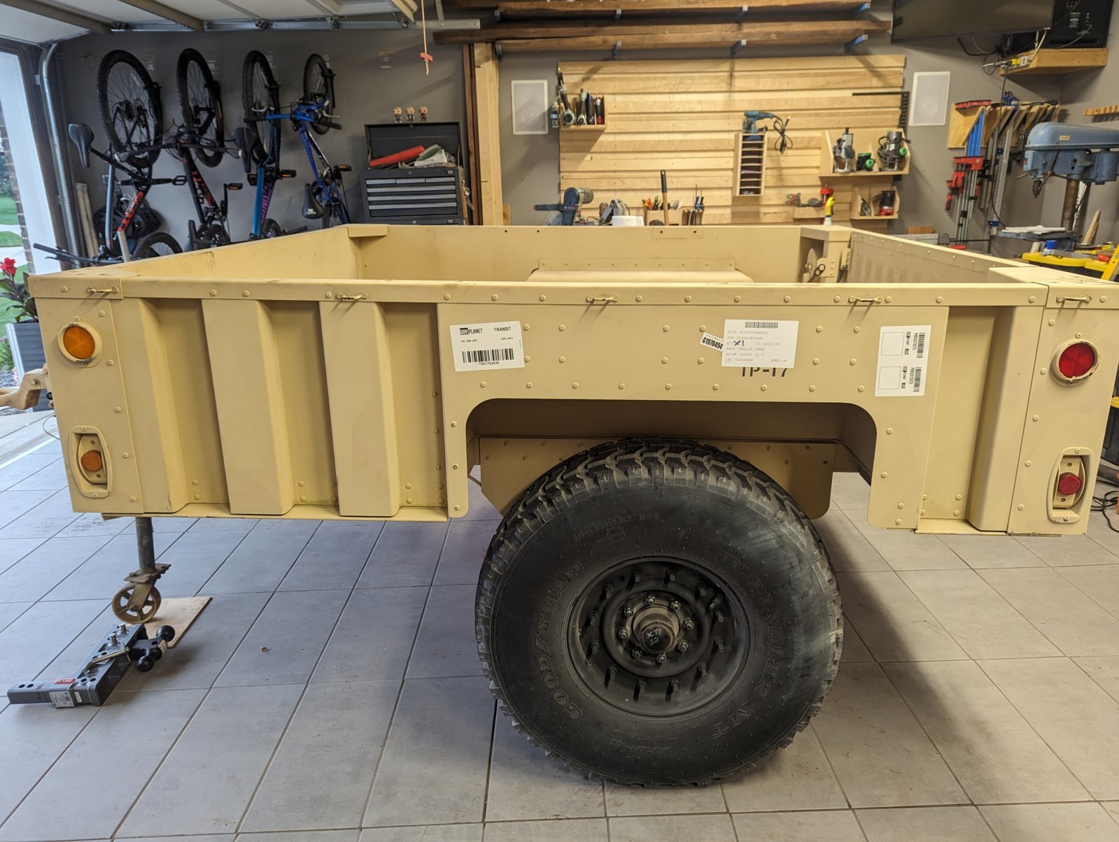

    Prepping for the return
    There's a bunch of great resources on other forums from guys who have picked up these trailers. What I gathered from pouring over post after post is that there are a few primary areas of concern. I found a great spot in the shade of a large trailer and got to work. I always keep a thick blanket in the truck, and it was clutch in being able to work comfortably on the crushed rock surface of the yard.
    1. Axle nut torque: I read a number of posts from people who had issues with their hubs getting really hot after driving at highway speeds. This seems to be due to the axle nuts being over-torqued. To solve this issue, I removed the grease caps on the hubs and checked for appropriate torque. Wheels do not need to be removed for this and the caps came off with a flat screwdriver. The grease was extremely clean and fresh, so it looks like that 10/22 written on the covers must have been the last PM date. Axle nut is held in with a cotter pin and requires a 1 1/2" socket. Torque spec in the manual is 147 ft-lbs but everything I read said this was way too much and what causes the overheating. My mechanic at work agreed and advised that they should be just past hand tight to avoid overloading the bearings.
    2. Stuck brakes: This trailer has surge brakes with a level operated parking brake for each wheel. I checked for sticky brakes by jacking up the trailer and spinning the wheels. Both spun freely. No tools required, and the trailer can be jacked high enough to do this by lowering the trailer jack wheel all the way down, setting the rear stabilizers on their highest setting and then cranking the trailer jack back up.
    3. Tire condition: Many of these trailers have never really been on the road, so tread depth is great, but the tires may have been sitting in the sun for 10+ years. The trailer I purchased was a 2010, and the date code on the tires indicated they were from 2010, but they had no wear, no cracking or rot and appeared to be in great condition. Only issue was they were a little low on air.
    4. Lights: This one got me, as I read all about these trailers for sale that had been "Converted to 12v" like it was some kind of big thing. It isn't. You literally need a length of 4 wire trailer cable and some blue bullet connectors to rewire it. There's a lovely junction box on the underside of the trailer near the tongue where you can unplug the wiring going from the light to the military connector and plug it into the 4 wire. Tail light disassembly is a cinch, just a couple of screws and the cover comes off. Replace the 24v bulbs with 12v #1156 and #67 bulbs and off you go. See this website for more info.
    5. Chains: Allegedly some of the trailers have chains that have come up short, so I did purchase some extra chain to lengthen them if needed, but I was able to connect the trailer without them.
    6. Trailer Cover: I had no interest in driving with the giant sail over a cover on the trailer, nor was I going to use it in this build. The cover is held on with plastic buckles, many of which were broken and came off with east. The cover ribs are bolted in, and disassembly was quick. The parts were strapped to the trailer bed and eventually disposed of.
    7. Temp plate: Initially I was concerned that I might need a temporary plate on this thing to drive it home, but every police officer I talked to stated it wouldn't be an issue as long as I had proof I just purchased it and was in transit home.

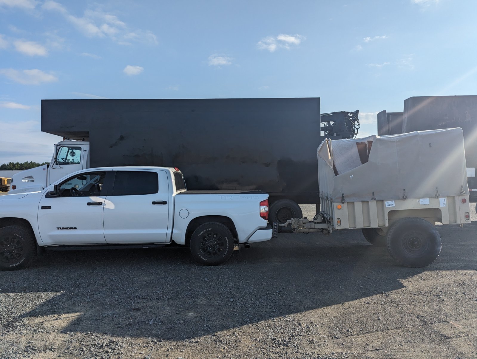

    Return Trip
    First of all, this thing is tall. Like, way tall. The ground clearance is ridiculous. It has a lunette ring, not a ball receiver, so I needed an appropriate hitch. I opted for this Gen-Y Hitch in a 5 position configuration as it can be run as a drop or a rise and it got me really close to level.
    I drove around the town I picked it up in for about half an hour before starting the return trip home just to make sure everything was kosher. From there I stopped after an hour of highway speed driving to check the hubs. Nice and cool. Tires were holding air pressure just fine, so I extended my check stops to every three hours.
    The Tundra had no issues towing the trailer, but it certainly isn't aerodynamic. There was some noticeable drag and around a 3 mpg drop for the return trip.
    Additionally, the trailer unloaded was super bouncy. I ended up stopping at a home depot and buying 350# of play sand (cheapest weight there) to help out. It improved the ride quite a bit.
    800 miles and 13 hours later I was home with the trailer. No real issues to speak of.

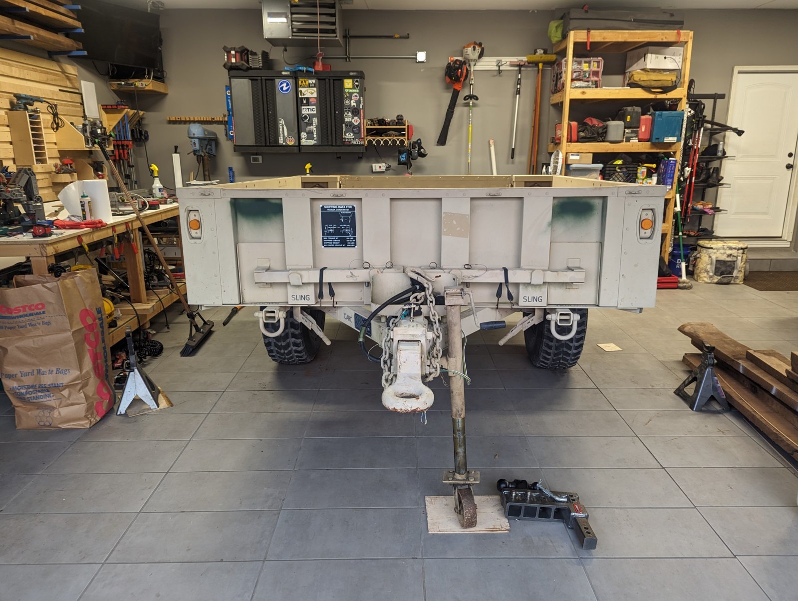

    I want to get the trailer rack built, tent, awning and fridge mounted and see where that gets me. I'll run it for a year pretty basic and get a feel for just how far I need to take this thing. I'm used to camping out of a couple plastic totes, so I'll start with strapping those down and figuring it out.
    Trailer Build Plan
    CVT Pioneer Denali RTT (deploys to passenger side)
    Custom Rack built by local fab shop to mimic NTD Racing B.O.B build
    NewAir 115qt Electric cooler with sliding mount
    Driver side awning
    100ah lithum battery and charging solution
    4 bike mounts (maybe switch this to truck bed mounted rails. Unsure)
    Replace wheels for height reduction and weight savings
    BillyB and TOYOTARIG like this.

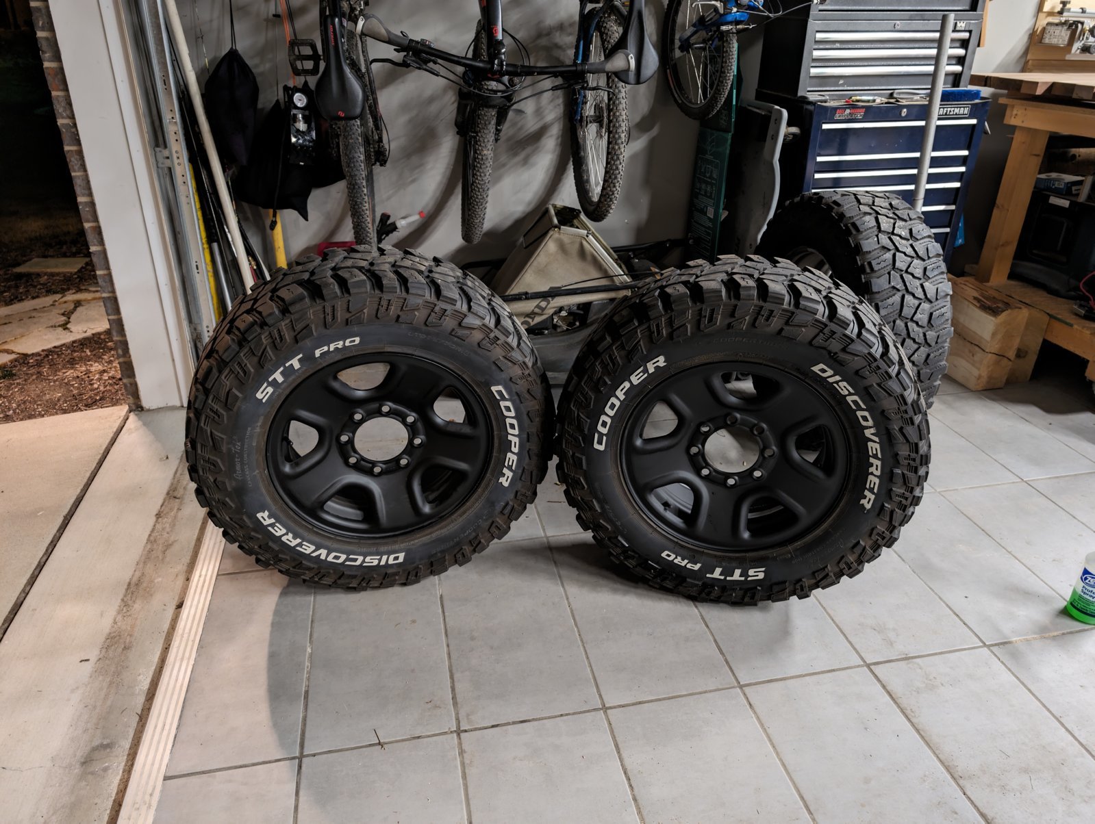

    Just got the trailer wheels back from the powder coater and tires mounted.
