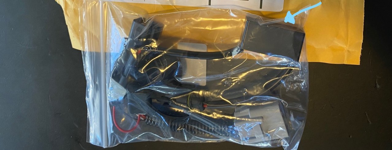

  6. Dec 14, 2020 at 1:29 PM
    GasGuzzler
    GasGuzzler New Member
    Jun 2, 2019
    #31357
    170
    Dan
    2019 Tundra
    6” Readylift AMP Research Power Step Sides Fuel Grenade wheels Toto Tire Complete Stereo Overhaul
    FYI, this issue started after about 6-7 months of having the headlights. I assume it has something to do with the resisters being used in the harnesses as the new harness has a much larger inline resister. InkedHeadlight harness_LI.jpg

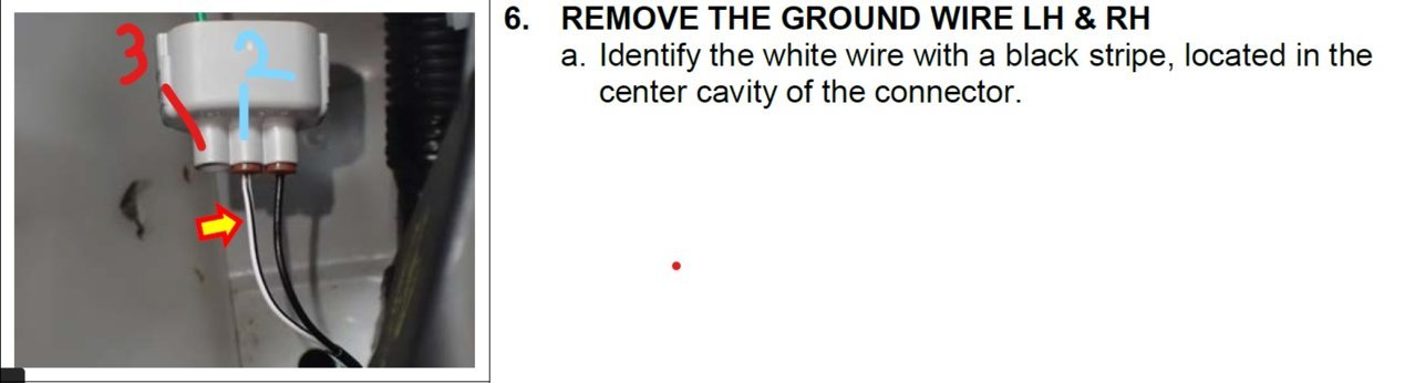

  10. Dec 22, 2020 at 1:21 PM
    GasGuzzler
    Jun 2, 2019
    #31357
    170
    Dan
    2019 Tundra
    Just a quick Update. If you have a 2018 or newer with these headlights DO NOT allow the dealer to do the Indicator recall. This consists of moving the the grounding pin (White/black wire) on the truck side (Park light) harness from the position 2 to position 3. If this recall is done it will blow the fuse for the park lights.
