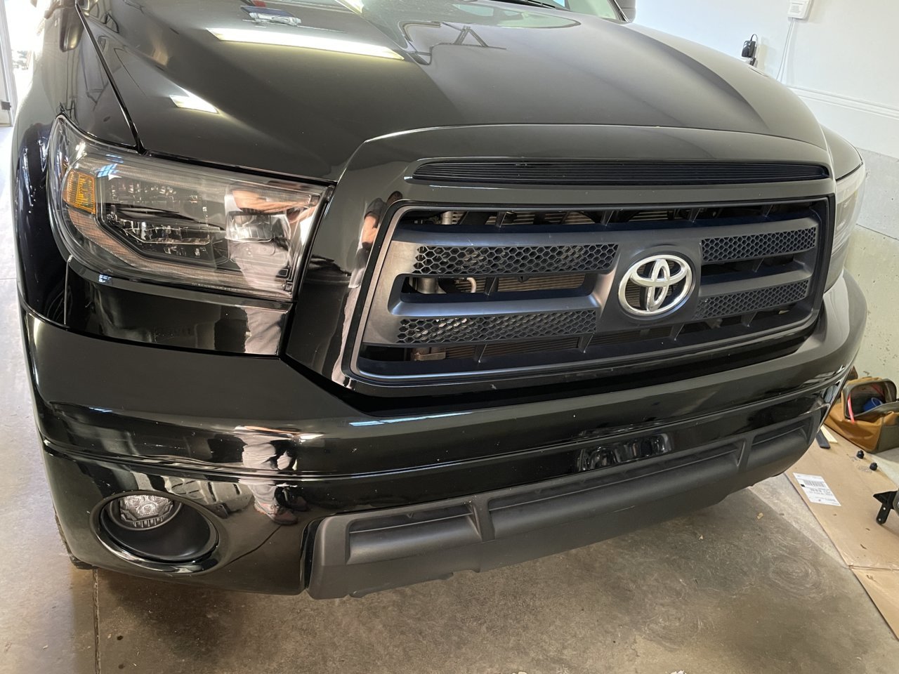

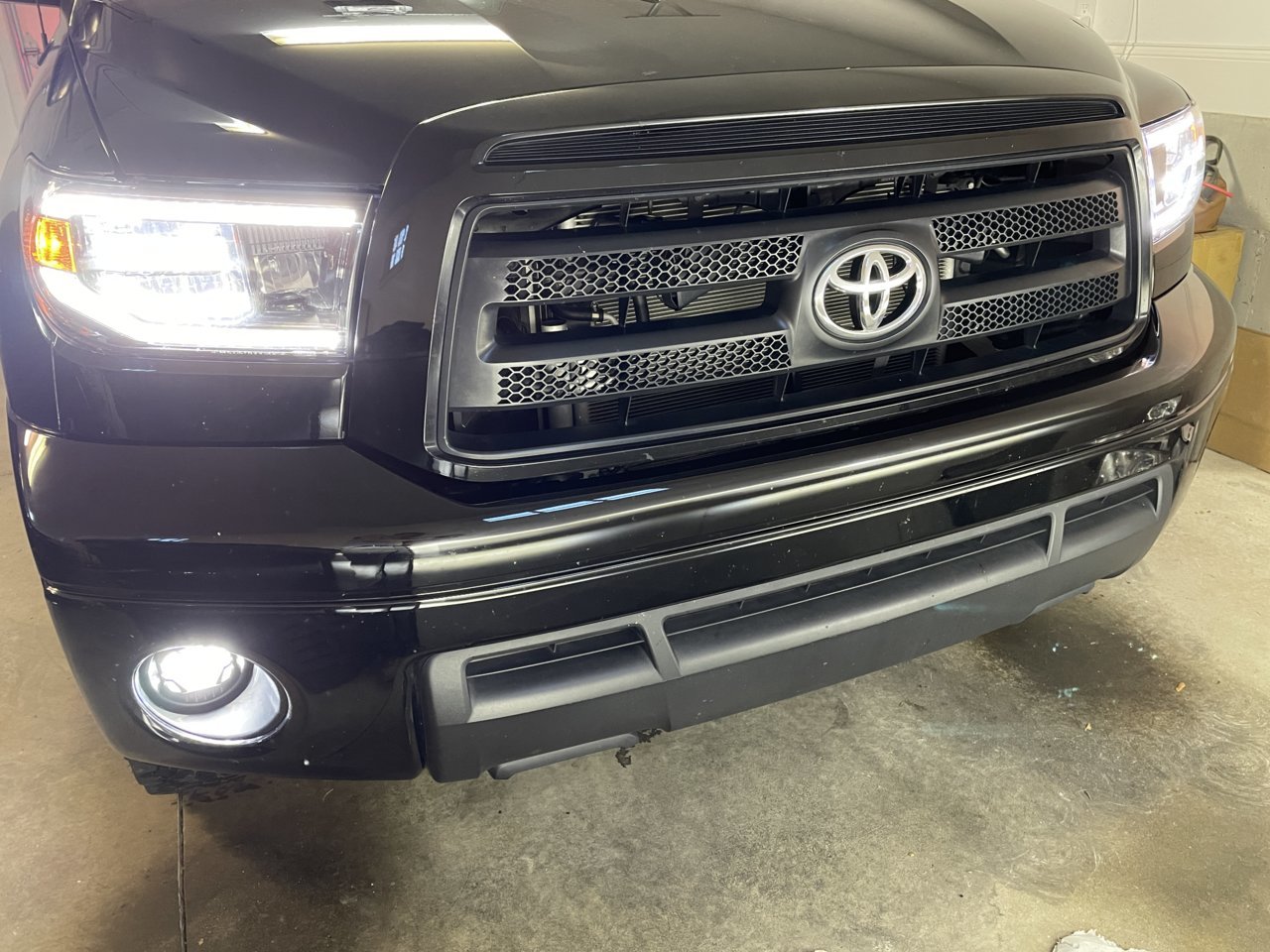

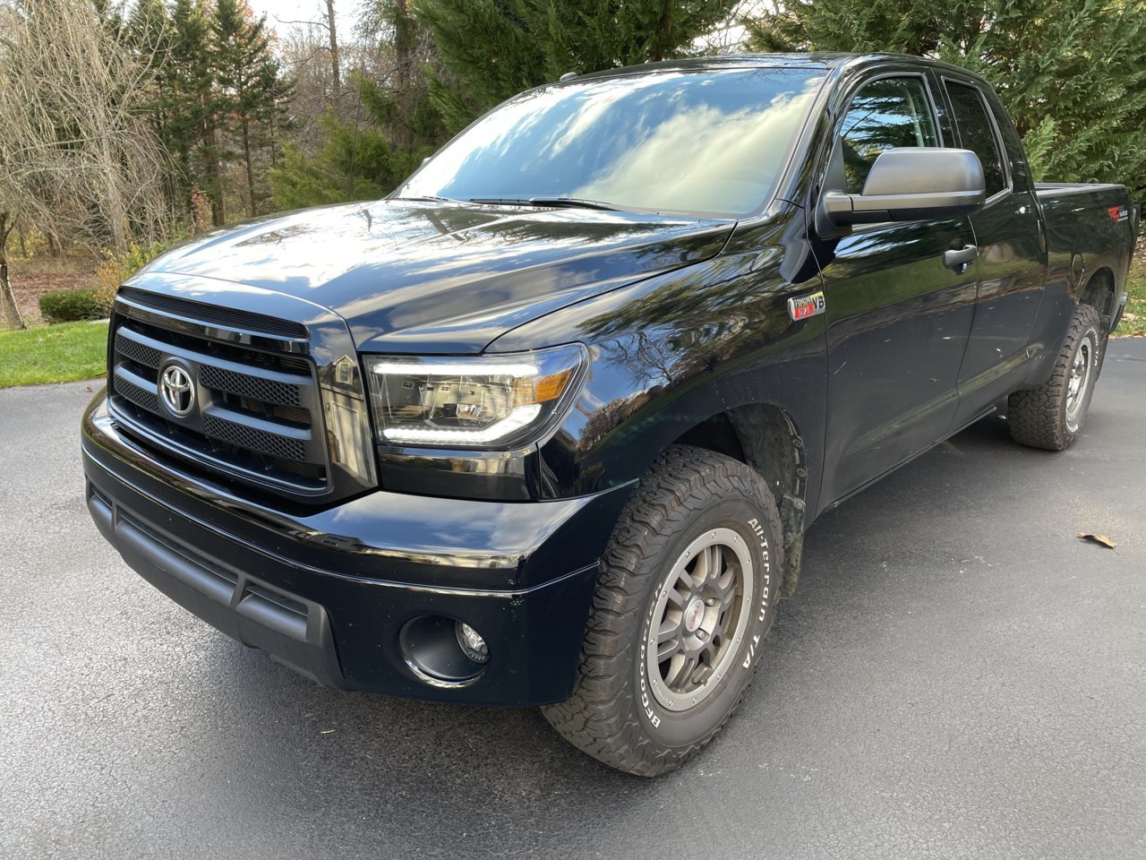

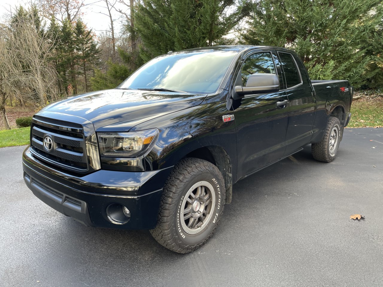

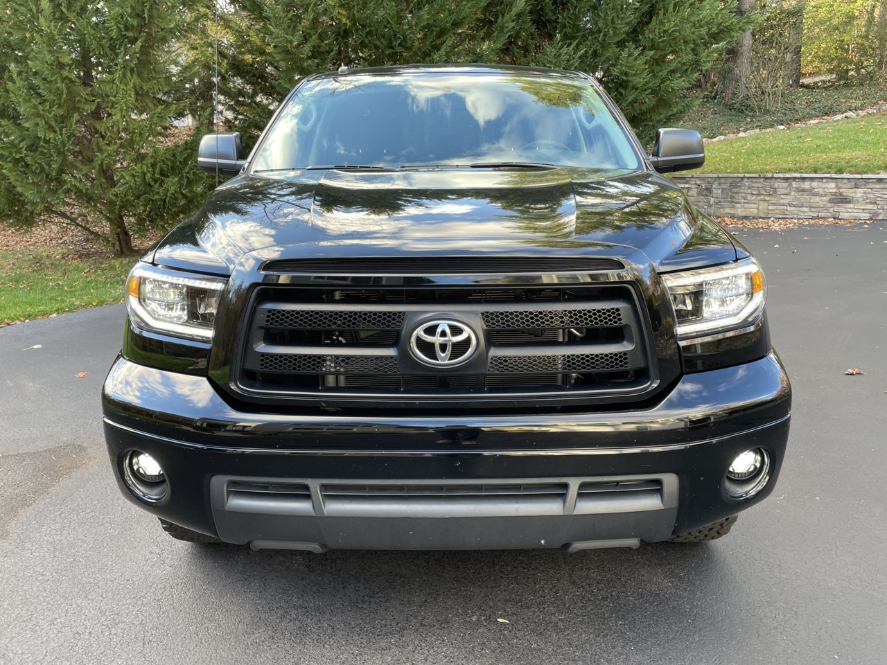

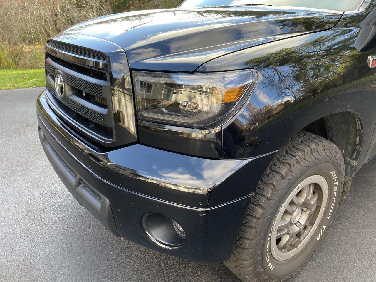

    Posting a few pics of Morimoto XB headlights with white DRLs and wide white 4Banger foglights on a 2011 Rock Warrior Tundra. These are full LED with no conventional bulbs. Installation was fairly simple. Mangled a few of the plastic fasteners on various trim pieces, so have extras on hand if you are doing your own installation. Not so fond of the crossover cable in the front of the engine bay for the DRLs--will cover it in a protective sleeve. Still getting used to the change, but really like the look.

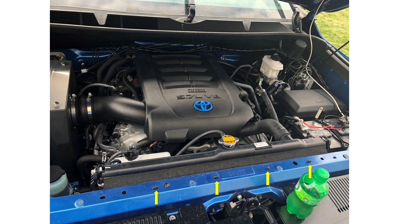

    There is a harness that runs under the top edge of the radiator support. You can pop the clips from the top to push the harness down a little and zip tie your DRL wire to it and then pop it back in the clips. Its up to you if you want to use the wire loom to wrap it first. Harbor Freight has it pretty cheap.

    This is good advice. I ordered some wire loom off of Ebay, and will do just as you suggest. Thank you!
