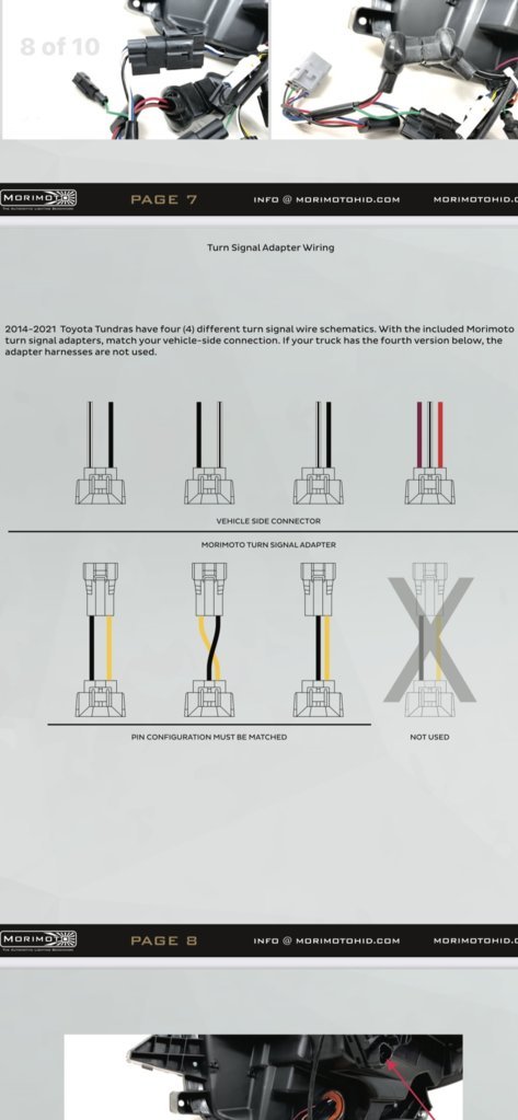

    I installed my lights and scratched my head because the instructions (pg 7) regarding the turn signal cables were clear as mud. Instructions showed 4 adapter styles and one pair was needed depending on the original truck wiring. For my $117 I only received 1 adapter and it did not match my needed type. Since I did not have the needed pair I skipped the adapters and plugged new headlights directly, no adapters. When finished my new headlights worked and turns signals in new headlights also worked, all looked good. I then tried to adjust the lights up and down from the cab rotary switch and they would not move. MORIMOTO support was closed during the holiday break so I troubleshot on my own and found a blown fuse in the cab which also affected my rear turn signals and license plate lights.
    I called support back when they were back off break. The tech looked at page 7 with me and he agreed that I needed a pair of the adapters that were not included. He said I would get a shipping email within a hour of our call disconnect. I waited two weeks and never got an email and no adapters were received. I called support back and got a different technician, he said there were no adapters shipped (I received 1) and blamed Toyota for the problem because a recall had moved a wire in the front turn signals wires. He told me which wires to move and two which position they should needed to be move to, call over.
    First of all I had to take the truck apart again to get at the connectors that needed to be changed, hassle and a risk of scratching my paint. I have a history of upgrading my vehicles, my degree is in electronics, I worked on mainframe computers for IBM for 20 years. I had experience moving wires within connectors but the wires in these connectors did not unlatch like all my previous experiences. After many many searches, I finally stumbled on a video that showed I had to remove a plastic piece then I was able to unlatch the wire and move to needed position. Reassembled and all was now functional.

    INSTRUCTIONS PAGE 7 - ADAPTERS SHOWN DO NOT SHIP.
