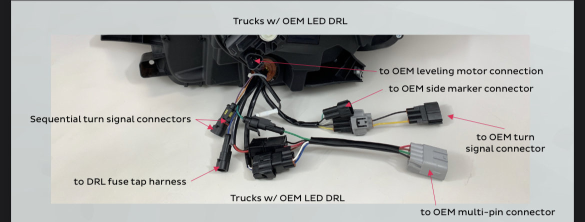

    Just installed the Gen 2 headlights on my 2019 Tundra w/ halogen and LED DRL. Looks bad a$$ but some issues…
    -Turn signals don’t work (head and tail)
    -Hazards don’t work (Looks like my HAZ fuse had blown, changed it and turned on the truck, and it blew again)
    -Hyper flash *sound* inside cabin is occurring (this is probably because I just changed the license plate/vanity/3rd brake light to LEDs) last week
    Any assistance would be helpful. I installed it exactly like in the pic below. Fuse tap (came with 2 10A) is in IGN. Headlight sequence is standard (connected wires).

    Hyperflash will only be caused by turn signal bulbs. Brake and license plate lights won't cause that. Check all fuses underbthe dash and in the engine compartment to start with. Are both fuses on the Fusetap 10 amp?

    Fuse tap came with 2 10A fuses. Regarding the hyper flash, below is what is on the morimoto website so that’s why I was thinking it was the LEDs.. “IMPORTANT: If your vehicle is equipped with anything but OEM turn signals (full assemblies, LED bulbs, or otherwise) in the tail lights or elsewhere: You may experience a hyper flash and/or problem with the sequential signal setting on these headlights. This is not a defect in the headlight, and caused by un-matched impedance with your original vehicle settings.

    I had to get the relay/circuit board from Headlight Revolution for my 2016, if that helps you.
