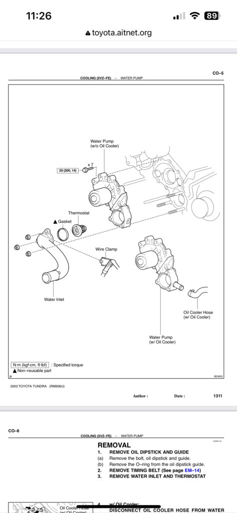

    @shifty` i do have one question before I get started. Could you by chance tell me if the 2003 Tundra V6 engine came with an oil cooler from the factory? I’m trying to see if the original owner bypassed it. When I pulled the water pump there was a bypass for the oil cooler, same as the one I bought here. But the PO had it welded shut and plugged. I’m wondering if he “deleted” an oil cooler.

    Looks like it’s 50/50

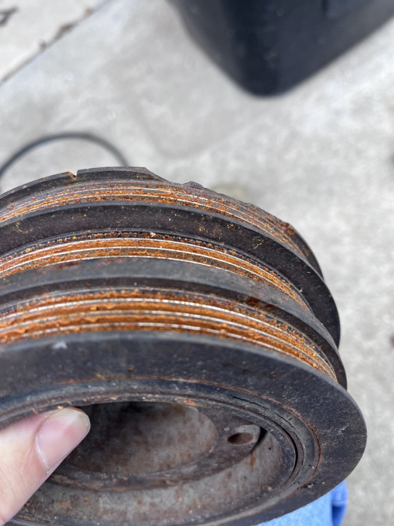

    Finished the timing belt today. Drove 100+ miles on it and everything is checking out nicely! No issues at all to report. New radiator, and all above parts mentioned. Sending unit did not fix my oil pressure gauge but I’m not toooooo terribly concerned about the “idiot gauge”.
    here’s the break in the balancer. It got rusty from all the rain we got in Indiana after the hurricane; because we left it in our “scrap pile”.

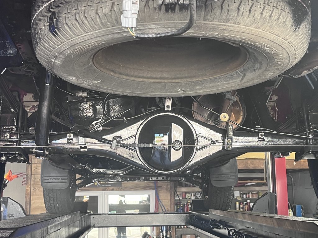

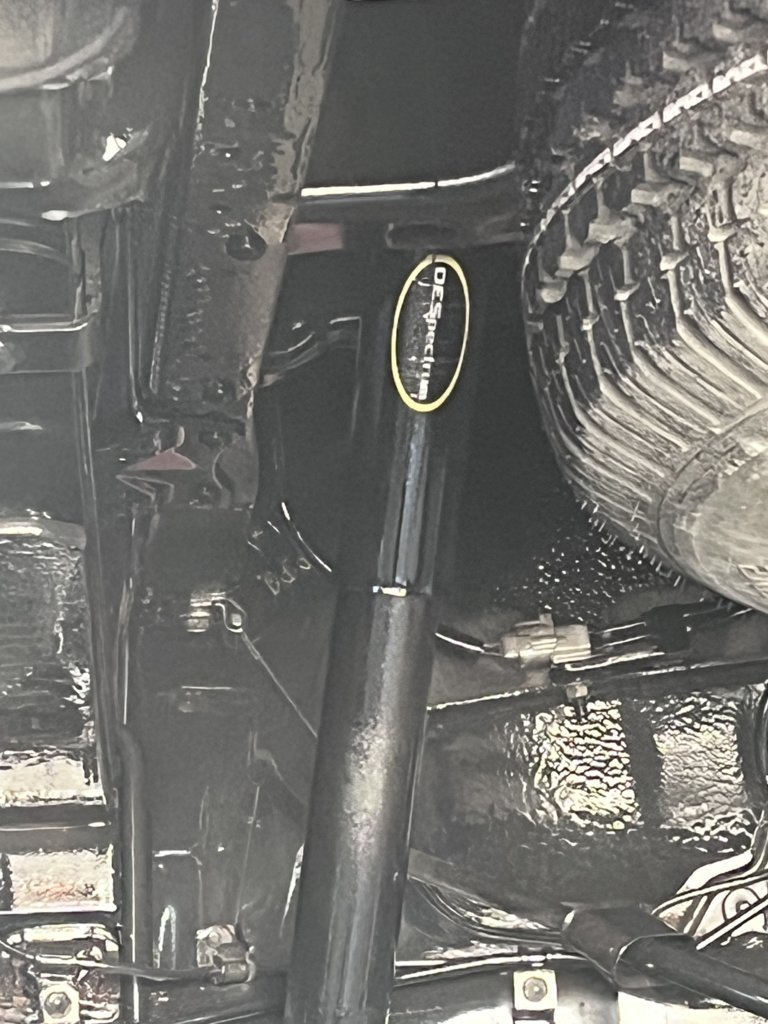

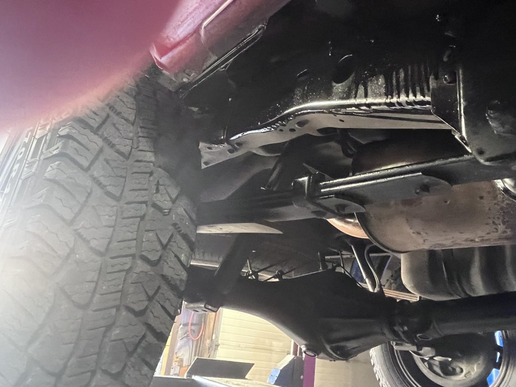

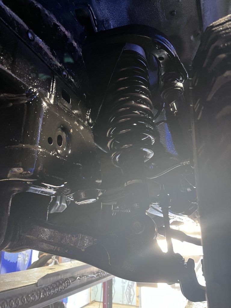

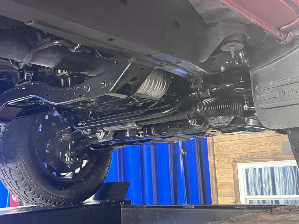

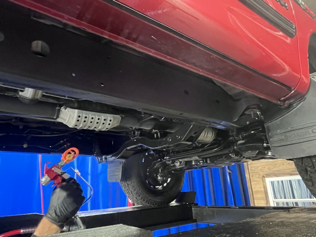

    Pics will deffo help.
    Specifically, pics of the rear axles where the leaf springs are u-bolted, and pics of the front struts (to see if there's a spacer at the top of the spring) at top and the lower mount (only one is necessary)

    Got the truck up on a lift today and treated with Krown. Here’s some more photos of the undercarriage. IMG_3031.jpg IMG_3031.jpg

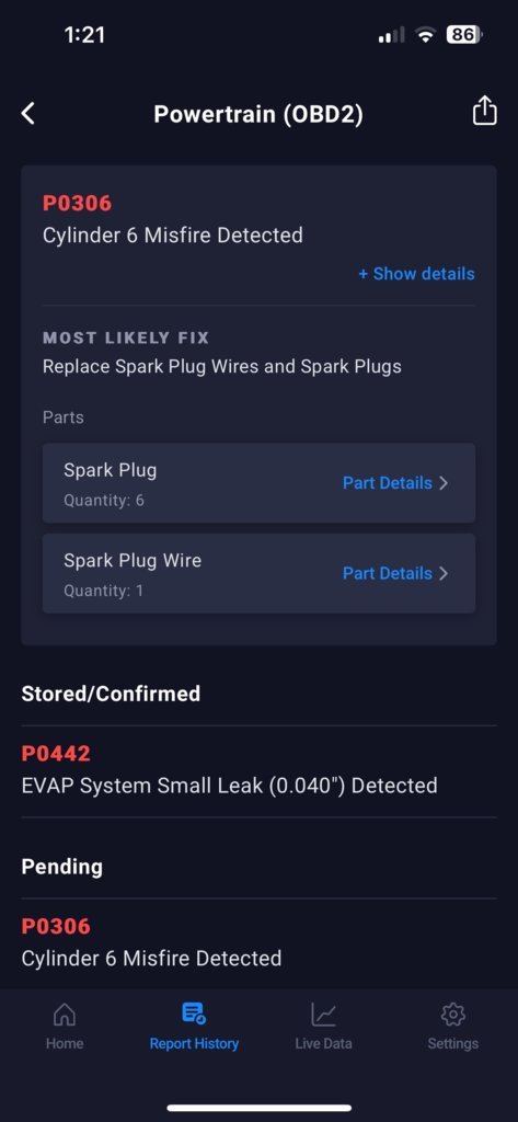

    @shifty` So, got the steering wheel off today. When I went in there I tried the dielectric grease like you mentioned first but I had my doubts. There was a 19mm hole through the clock spring. Upon further investigation, turns out someone had replaced the steering wheel with a Sequoia or Tundra wheel from 01. So me thinks when it was pulled from the old car, or pulled off originally to be replaced someone wayyyyy over torqued the puller and punched a hole through the clock spring. The manufacturing stickers were still on the inside. Luckily I had already bought a new clock spring in the event I did need it with the intention of returning if not. So I popped the new one in and greased it up. Took my AC compressor to it and blew out maybe 15 years of cigarette dust, and then re-assembled the wheel. Someone must have been horny in my driveway because they were honking like crazy! WFH today so I'll take her on a spin during lunch and test out the cruise.

    I presume you just found the issue and got it resolved. Good on ya!

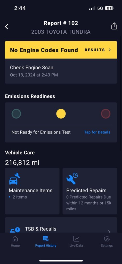

    Unsure of all modifications, bought used. I know a leveling kit has been installed, the body has been repainted, and some of an interior LED conversion has been done
    The saga continues! Got in the truck today to get ready for a deer trip this weekend and something felt off when idling... So I turned it off and pulled the trigger on an ODB2 reader (the ones that send the data to your phones)
    After reading the codes - misfire - cylinder 6. Recommend replacing spark plugs.
    NGK Iridium plugs for $9 a pop. Went and pulled the plugs from my local parts store and replaced them. The wires and coil packs looked to be in good order. I'll know more later. I'll probably end up shooting myself in the foot later. Oh well, thankfully if they do burn out because of the coil packs or wires the parts store has a warranty on the plugs. They all looked great to me. I'll upload what my plugs looked like that I pulled out of the engine. (20 gauge slug for scale LOL) and some of the trash I still haven't pulled outta my truck. The yellow is due to a failure of a smog test. There is some EVAP codes due to the tiny exhaust leak mentioned earlier. Image (3).jpg Image (4).jpgImage (2).jpg
    G_unit3000, FiatRunner and shifty` like this.

    Can't go wrong with new plugs...however next time swap the #6 coil and plug with another to see if the misfire follows the swap
    G_unit3000 likes this.

    That frame looks pristine considering it’s from Indiana. What’s it coated with there?
    Looks like the outside frame rails were painted with the same paint used for the exhaust.

    It looks like it may be wool wax or fluid film
