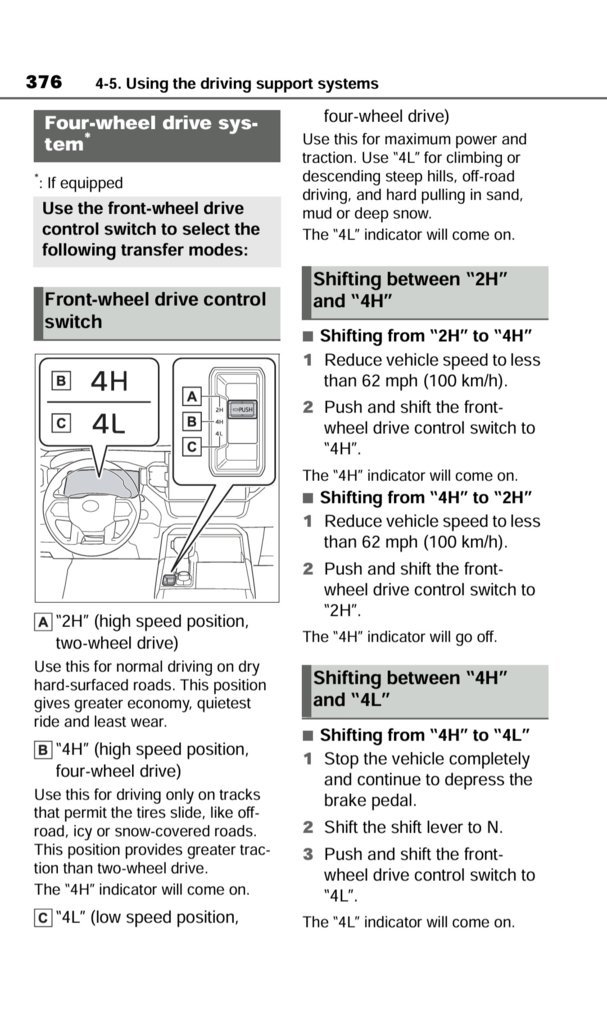

    :facepalm:Read your owners manual. It's all in there!
    Screenshot_20241111_192922_Adobe Acrobat.jpg Screenshot_20241111_192932_Adobe Acrobat.jpg

    Yes lol. See, very inexperienced lol
    It’s funny that I did what the manual said and it wouldn’t shift out of 4L. It just kept flashing at me until I let off the brake and let the vehicle roll a little. So I guess the manual is a little wrong…?
