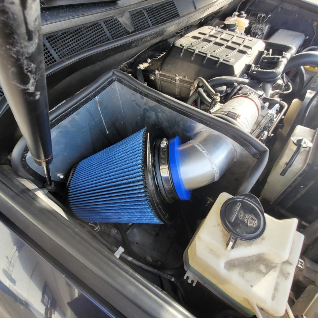

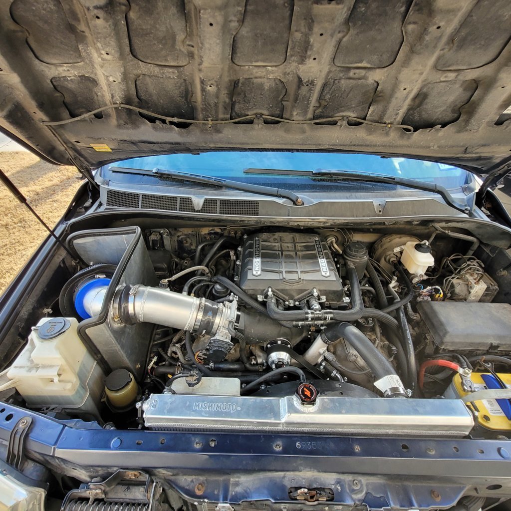

    I have a 2008 tundra magnusson 2650 supercharged, lc200 transfer case (full time awd), grip pro lsd, mechman 370 amp alternator, lexus is250 steering wheel w/ paddle shifters, and mishimoto radiator. I recently added dw650 injectors, aeromotive 325 fuel pump, rcf throttle body, 4in intake, ipt valve body, stainless works long tube headers, and trd sway bars front and rear. While going into tuning the ecu must have been locked up and needed replaced. I had a local trusted shop do the installs and tuning. Anyhoo, since getting the truck back I've put close to 3000 miles and have not been able to get evap or o2 monitoring to complete.
    I've started the process of throwing parts at it to see what sticks. I did the purge valve first and recently the evap canister and fuel cap. I have o2 sensors coming that will be put on this weekend. In the meantime I have no CEL and no codes. The truck starts rough about 50% of the time taking several seconds before it starts up. Other than that it runs and drives great! I have tried with and without the prospeed fuel pump control module jumper and still get the same rough start intermittently.
    My question(s), does anyone have any advice on why the truck might have a rough start? Any advice on getting evap and o2 monitors to complete?

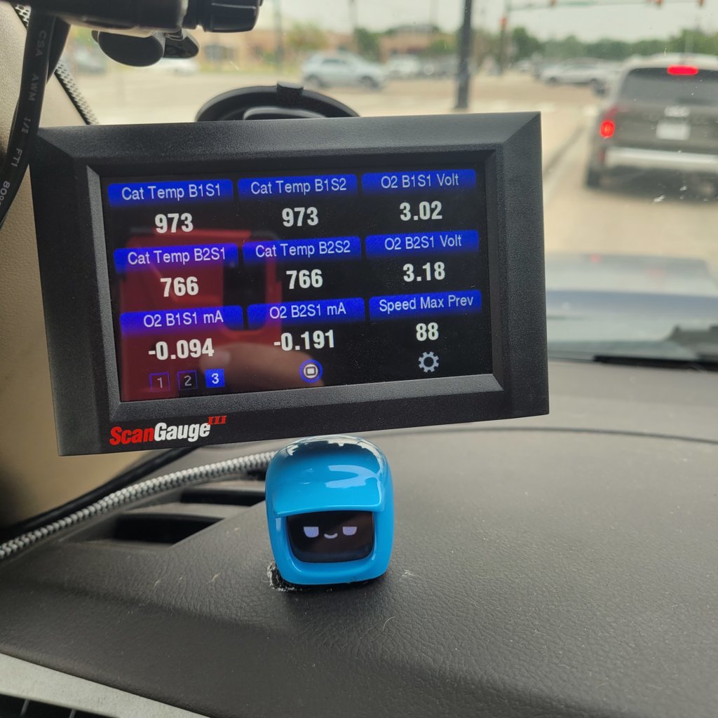

    So I have a scan Guage hooked up and was looking at different parameters and I noticed bank 1 (both sensors) were on average 200 F hotter than bank 2 (both sensors). I think this rules out bad o2 sensor but may be pointing to a larger issue since the exhaust is new and recently tuned with the other mods. I'm taking it back to the shop next week to have them verify everything and hopefully get this fixed so the monitors will complete. We shall see.

    Not to distracting you from your findings or the troubleshooting you are undertaking.
    To my knowledge the stock O2s are narrow bands so whatever scangauge is providing is derived.
    Same for Cat temps, Tundra doesn't have a cat temp sensor so it is likely derived from other PIDs that scangauge is tapping.

    20250418_125612.jpg Thanks for the info. Makes me wonder how accurate they are... might be leading me in the wrong direction. This is what I was seeing.
