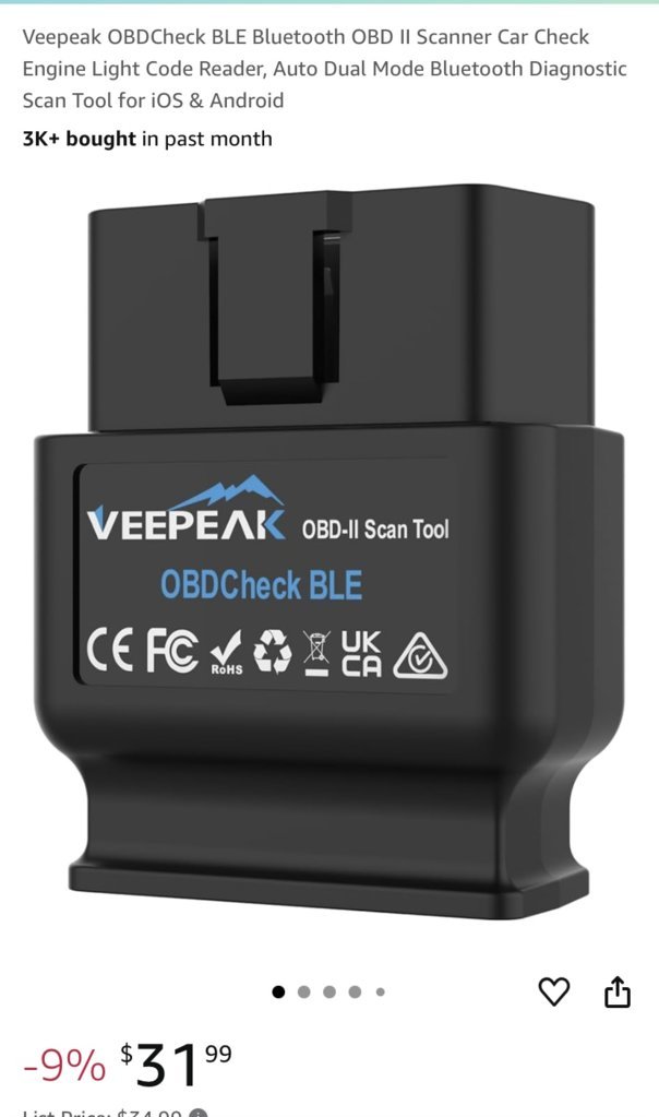

    Robster80 [OP] New Member
    Oct 8, 2018
    #20293
    393
    This one?
  12. May 2, 2025 at 6:04 AM
    Tundra234
    Tundra234 New Member
    Nov 30, 2018
    #22402
    18,028
    George
    Florida
    2020 Tundra DC SR5 Barcelona
    Alot of them
    Yes
  13. May 2, 2025 at 6:44 AM
    BrandonL812
    BrandonL812 New Member
    Aug 5, 2018
    #17783
    1,465
    Brandon
    2021 Tundra Platinum
    DD ss3 max led fogs. interior and exterior leds swapTRD Shift knob.
    Veekeak obd2 is totally worth it. Did drain and fill on 2 trucks and it went awesome. No paper clip method and shifting from N to D and back and forth. Just watch your phone for temp to rise, drain level bolt. Wait, torque back. Ready to go.
