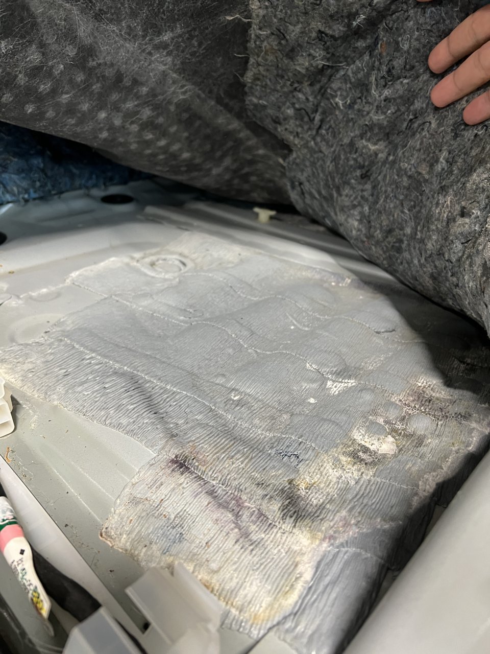

    Here I am waiting for my engine to throw a bearing and this happens. I think I would of almost preferred the engine to go?
    I’ll try to keep this as straightforward as possible with the important information.
    Welcome to THE shit show.
    Vehicle info/details
    • Build date Jan 2022
    • Took delivery Feb 2022
    • 100% stock
    • 17 months of ownership & 20,777 miles
    • Noticed a mildew smell that comes and goes, around 3,500-4,500 miles
    • Never noticed any sitting water or visible leaks
    • I clean the inside of my vehicle regularly.
    • Finally, most recently doing an interior cleaning, when I pulled my drivers side floor mat, the carpet was saturated and signs of white mold growing between the carpet and rubber mat. Smell was unbearable.
    • This was all the tip of the iceberg.

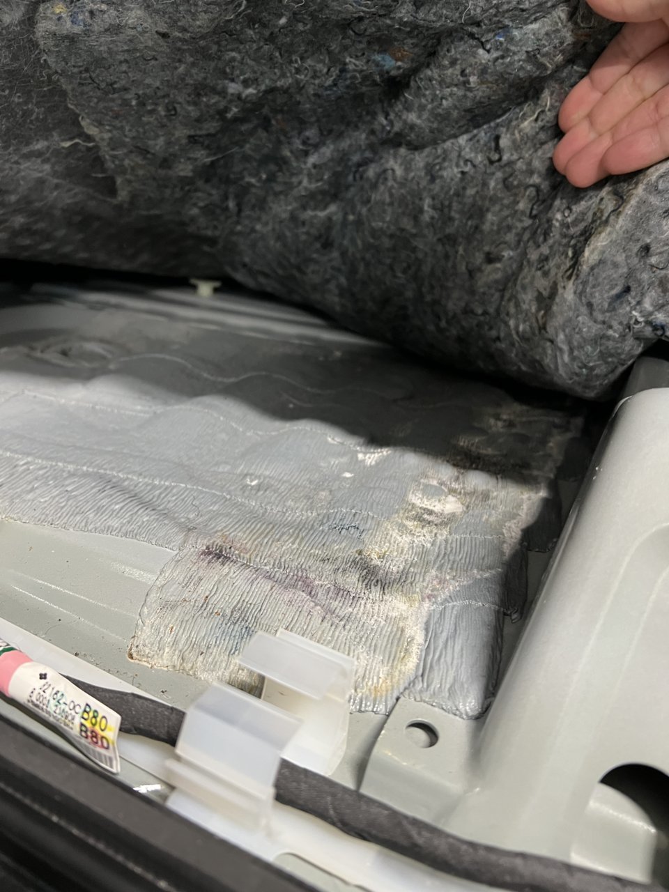

    • Brought to dealership, they’ve seen this before. Water intrusion from a faulty body plug/seam sealer in floorboard.
    • Master tech was able to confirm by blowing compressed air and water from underneath.
    • I live in the snow belt, so likely slushy/melt snow, salty, rain water has been slowly making its way in.
    • This Monday(3rd), will be 3 weeks no truck.
    • Currently in a Sienna as a loaner. Oddly enough Toyota corp reached out to me stating them or the dealer isn’t required to give me a loaner(poke the bear?)

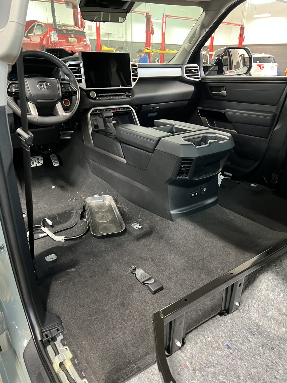

    • Plan of attack, entire interior will be removed(everything)
    • Serv Pro for mold remediation
    • Porous interior pieces replaced, hard plastics cleaned
    • Asphalt sound deadener, which is covering the leak will need to be scraped up and removed, and replaced.
    I highly encourage anyone having a weird musty, mildew smell check their carpet for dampness. Or you can very easily pop the plastic door sills off and get a hand under the pad, under the carpet to check. I’d check everywhere, as the dealer has seen this on passenger side as well.

    More photos.

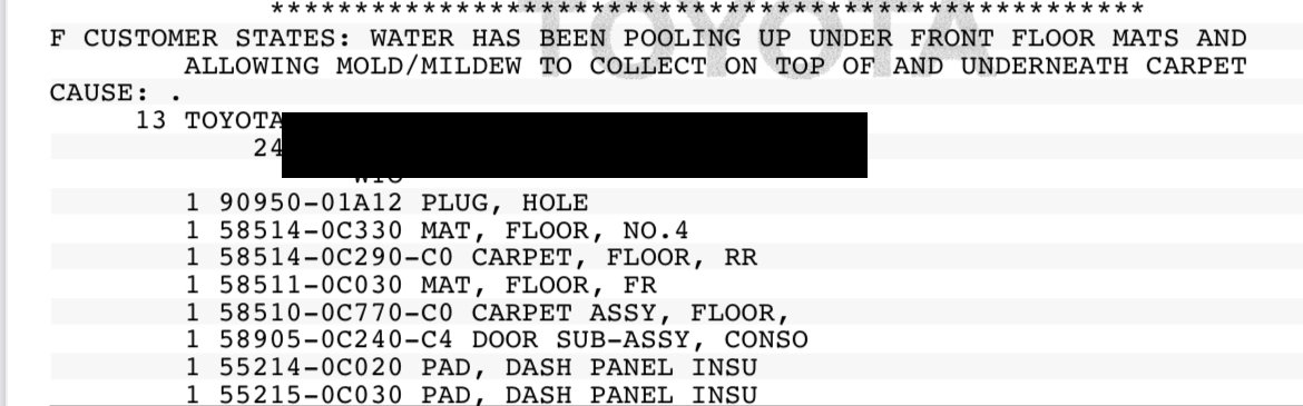

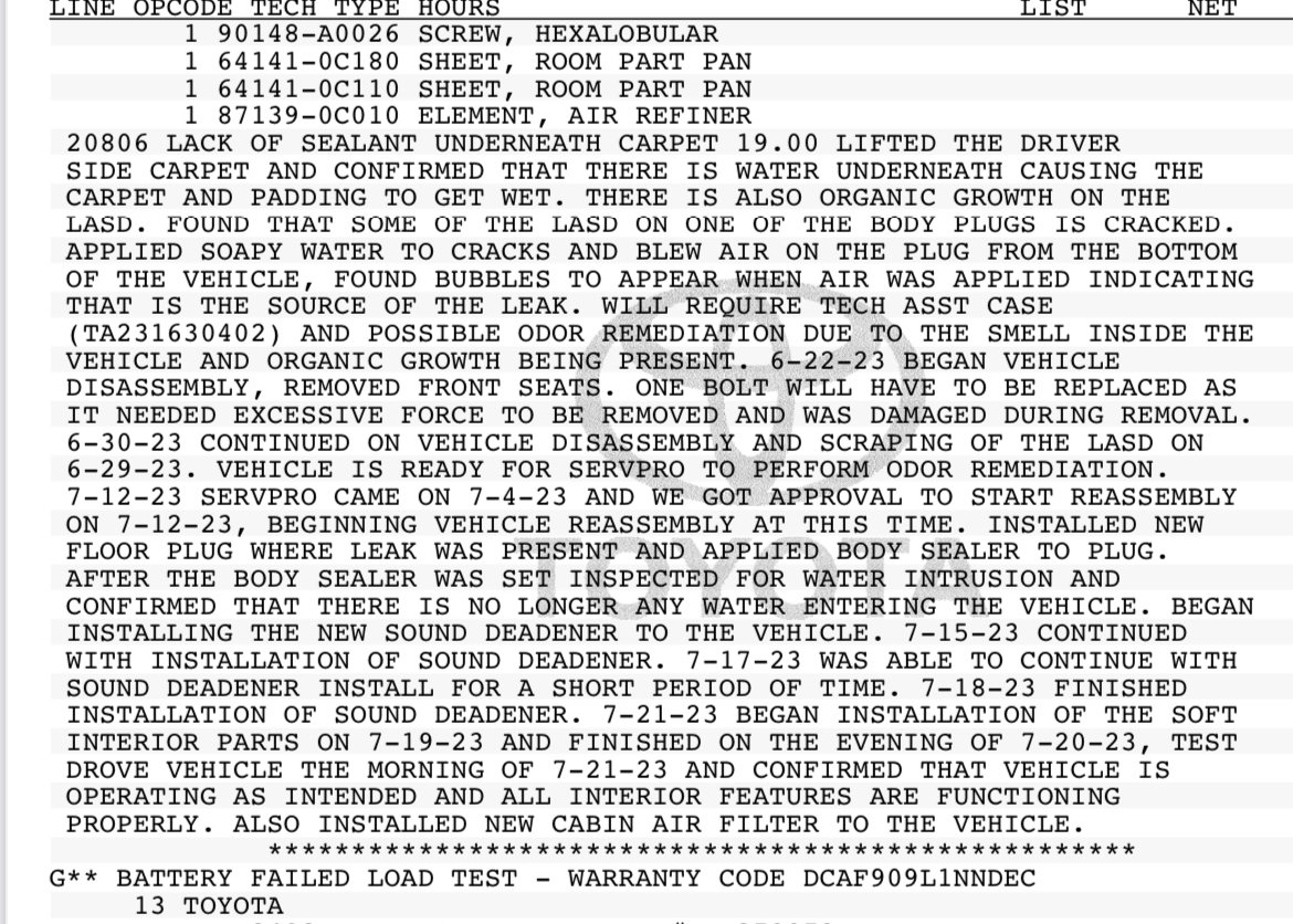

    Update — After 6 weeks without my truck I picked it up earlier this week. With the entire interior being removed, ServPro for mold remediation, repair and reinstall of the interior; I’ve been dreading the worst to say the least.
    Long term verdict is still out on my contentment of the repair. Hopefully, I can be 100% as we spend a lot of money for these trucks, here’s what I’ve noticed and brought to the dealer’s attention.

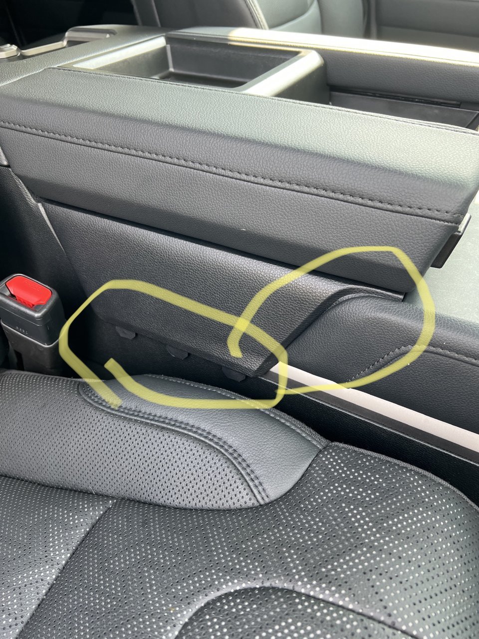

    —Couple interior pieces weren’t fully snapped/adjusted into place, which I was able to address myself.
    —Gray headliner, has some specs/blotches(not finger prints) of grease and or dirt. I’m assuming this is from hanging around outside the truck in a shop environment for weeks. It was bound to collect something. Quite frankly, I’m surprised Toyota wouldn’t just replace it due to it being soft and porous(good place for mold spores to collect?)
    —Overall I do appreciate the thoroughness of the Toyota master techs work/notes. My battery was also replaced under warranty, as I’m sure it was constantly being under load with the doors open and not being started, that didn’t surprise me at all.
